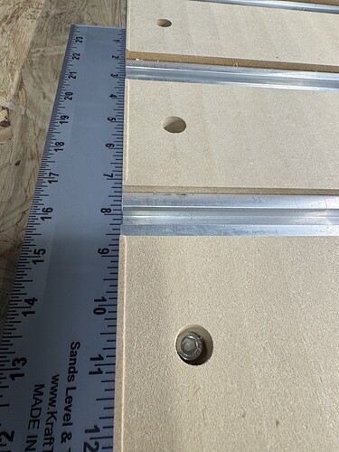

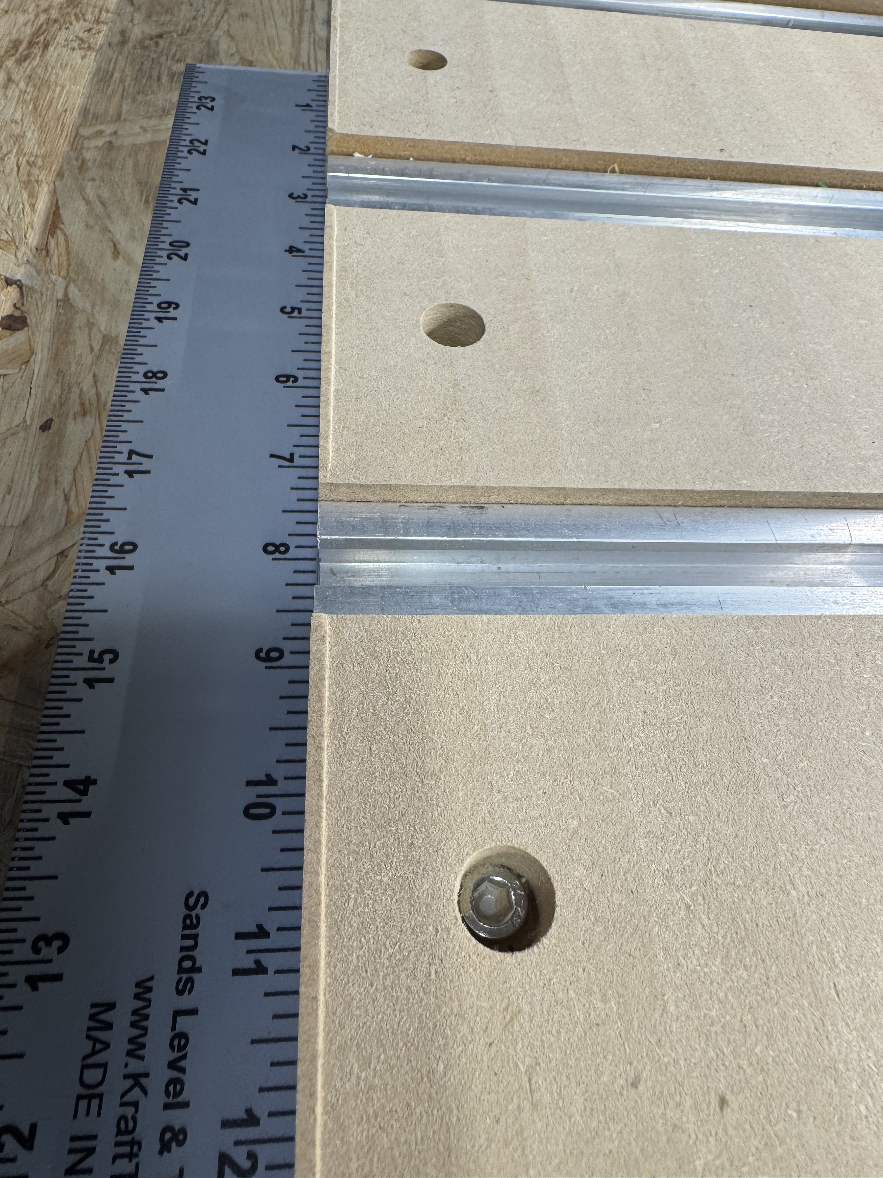

i tried flattening my waste board on my Shapeoko 5 pro -4x2 using the facing tool path
i have set the Y axis as far as it will go , and when i start the file it starts about 1/8" from the edge(see pictures)
i cant get the Y AXIS to go any further to zero out ,i tried recentering it

It surfaces it and the x axis fine. but not the y axis, there is still a good 1/8” off from front that it does not surface

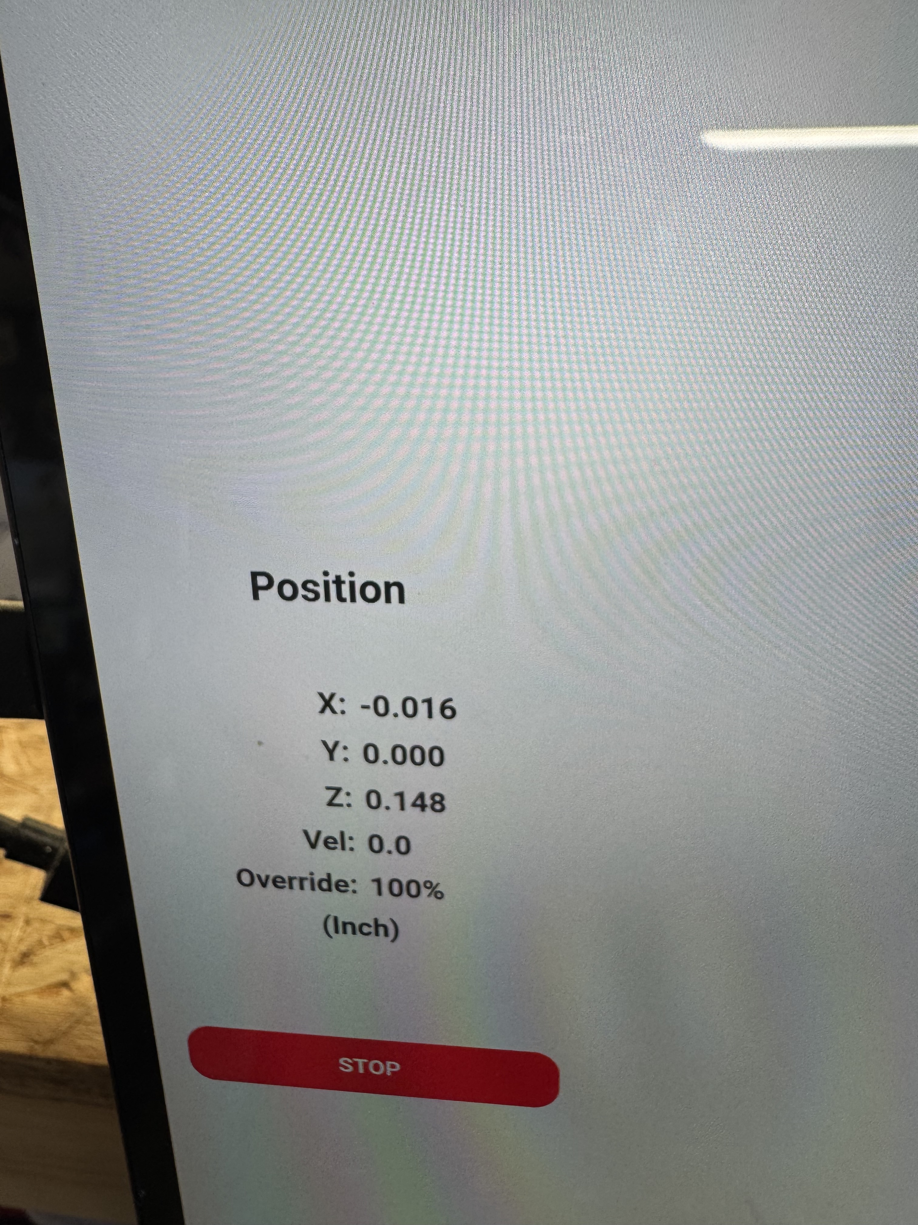

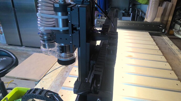

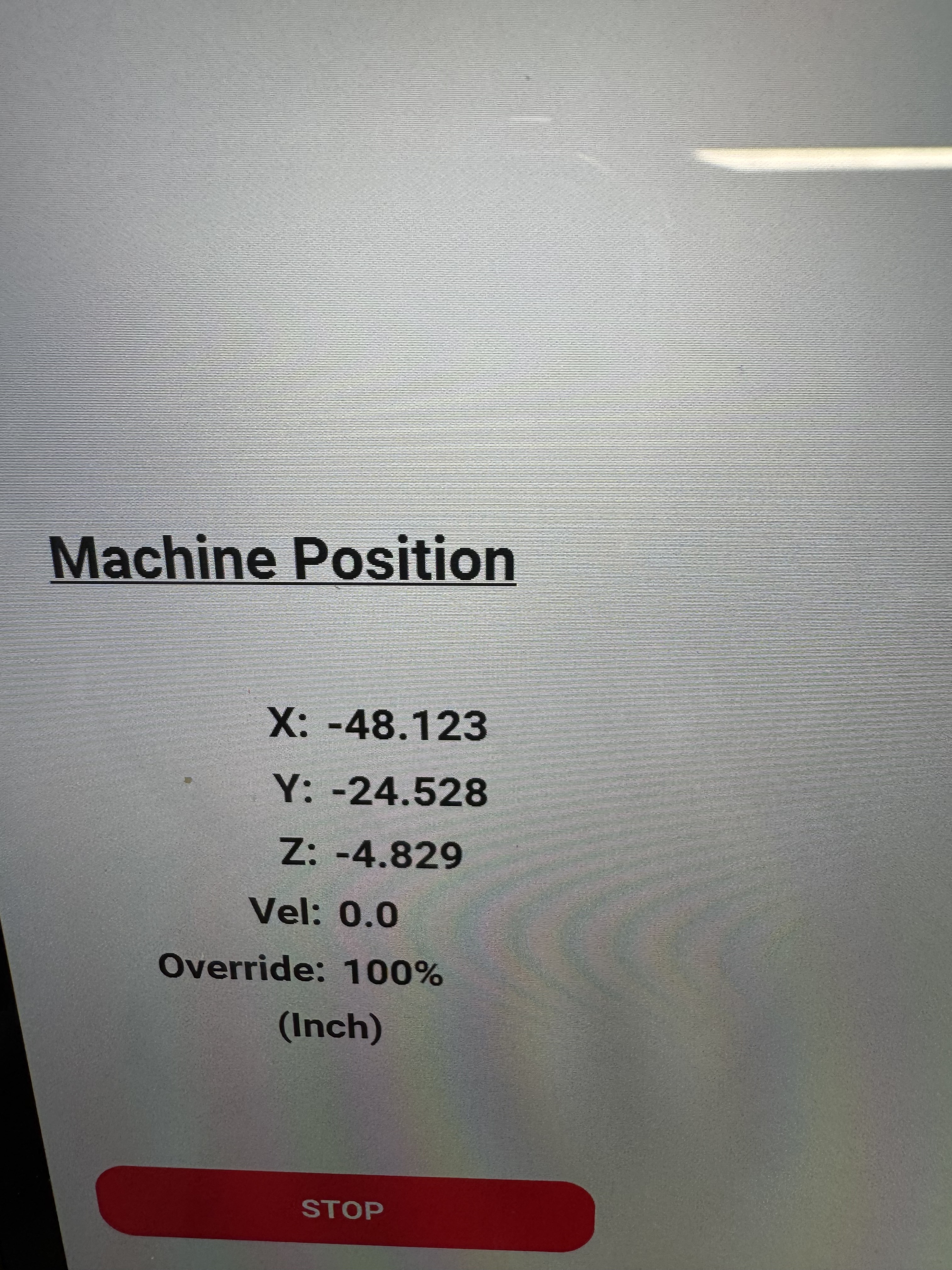

Photo showing the machine at the zero position and screen grabs showing what Carbide Motion shows for Position and Machine Position? (click to toggle)
Here is picture of the Y axis as far as it will go, there is about 1/8” that did not get cut (see pic)
Also position and machine position [quote=“WillAdams, post:4, topic:99660, full:true”]
