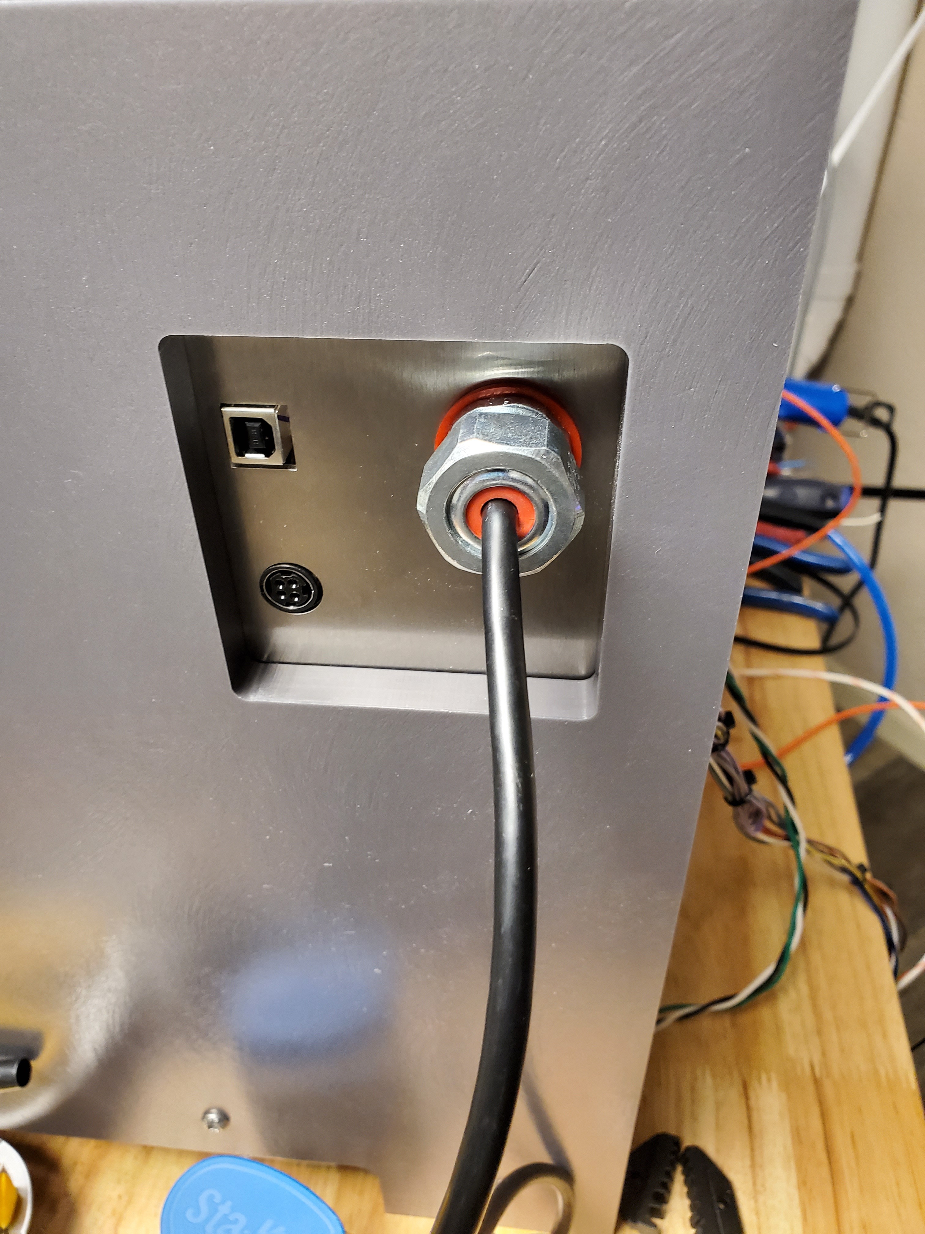

I would like to find out what the pinout is on the board for this connector. I’m sure it is fed 24v, 0v, 5v pwm. But I would really like a diagram that tell what each is. If pin 5 is 5v, is pin 6 another 0v from the 5v ps?

I tried searching online I was not having any luck but @TonyDangerCoiro got me over my issue I was having. See I was under the impression that low voltage circuits and higher voltage needed to be separated but in fact it was creating the loop that allowed the pwm to correctly control the speed. But still knowing what’s a Hangouts are would help someone in a future build. Like now since I know that there is 24 volt * 0 I’m going to use that to trigger my power supply on and off with the machine so I only have to hit one power button.

On the original subject, did you figure out the pinout of the McGillicutty board @DEDynamics?
I’m considering using a new controller and if I do I’ll need to figure out how to wire the spindle.
4 is 24v, 3 is 0, 5 is 5v… Only ones I use. Think 2 is reset
Ah, are you just using it for power for your spindle? How do you control your spindle speed? Is there a PWM output or something somewhere?
I only use the 5v n the 0. The 5v is the pwm.
