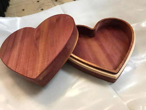

I just created a square vector in CC. I was actually following the instructions here:
I was so early into the project that I ended up just importing a heart vector and going from there.
