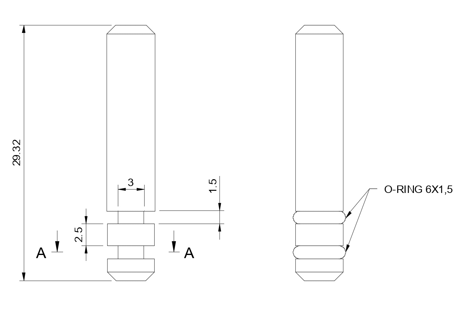

Gents, I have no experience turning anything, and I rather ask before I get myself into some trouble with the S3. I was thinking how to get a D6 x 30mm Al rod into a D5.5 x 30 rod with two tiny grooves on the side of the cylinder.
Option one is to mill it to the required diameter and than mill the grooves with a T-slot cutter. Option two is mill turning the whole thing but I am concerned about the high RPM of the Makita router and also my lack of experience.
I would appreciate any suggestion on both option concerning that I have to make 100 of these tiny parts without a lathe. I can grind a HSS form tool or I can invest in the appropriate T-slot cutter.

Sorry for not being clear enough. I ment grooves around the side not along - not like a keyway. Paralel to the top/bottom of the cylinder.
Yes, I caught that — I meant to add that you’d need to use a ball or theadmilling endmill or other endmill capable of the undercut.
You want to put flats on the side? Sorry, trying to follow what you’re describing, do you have a model or picture? Making 5.5mm x 30mm rod from 6mm round stock isn’t going to be easy without a lathe, but there’s one person on here that might know if/how it can be done @RichCournoyer is who I would ask. Or try to buy 5.5mm round stock as @WillAdams suggests.

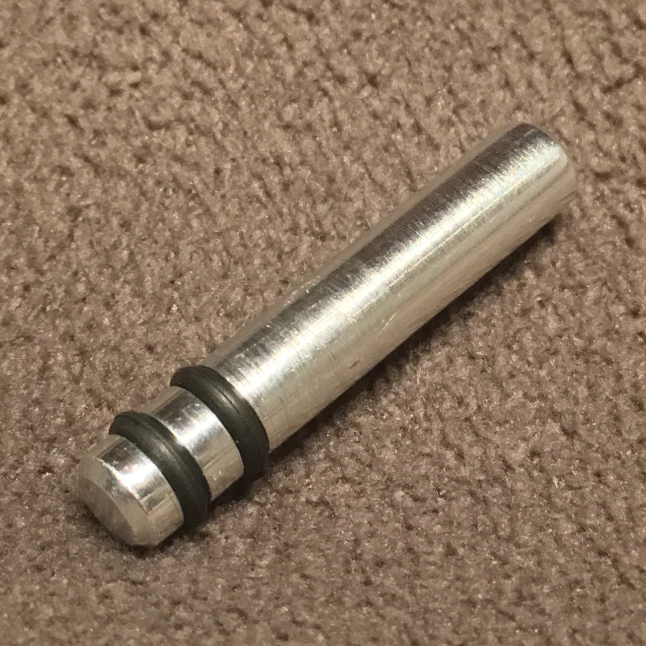

My best idea was to make a pallet with a bunch of 6mm and 5.5mm holes to accommodate a lot of these than mill it to the desired OD, chamfer and undercut. Than flip it to the 5.5mm hole and mil the OD and chamfer.
Any concerns?
I have to be honest. I would have rather machined the whole thing but I gave it a shot fallowing your recommendations and come out really nice. Furthermore it works as it planned. Fits the reamed 5,75 airtight. I’ll test it under pressure ASAP.
Thanks again for the help!
