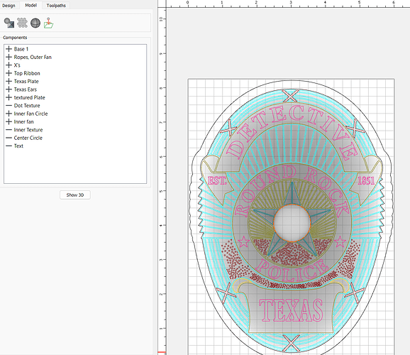

So I created a 3d model for the police badge that looks fantastic. Yeah me… I ran the toolpath rough and toolpath finish through the sim. Looks like dodo. So my thought is to create individual toolpaths per layer. Where can I see the defined data, i.e. depth of each component, that I created using the model tab?

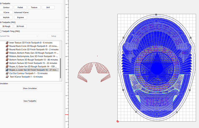

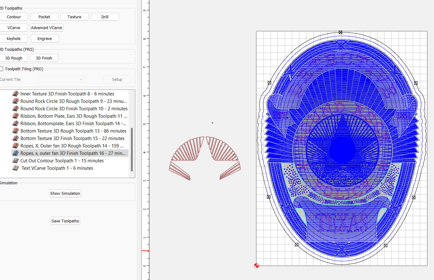

Tod my first go at the toolpath was trying to do it all in one go. I ran the sim at least a dozen times trying every tool and tool combination I have in the library. They all looked like dodo, meaning really bad. By cutting by layers with various tools this is where I’m at right now. Overall time is not to bad either. Not sure why I’m getting the small stick ups though. With this run I am using all stock settings. Plan to tweak those a bit.

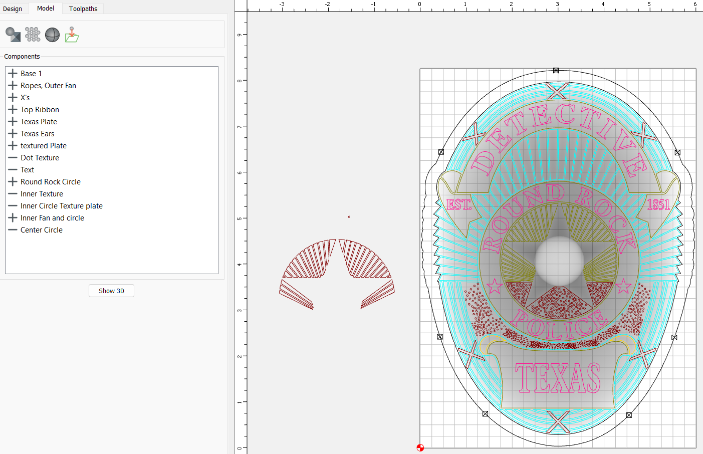

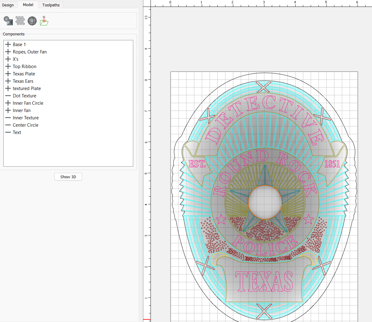

I think this is what your asking for?
or
For tool paths the above image included everything. I started at the Top of model and worked my down incrementally as it made sense using the layers I created as a guide. The last tool path being the cut out.

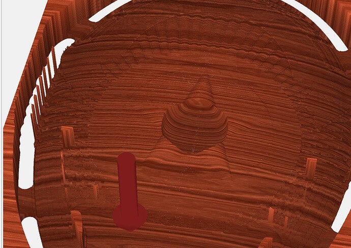

Now that I look at it in this view, the stickup along the sides are probably left because i used a 1/4" endmill which won’t fit into those tight corners of the fan. The others kinda have me stumped though, as each of those areas were milled in previous passes.
Here is a better view
