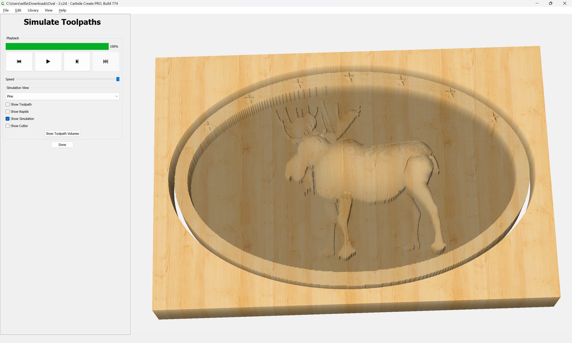

I’ve spent the past several days doing a crash course in CC Pro Model courtesy of a tutorial shared by Will. My immediate goal is to create a relief image of a moose (a real one) based on a very shadowy picture of - you guessed it - a real moose. Unfortunately, the moose was in the shadows when the picture was taken, so no prayer of getting gray tones for 3D.

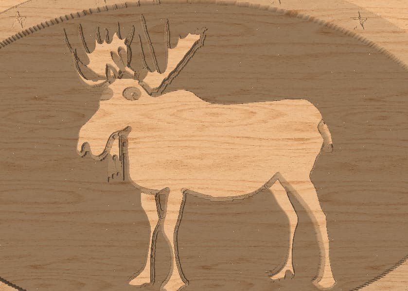

Intent is to put the moose in an oval frame roughly 9 x 14, all carved from one piece of wood about 2" thick. After looking at Model Show 3D ( being at least somewhat satisfied with what I saw) for countless hours, I decided to take a break and see what the results looked like in the Toolpaths Show Simulation. Eeeek! Aside from the fact that if I use a 1/8 end mill for the Rough Cut it will take something like 17 hours, and use a 1/16" taper (simulating a 1/16" ball nose) for the Finish, the Simulation looks like crap. And "Yes, system is set to High Res Simulation.
I’m attaching the PNG screenshots from both the Model and Toolpaths.

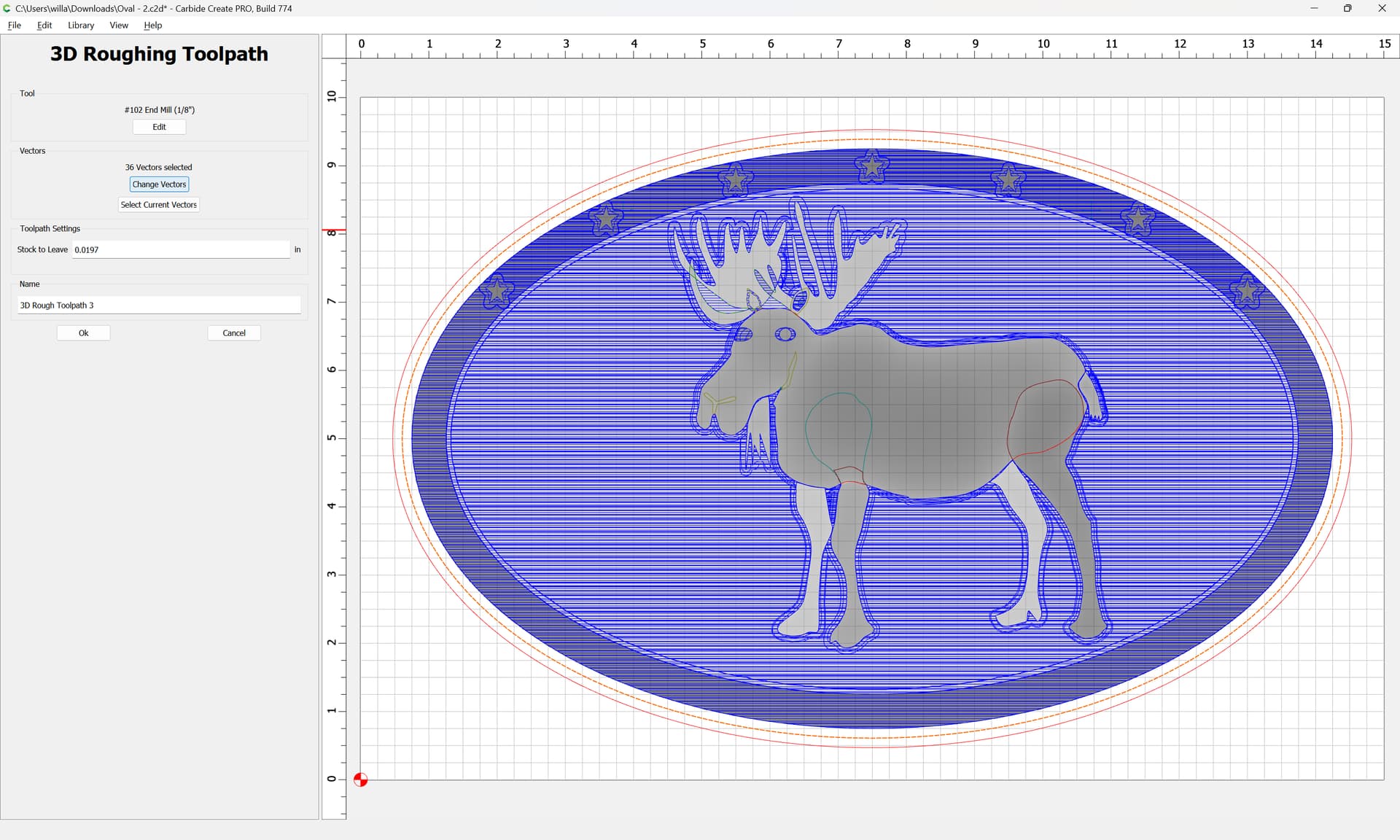

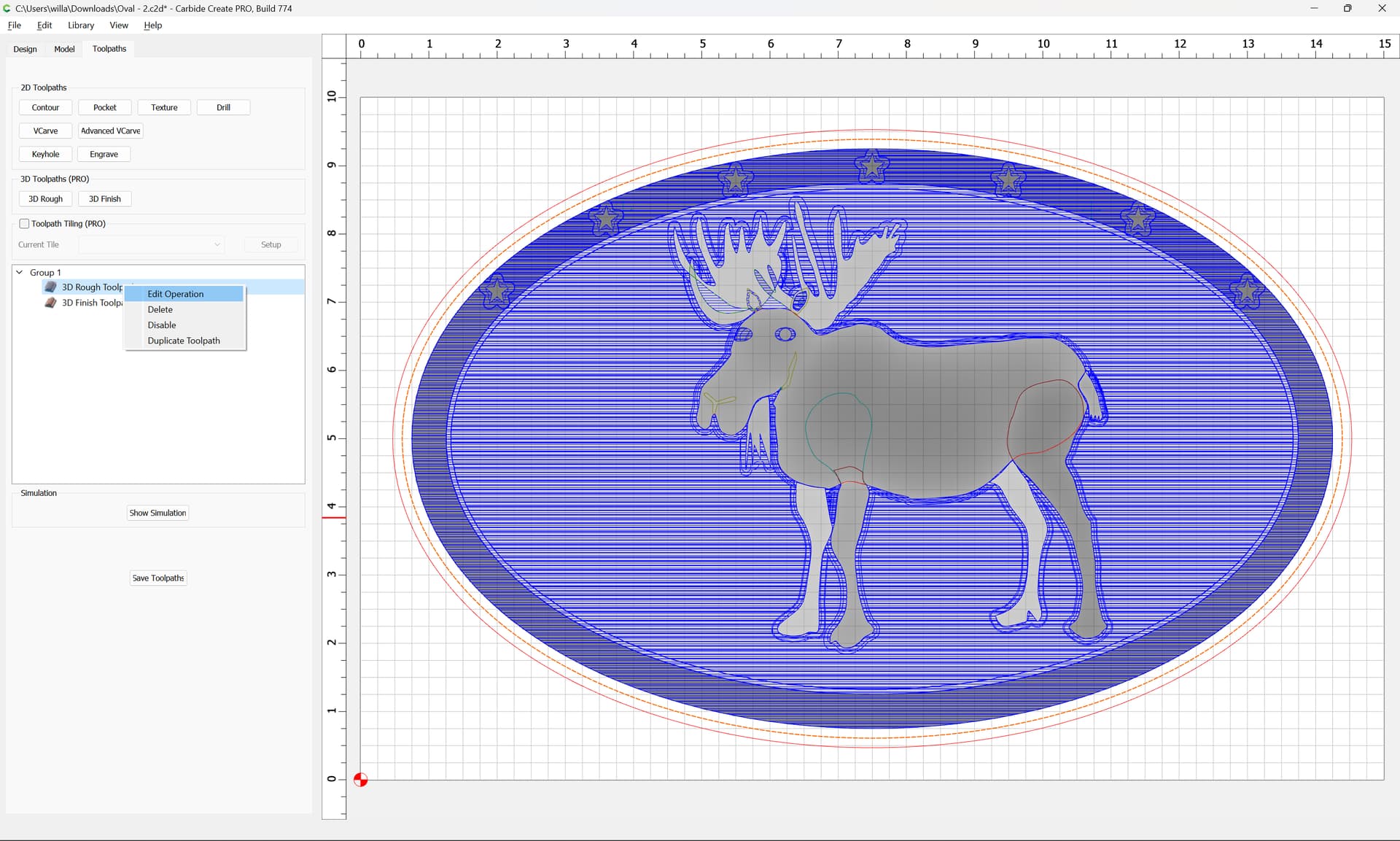

You selected all the vectors for your 3D paths. Only select the outermost, oval vector.
The vector in a 3D path is the boundary. In this case you want to cut the whole thing.

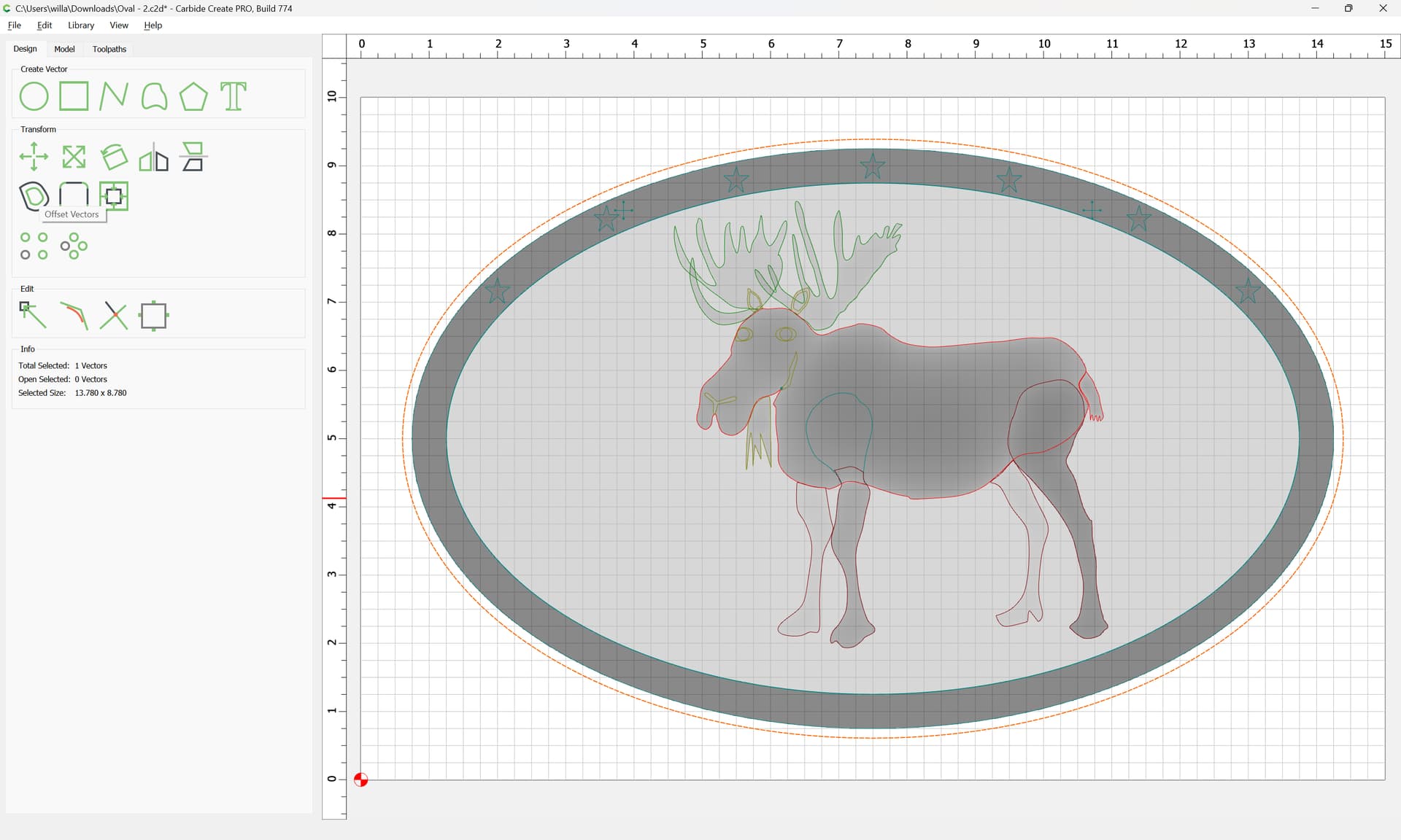

Arguably, it would be better to select the outer geometry:
Offset it to the outside by the raidii +10% or so of the tools being used (so multiple times):
Apply
and then edit the Toolpath:
Change Vectors
Use Current Selection
Ok

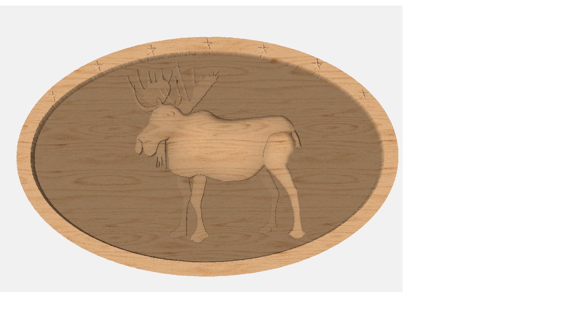

Repeat for the 3D Finish Toolpath, and it more closely matches the 3D model:
Thanks to both of you. Doubtful that I’ll get to work on this anymore before Sunday. Sounds like simple solution which is perfect for me.
