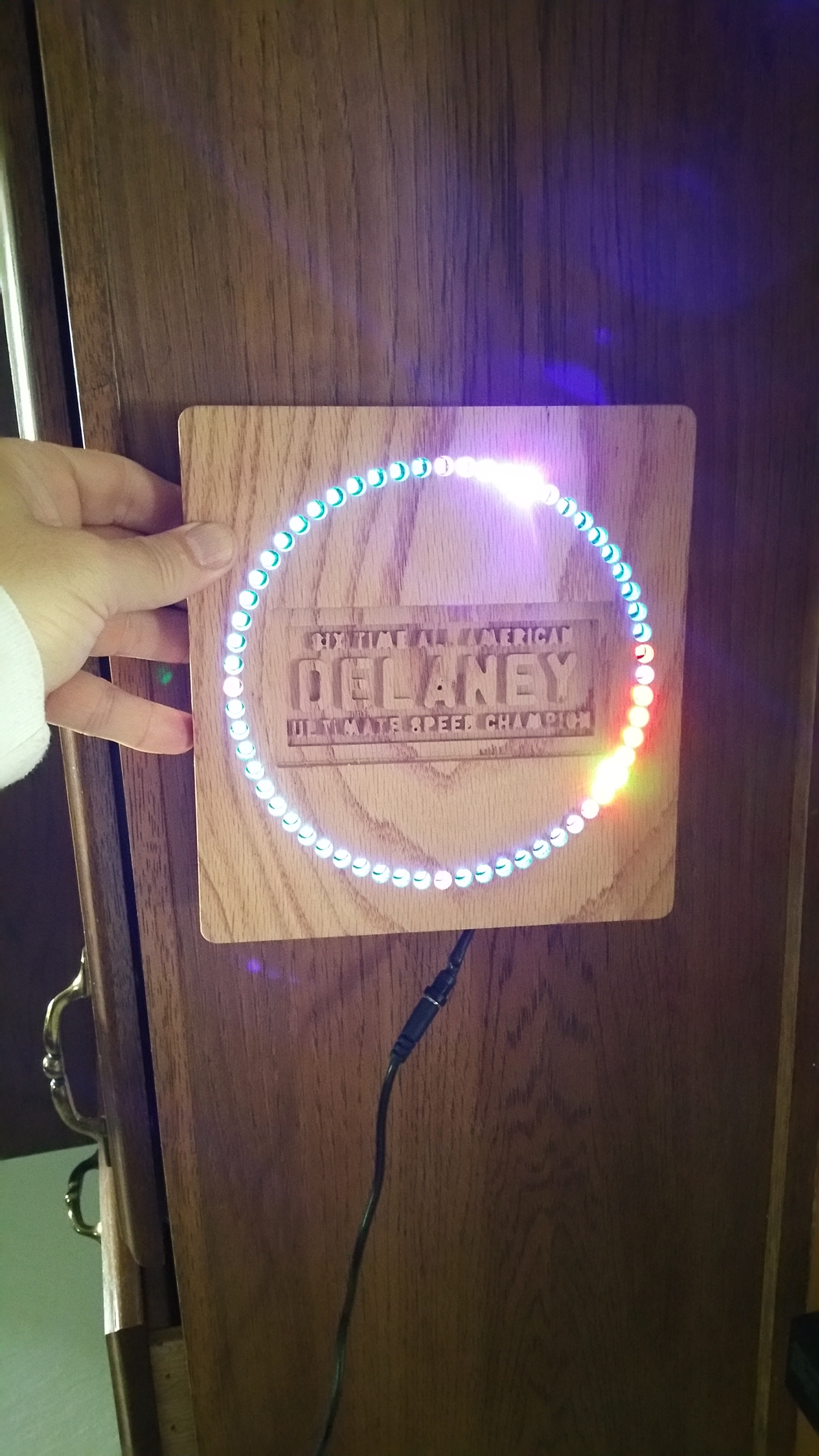

steering plate for soap box derby car and wooden frame for analog/digital led clock (made for my buddy’s birthday)
