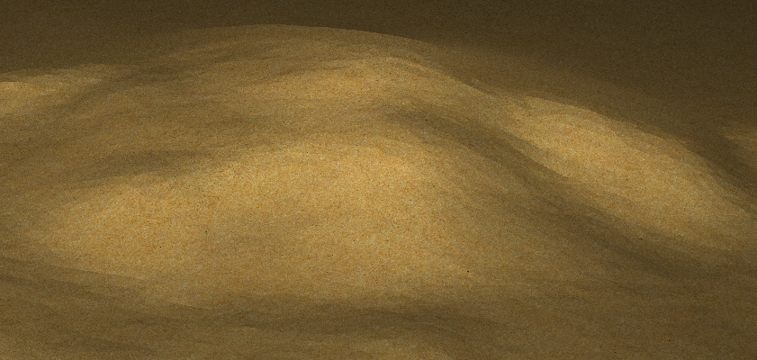

I have made two carvings in Carbide Create Pro using 3D rough and finish passes on an imported greyscale PNG file.
Then 3D rendering clearly shows the mountain top as well defined and all of the other contours showed up very well.
I was using a #201 .25" endmill with a .125" step over and .125" step down for rough, and a 0.03" step over for finish.
Any advice would be greatly appreciated.

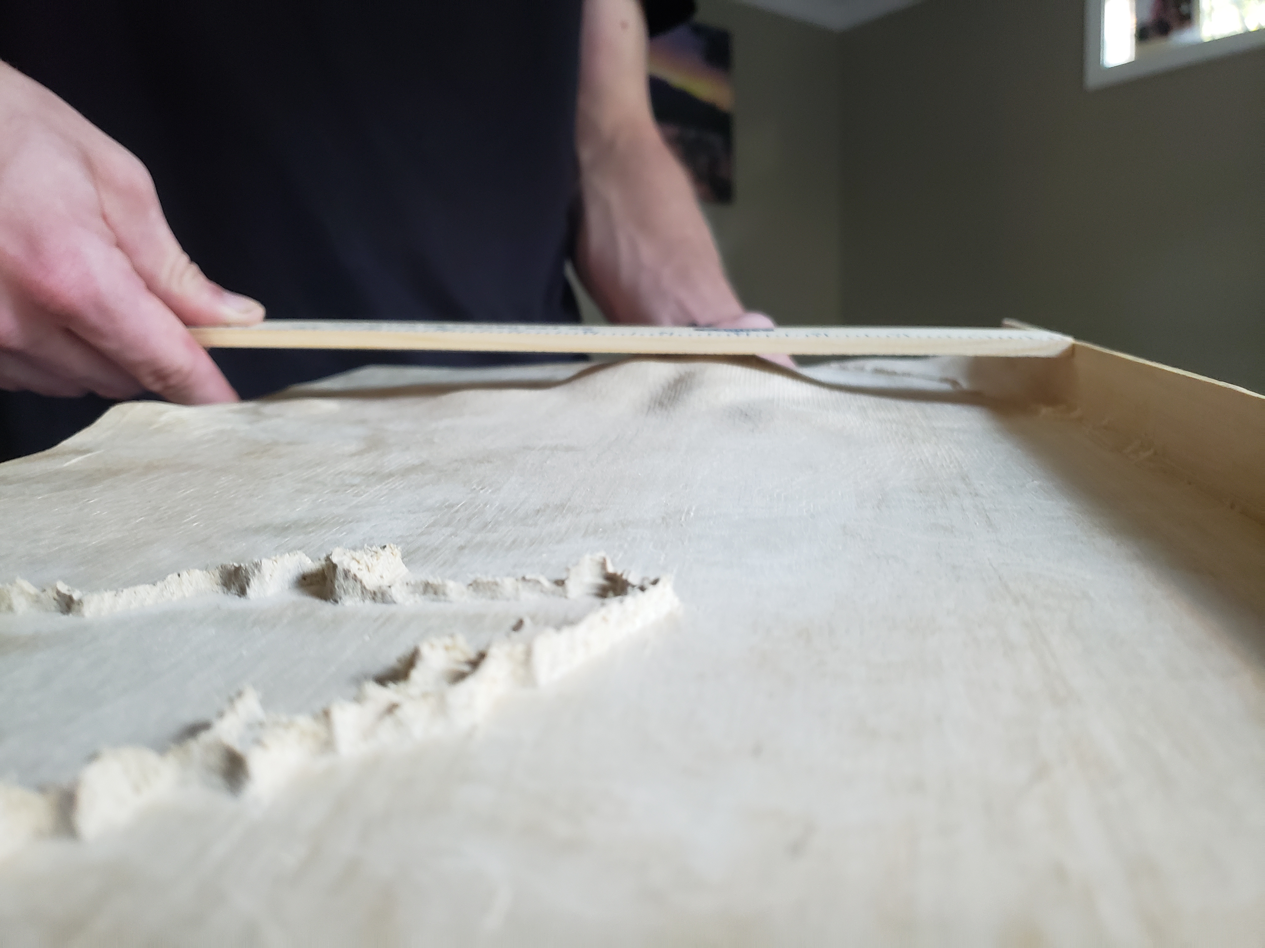

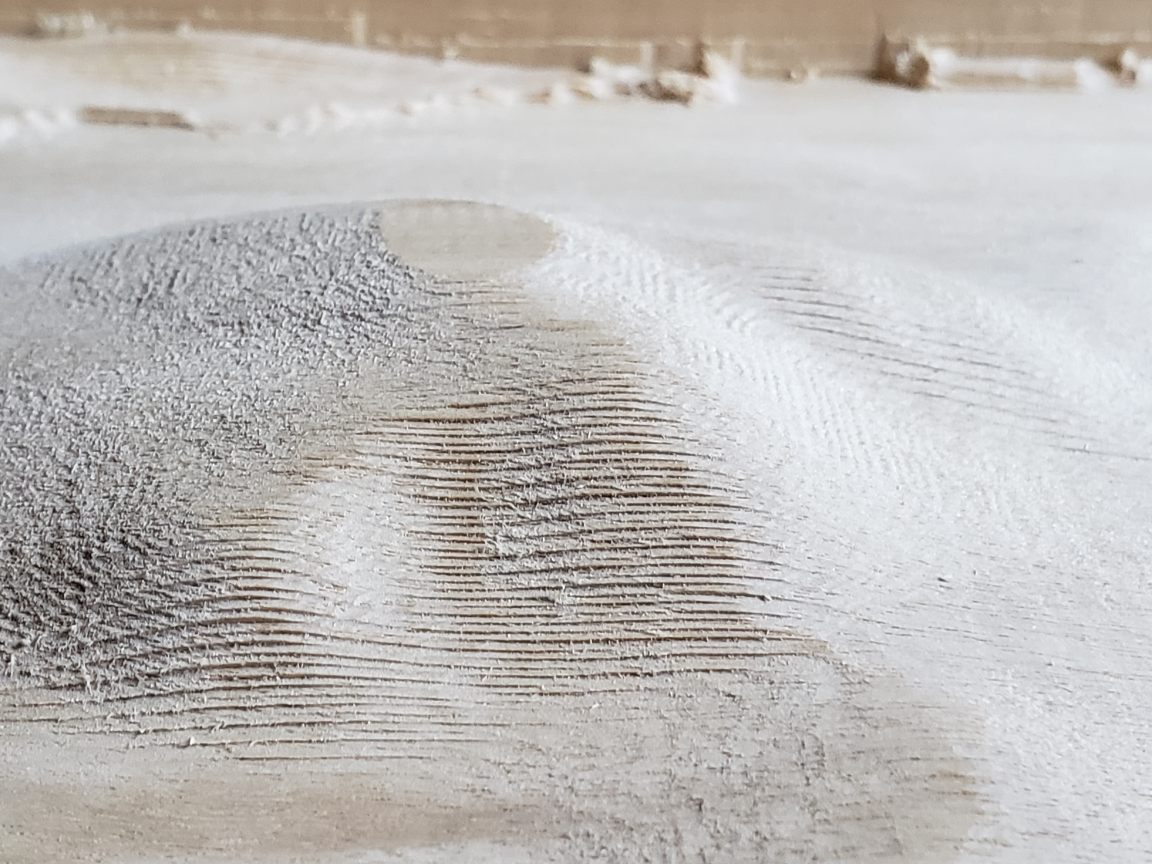

Here is a picture to show that the top was cut down below the surface of the material. on the right is where the cut didn’t quite reach the edge of my board, leaving the entire thickness.
I am really perplexed by this. The simulation shows that should be there, the rest of the topography cut as expected.
How big is that flat area, in diameter?
not very, about the size of my finger tip.
Ok, it’s in the gcode then.
There is a peak about a cm in diameter that has a .002mm difference in Z across the top.
