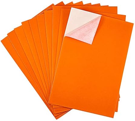

What is the liner in the box. I have a lot of PSA Velvet I use for jewelry boxes and I have about 25 3x5 boxes I need to put liners in. Did you cut it and paste it in or did you use PSA type liner?
For lining, one nice options is flocking:
I have seen the flockit kits for years but was worried that you would get a lot of loose material that would come off. My understanding of flockit is you spread glue where you want the “velvet” then use a small pump to spray the flocking, let it dry and then remove any loose flocking. Most jewelry boxes I make have a removable bottom. I make my box and then rabbet a 1/2 inch x 1/4" deep rabbet. I apply the PSA velvet to the plywood bottom and trim and then drill the bottom for flat head screws. This way there is a 1/2" of velvet that is covered by the rabbet and the bottom is completely covered. If the lining ever gets damaged or someone wants to change the color they just unscrew the bottom and replace the lining. Before I started using this method I would make a grove and capture the bottom in the box. Then I had to cut the PSA velvet perfectly and try to get it pasted in perfectly. Unfortunately the PSA velvet is kind of like contact paper, once it touches that is it.
Now these little boxes do not have a removable bottom so I was going to make a platen on which to cut out the lining and then try and paste it in.
I will look at the flockit but as stated above am wary of the fallout (loose flock).
The material seems to stay in place pretty well, so long as one doesn’t chip/damage the underlying material.
flocking is something I wanna try, maybe when I do something with odd sized compartments.
but for basic flat bottom stuff like the one I posted above, I’ve just been roughing in sheets of this stuff with a good paper cutter then trimming to fit with an xacto.
