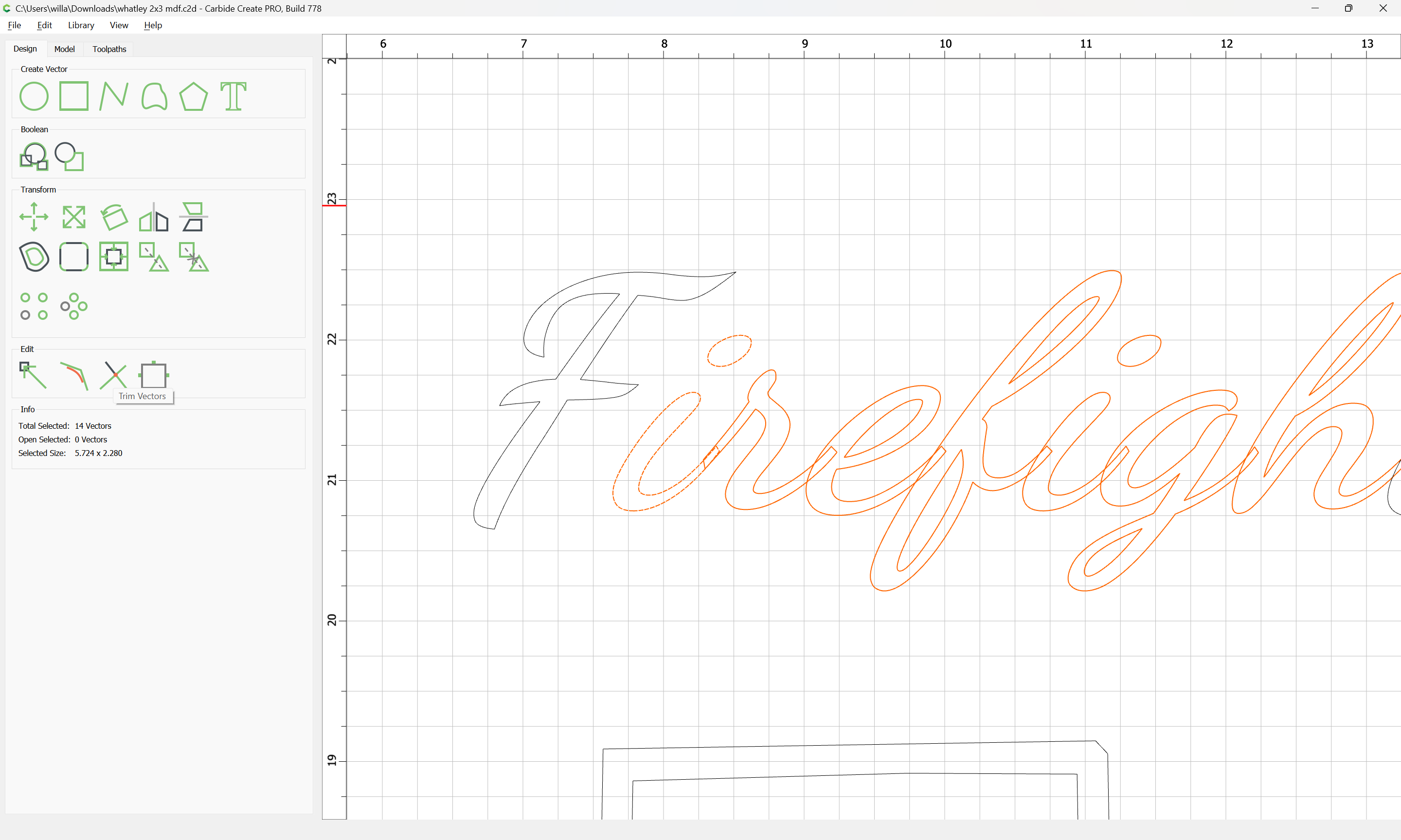

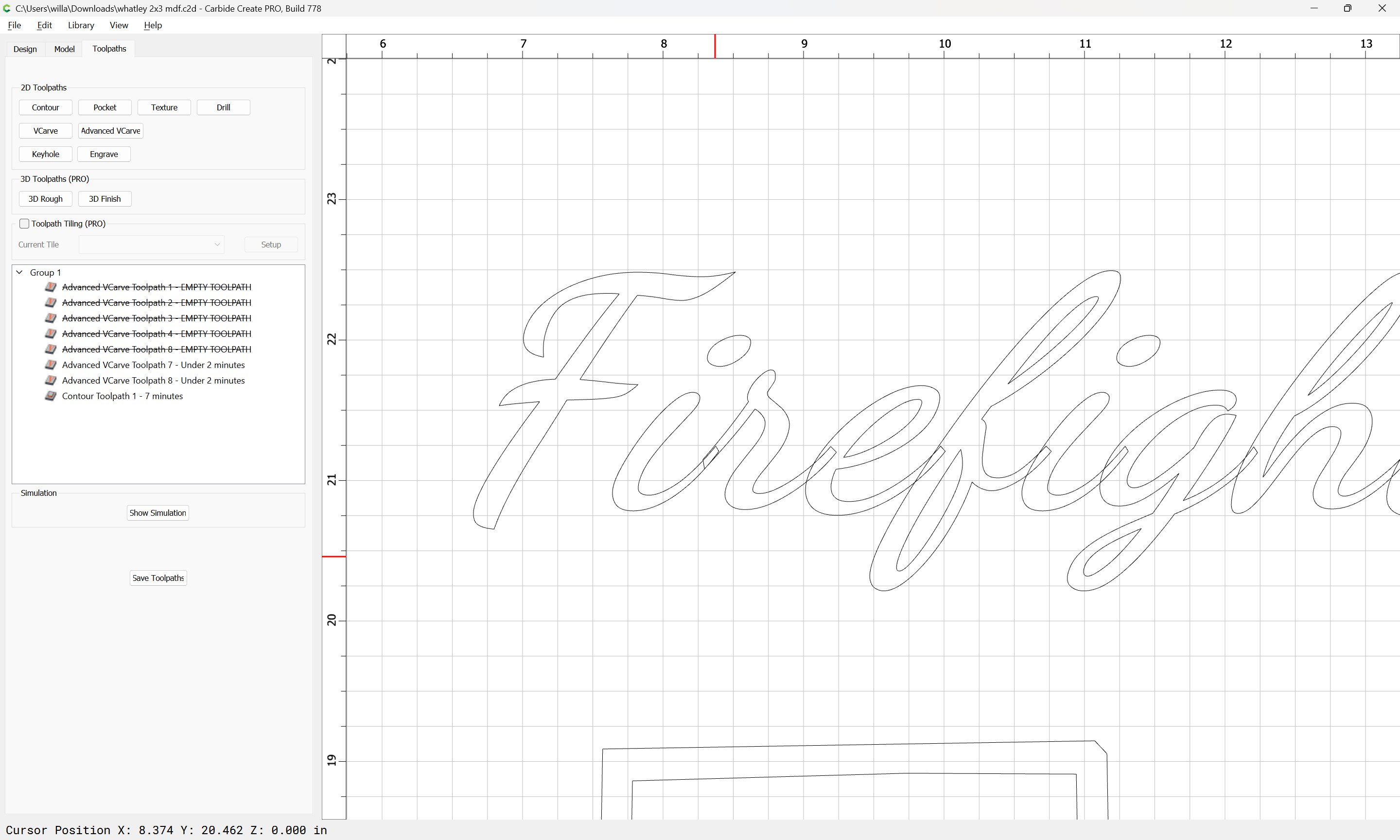

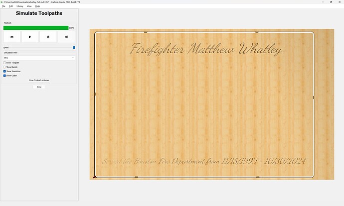

with a few letters that wont cut correctly. the tt in matthew in this file wont cut out correct.
thank you on advance for your help

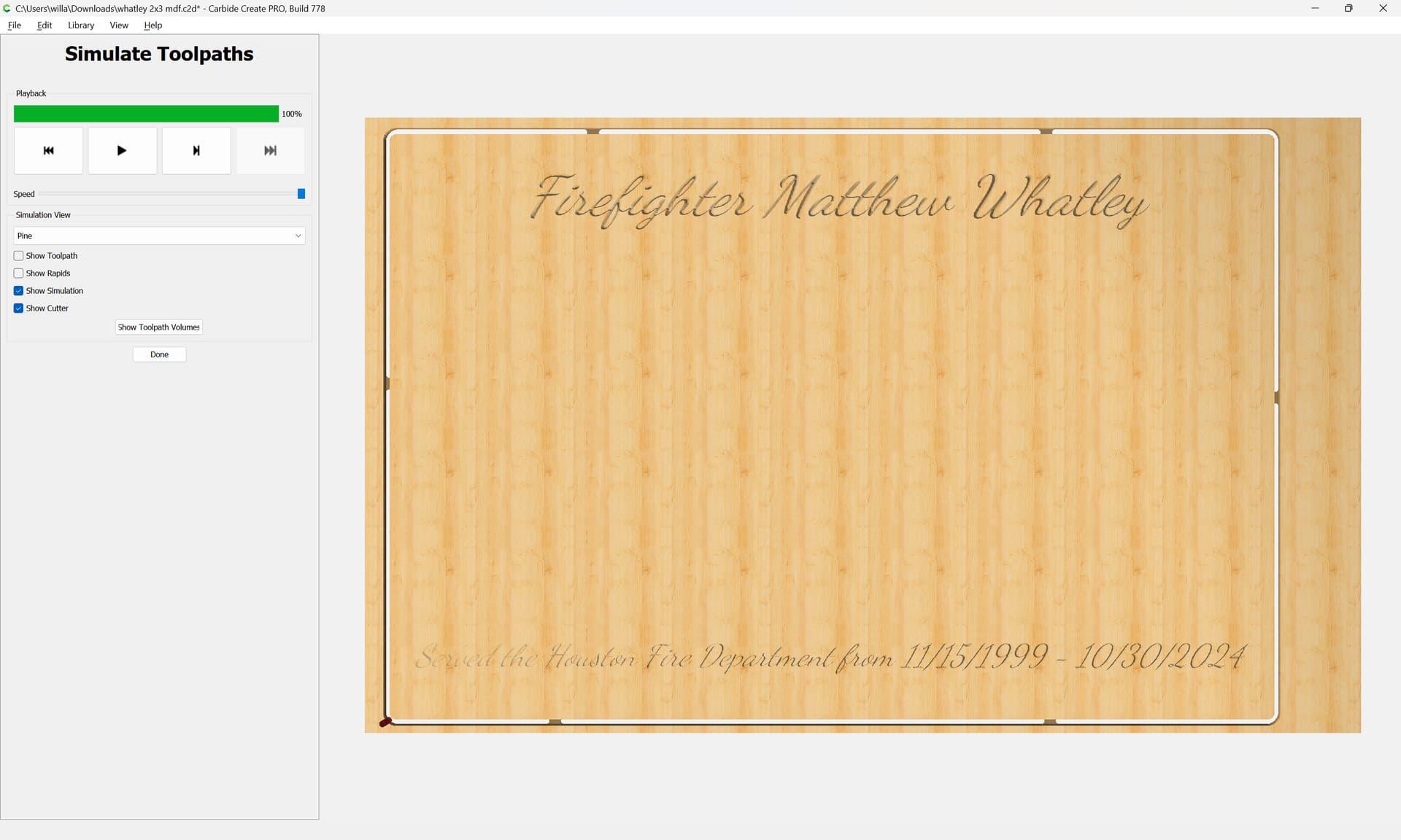

I downloaded your file but only some of it showed in the simulation. When you edit text you can increase the spacing of letters and that might help. Maybe another font.

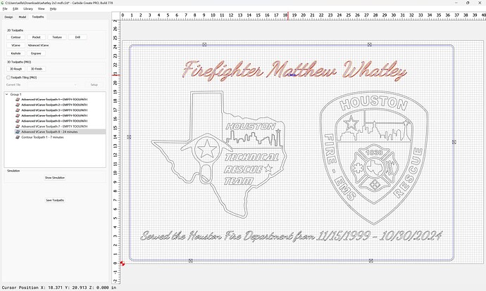

i am working on this file i created for a retirement for a friend at work.
for some reason the tt in matthew will not cut correctly. thank you for your help

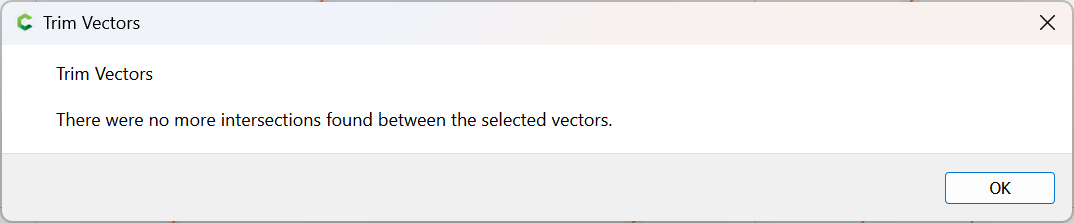

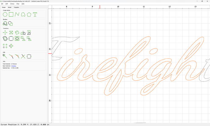

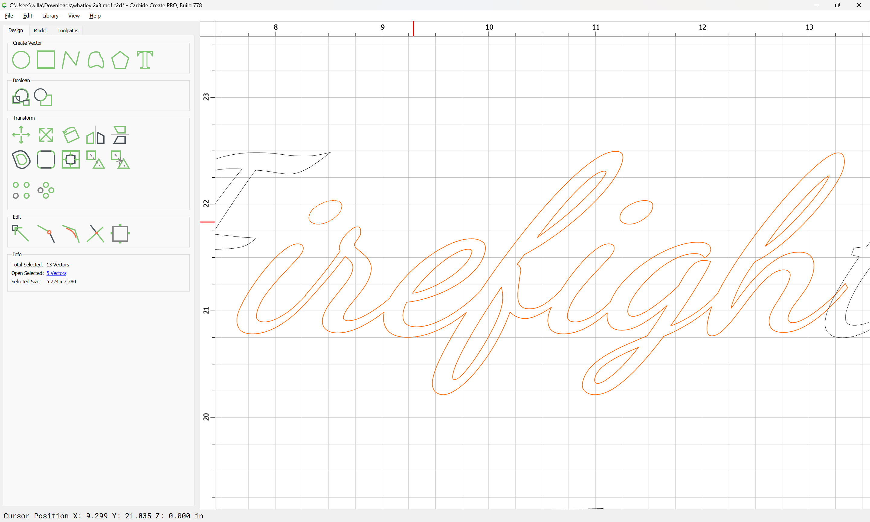

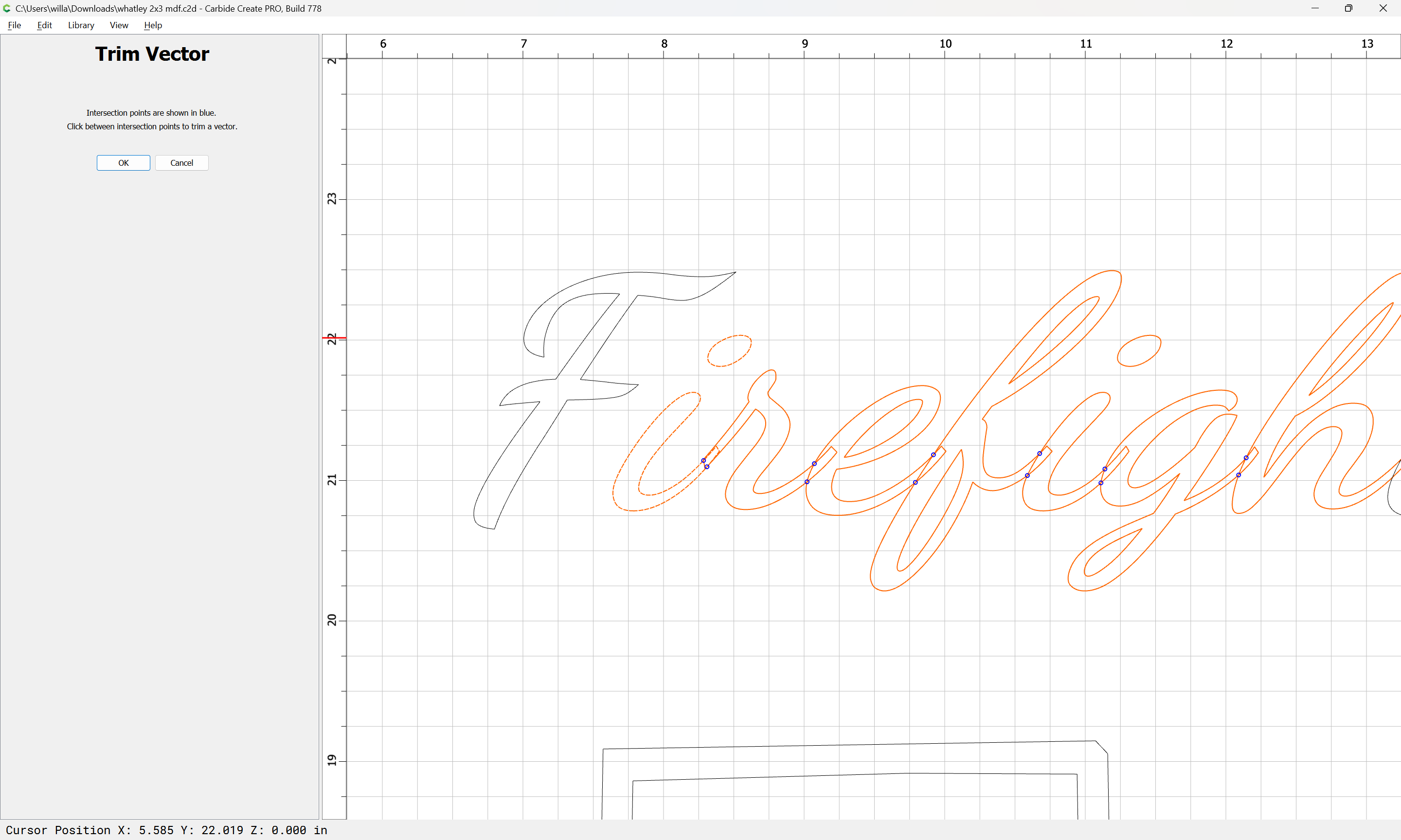

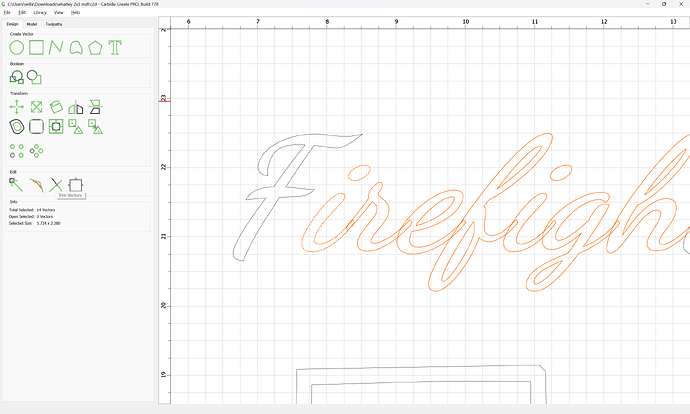

Your letters overlap:
For the basics on this see:
https://carbide3d.com/blog/merging-script-fonts-in-carbide-create/

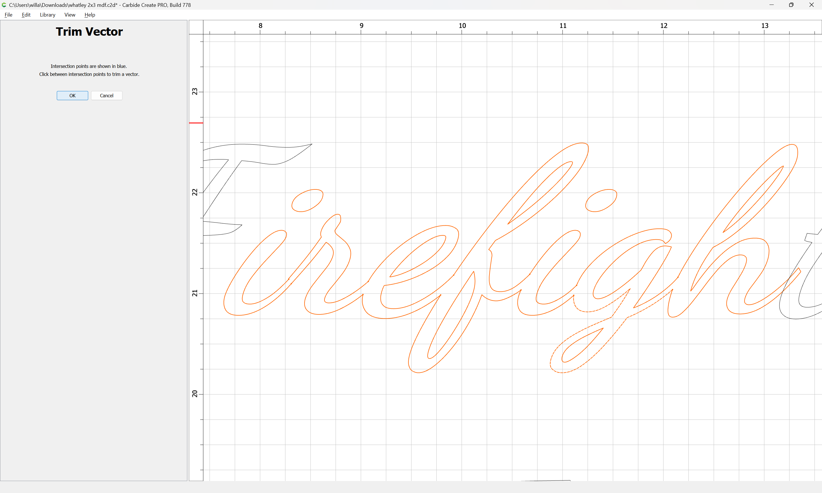

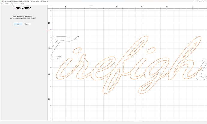

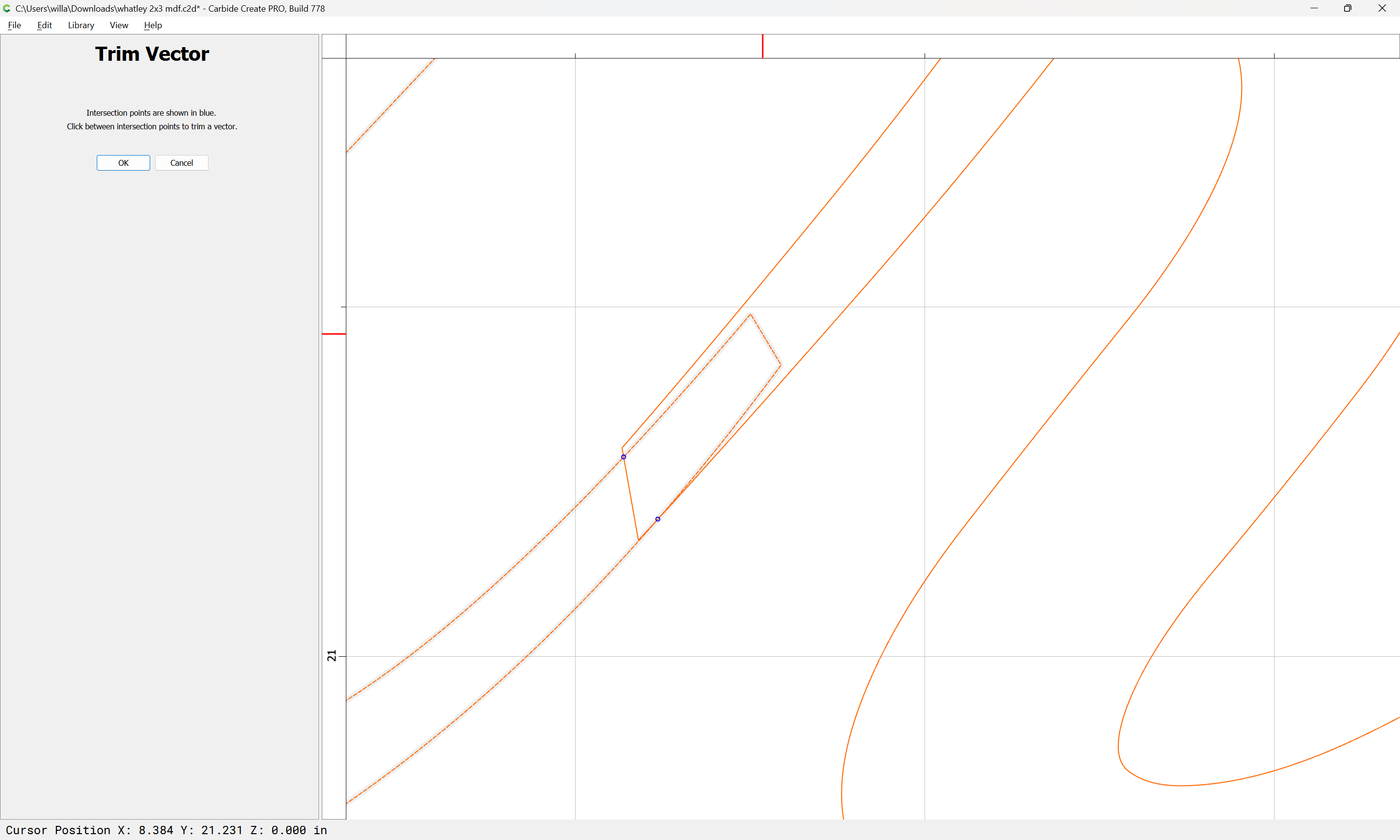

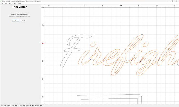

One technique for this is to use “Trim Vectors”:

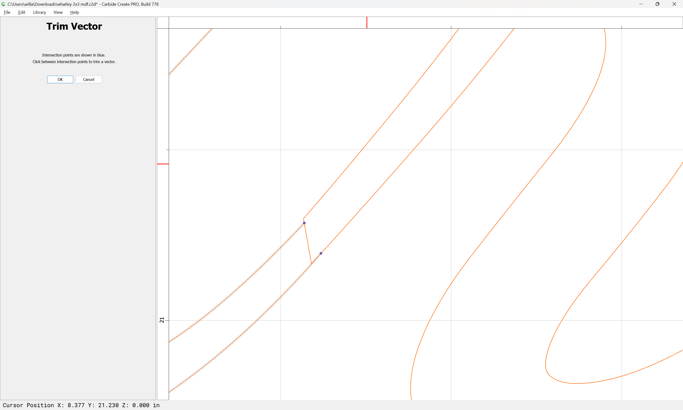

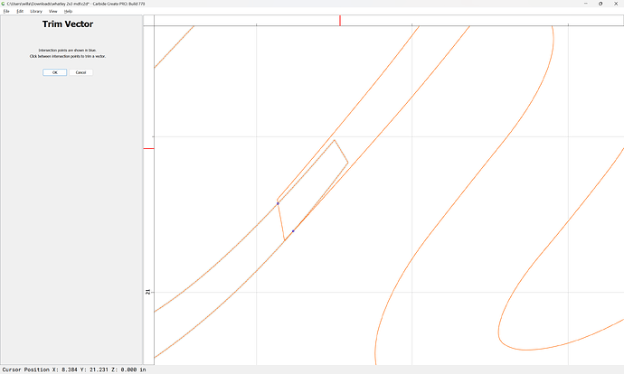

Zoom in:
click on what is not wanted:

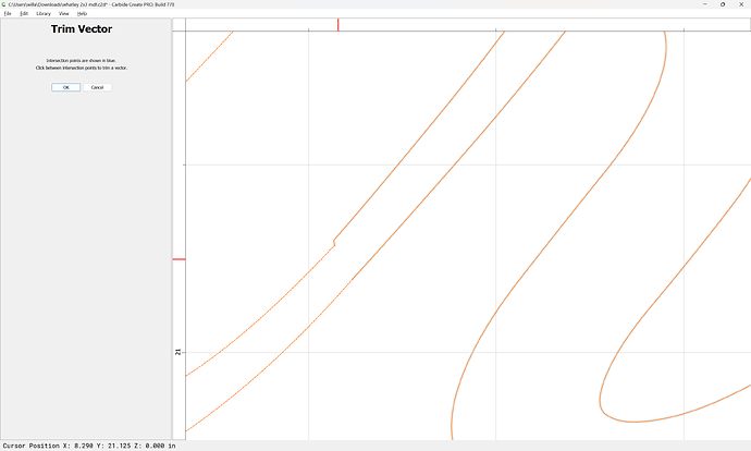

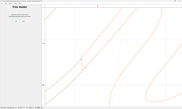

repeating as needed until one arrives at:
OK
OK

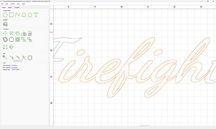

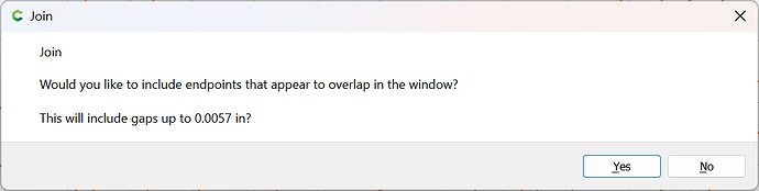

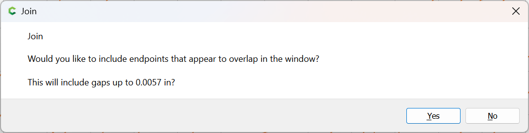

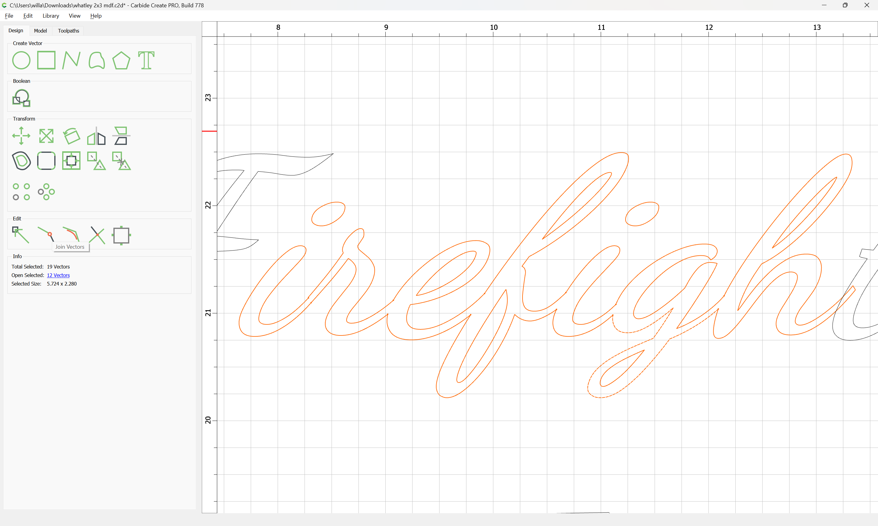

Join Vectors to close:
Yes

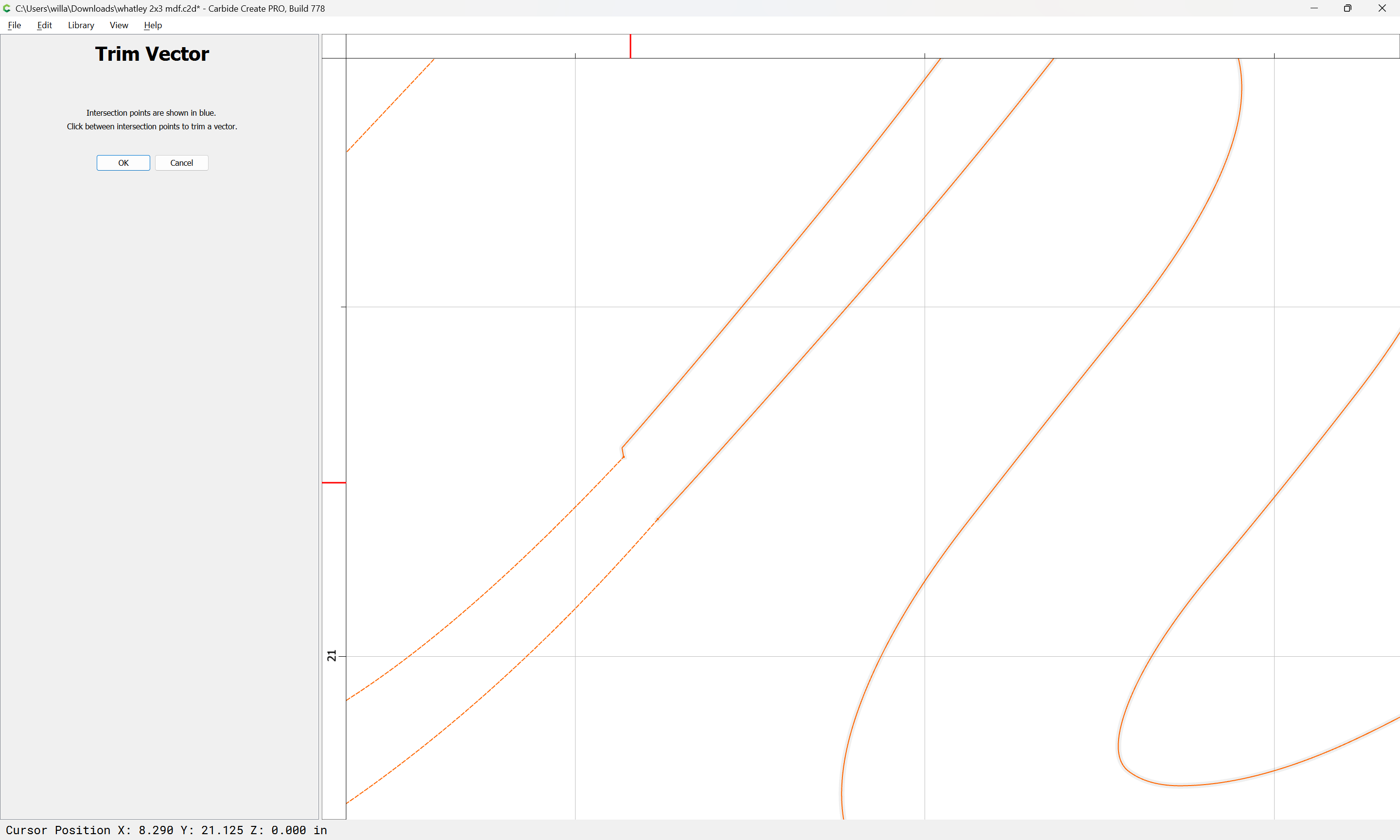

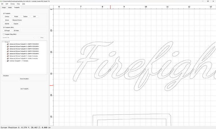

Repeat until all such overlaps are fixed.
Attached as a v7 file.
whatley 2x3 mdf_v7.c2d (816 KB)
