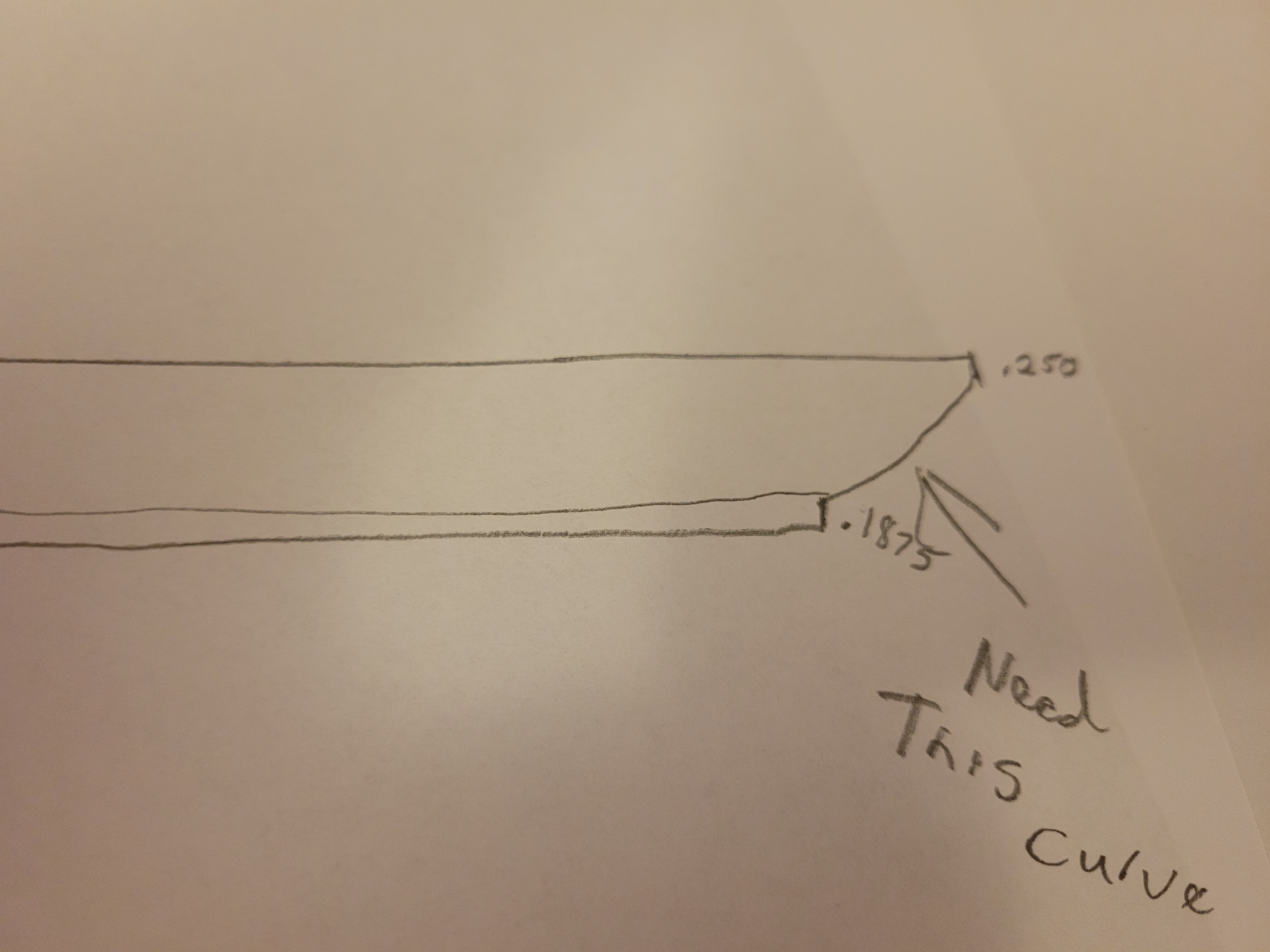

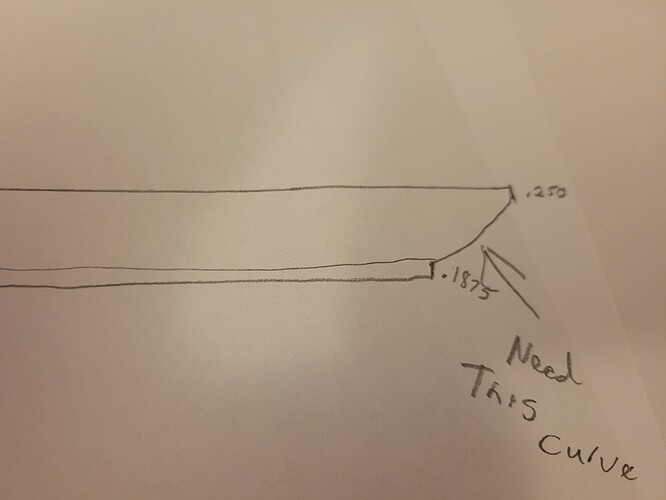

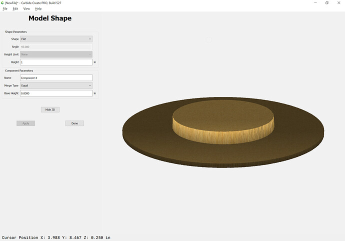

I’m trying to put a slope on the bottom of a platter. I want to have .250 flat on top edge sloping from there 3 inches toward center to the edge of the base ring .when I try it in modeling I get a full half circle profile .
Sorry for the crude drawing and thanks for any help .
Greg

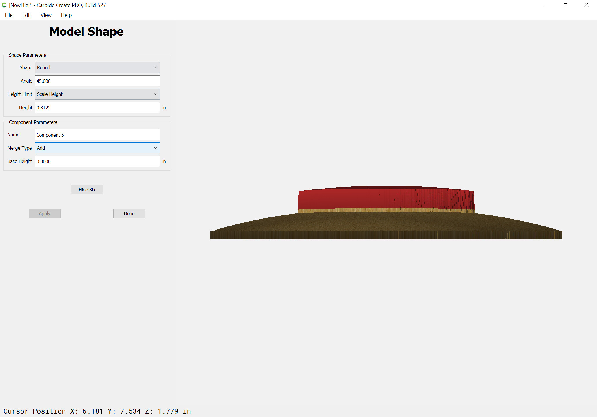

Okay, start w/ the flats modeled:
Adding a rounded scaling seems to result in what is desired (plus a bit extra):

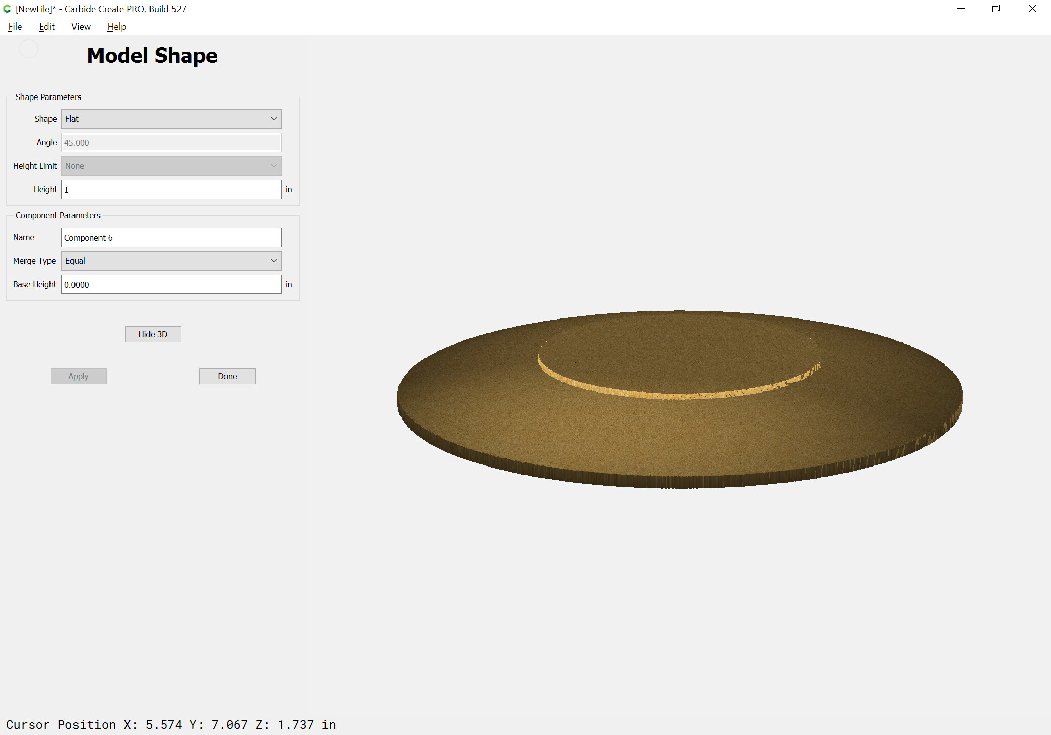

Reapplying the flat then gets one the desired bottom:

Attached:
rounded bowl.c2d (1.5 MB)

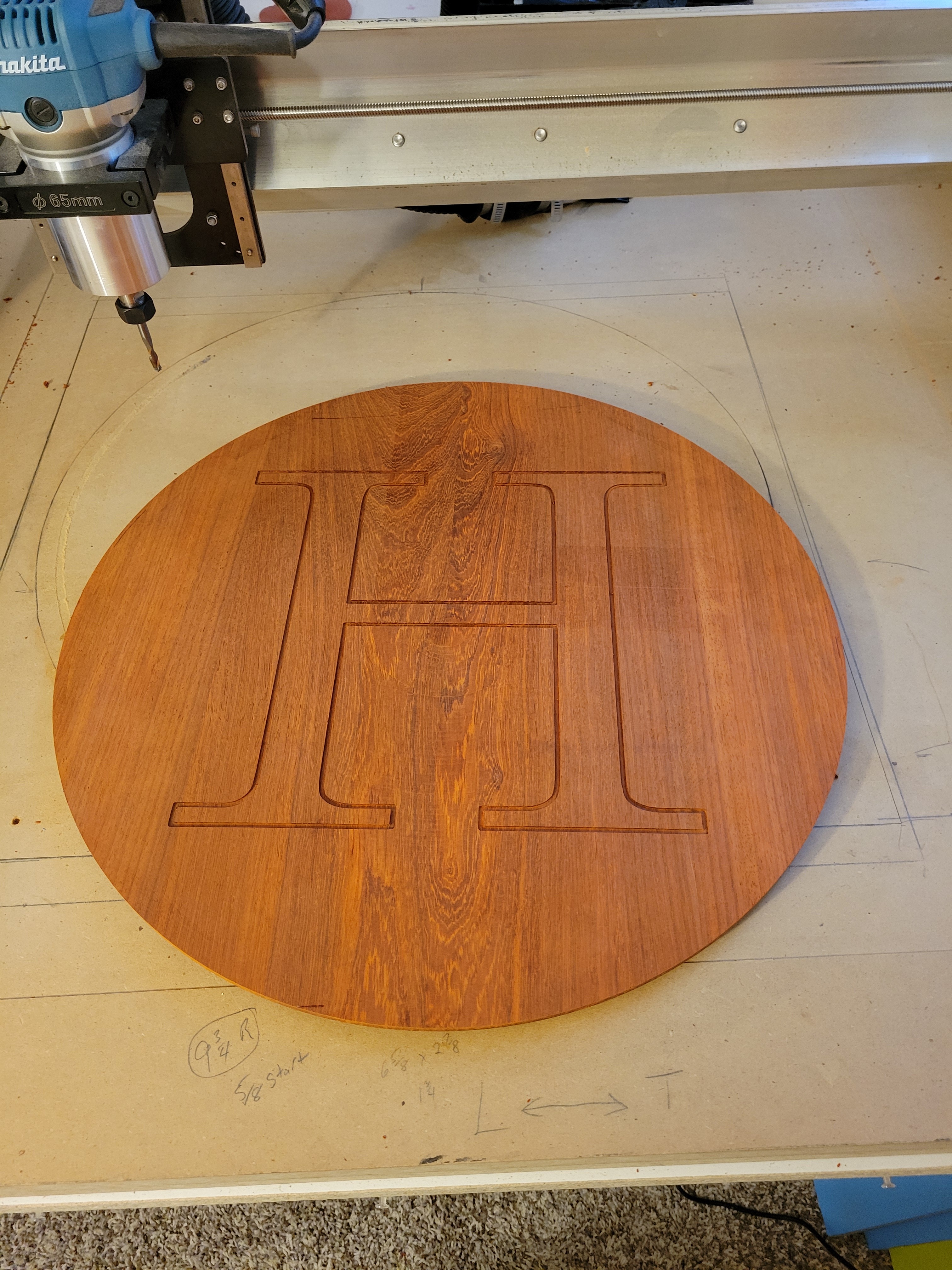

6

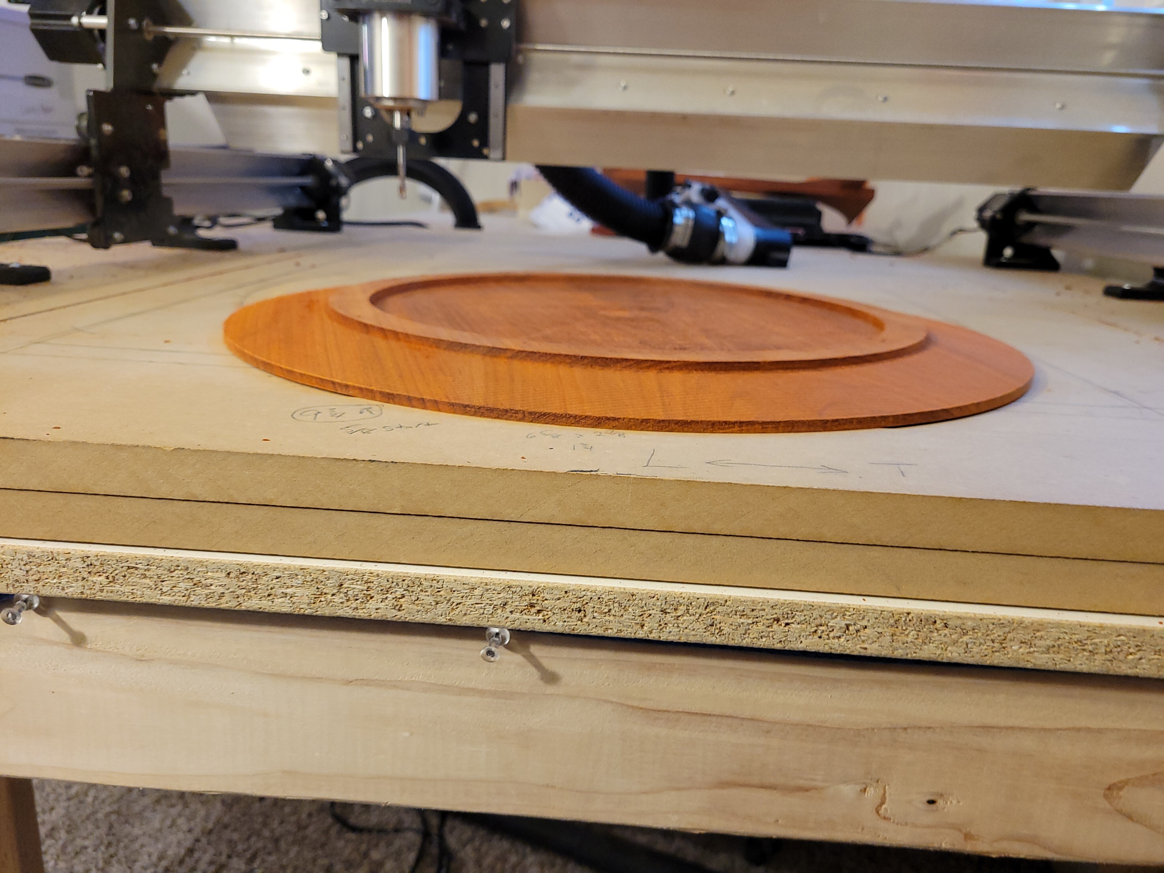

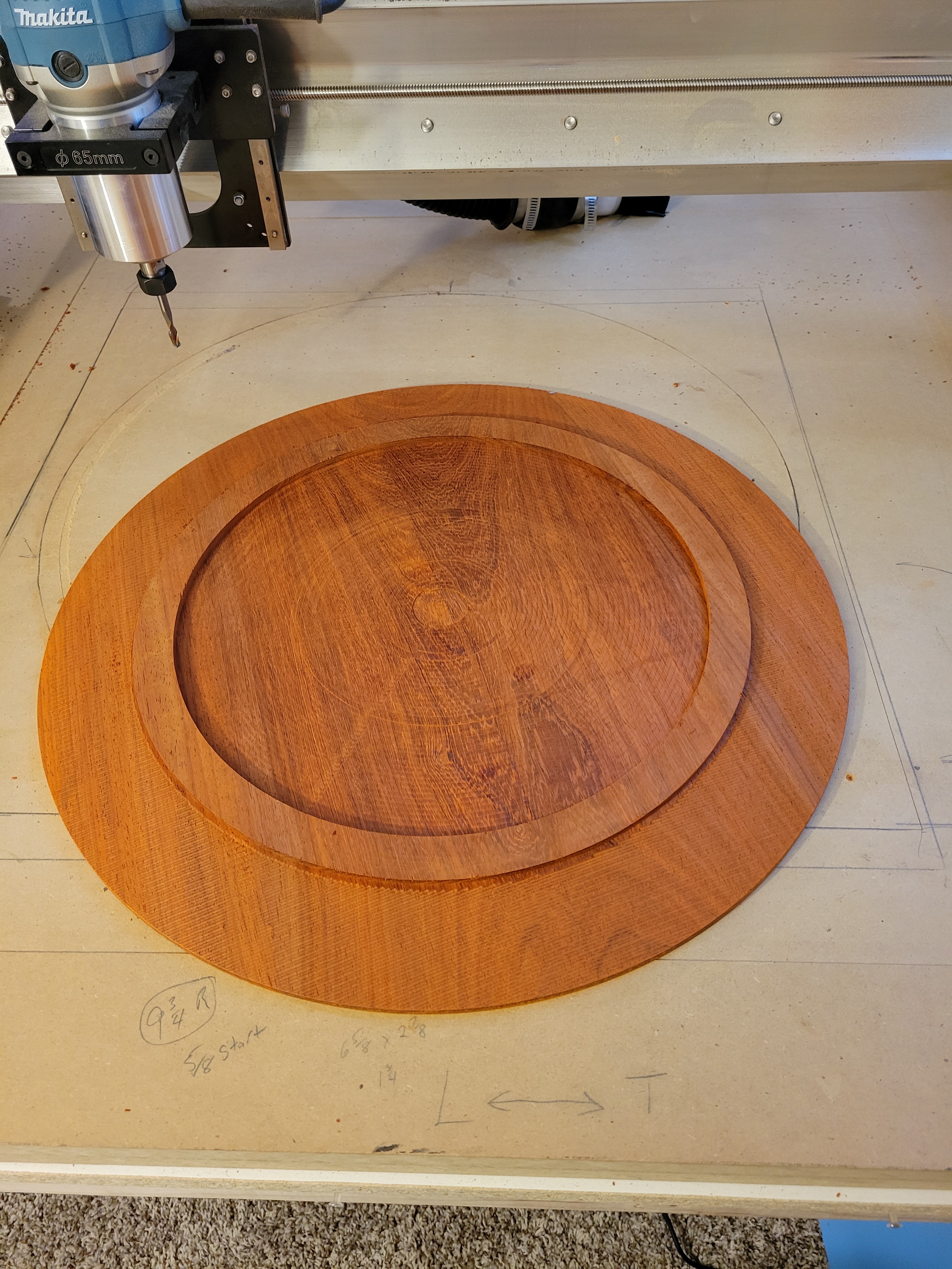

All cut and ready for some sanding and black starboard ln the H.
Thanks for the help , Greg
