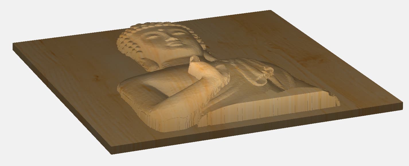

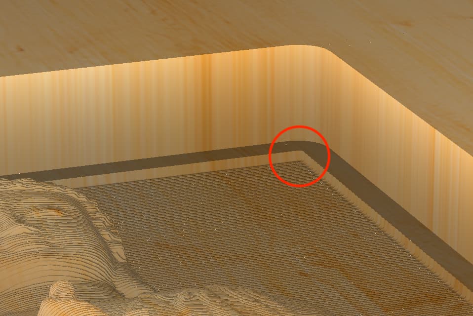

Trying my first 3D carve with a STL file import.
I cannot find a way to eliminate the small step in the base of the carve shown in this picture.

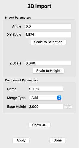

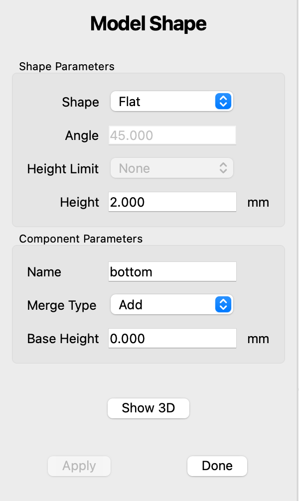

My settings are (mm)
Stock thickness 12.7
In the model there is a flat model shape
and the STL file
scale to height is set to 8mm.
I have also tried with the STL model base height set to 0 and get the same result.
This is the Model 3d View.
All help greatly appreciated.

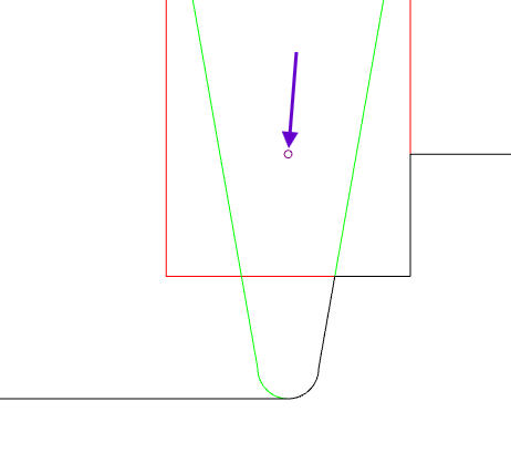

3D toolpaths cut ON the vector, meaning the center of the tool cuts on the vector (purple), so it’s cutting a bit bigger than the boundary. If the roughing tool (red) is larger than the finishing tool (green), you’ll get that step.
