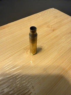

I’m creating a key holder and I have been brainstorming how to attach/secure a .223 casing to my project that would sustain the weight of keys. Below is my project picture and the .223 casing. I reckoned that I could tilt the wood at the top with some 1/4" spacers and clamp it down to allow the tooling to clear out a round pocket which would allow me to insert a dowel or ?? on an angle to hold the shell casing. The hole in the shell is about 0.222", I’m not sure if a dowel that size would be strong enough.? Another thought was to fill the casing with hot glue and attach it with a screw from behind??

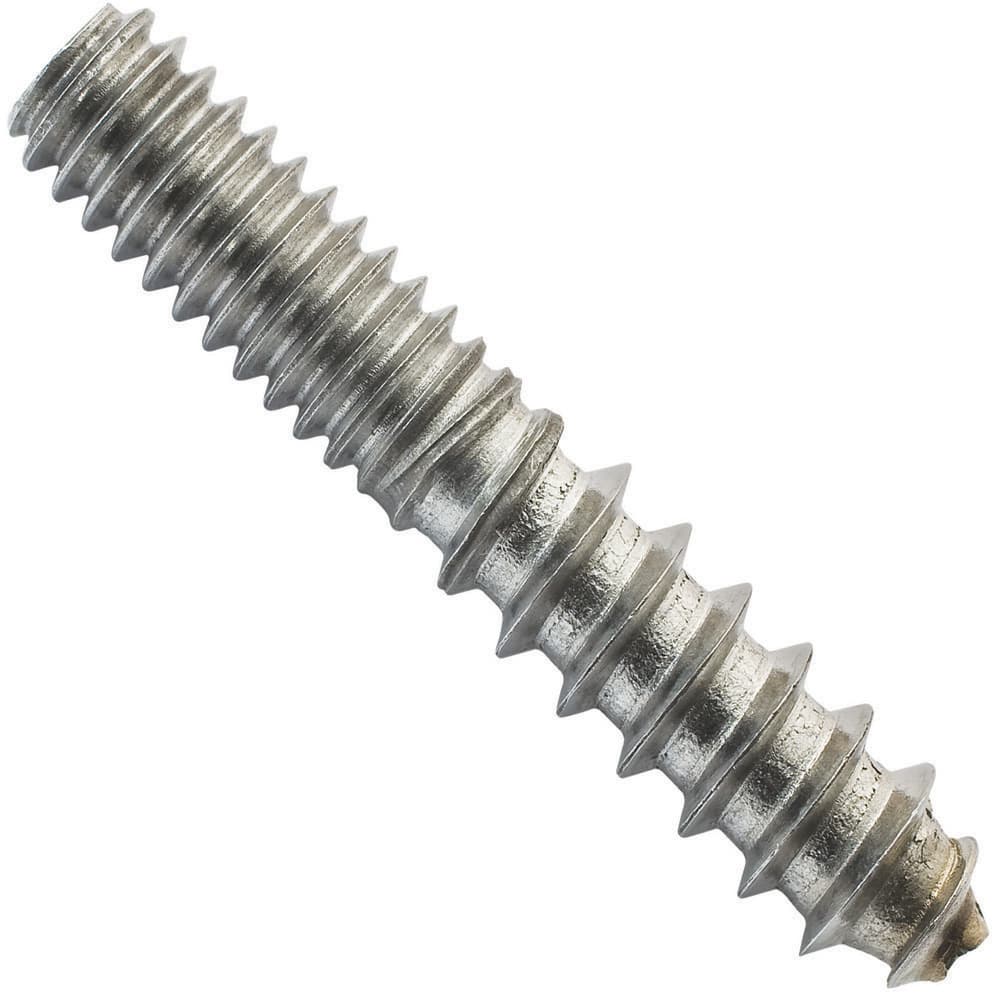

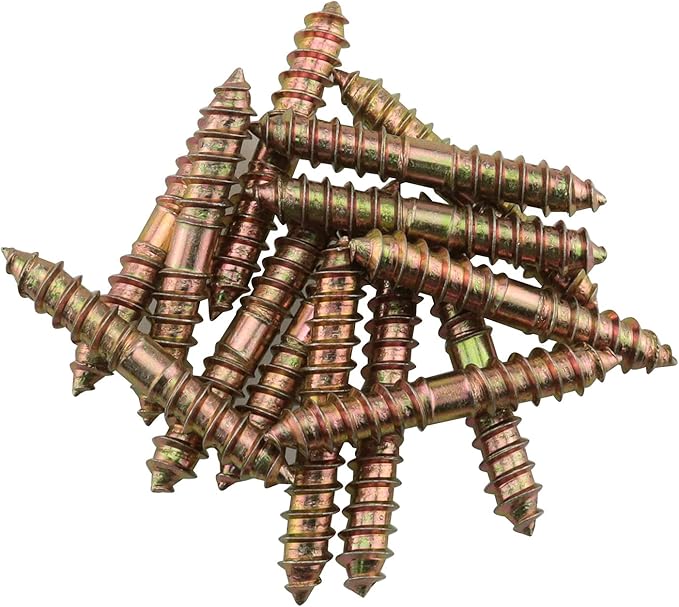

That gave me an idea, I forgot about hanger bolts.

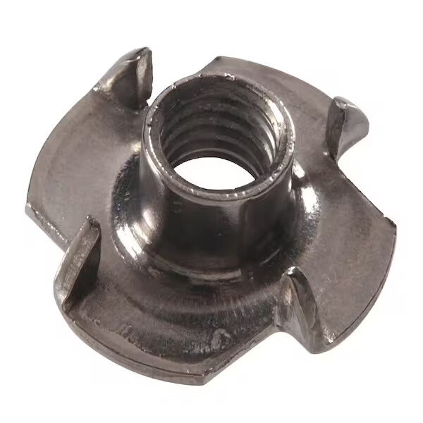

I have made key chains out of spent brass casings. I used many different things to attach the key ring holder to the brass. What worked great for me was the two part fast setting epoxy like the one in the dual syringe 5 minute epoxy. you could use the hanger bolts as pictured above or I would use the hanger bolt that has the wood screw thread on one end and a 1/4 thread on the other end. This would make assembly and disassembly very easy. You could also use a T-nut on the back side of your project
