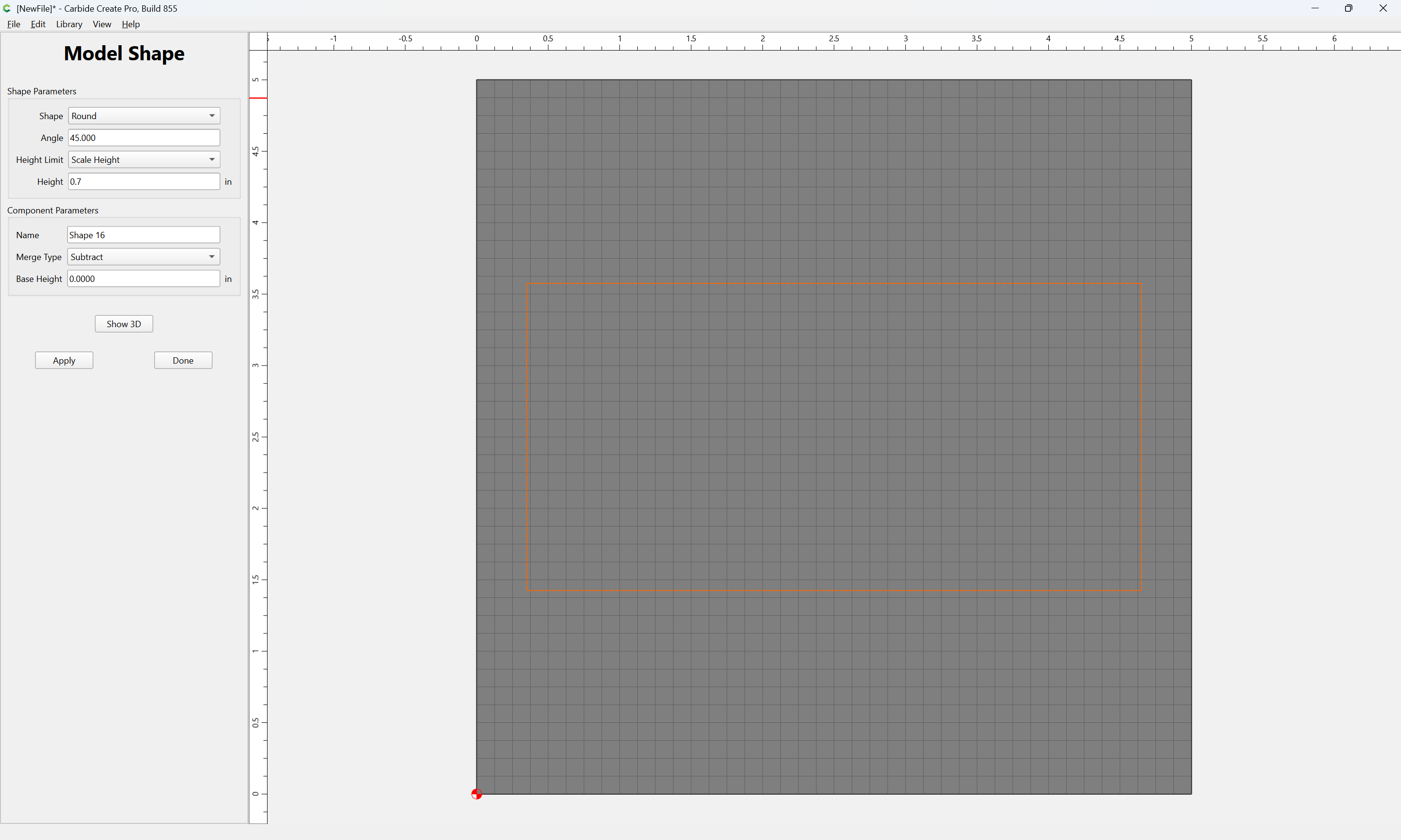

Need to create a slot a circular disk can fit in
I need to have a 1/4 bit start at the wood surface, as it travels 2.15 inches, I need it to cut down to .7 inches and back up to the surface. This will allow a round disk fit into the slot snug. It should be easy in 3d modeling, I am just missing it.
Any suggestions?
Thanks
Darrell

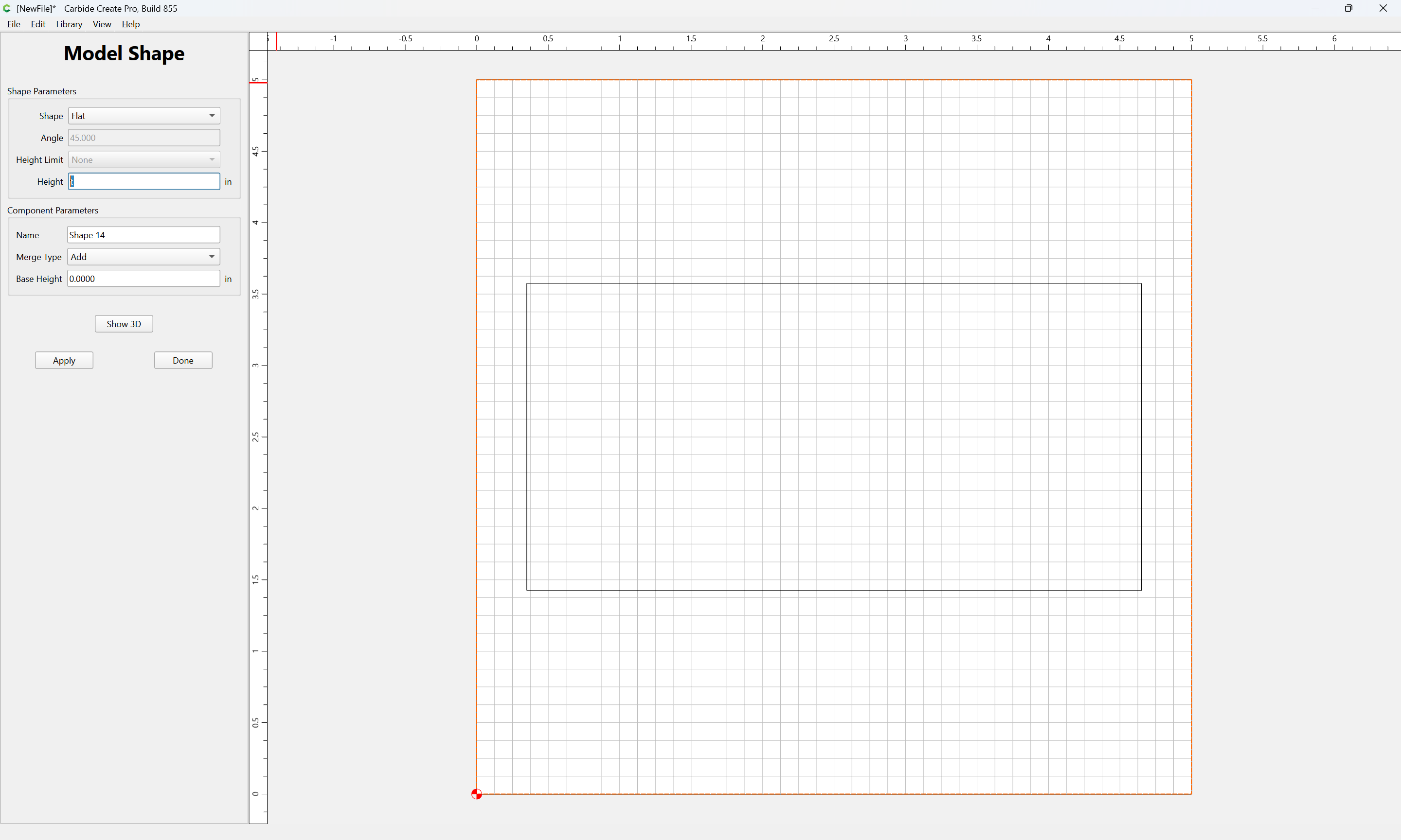

It will be necessary to model this a bit larger than the end result.

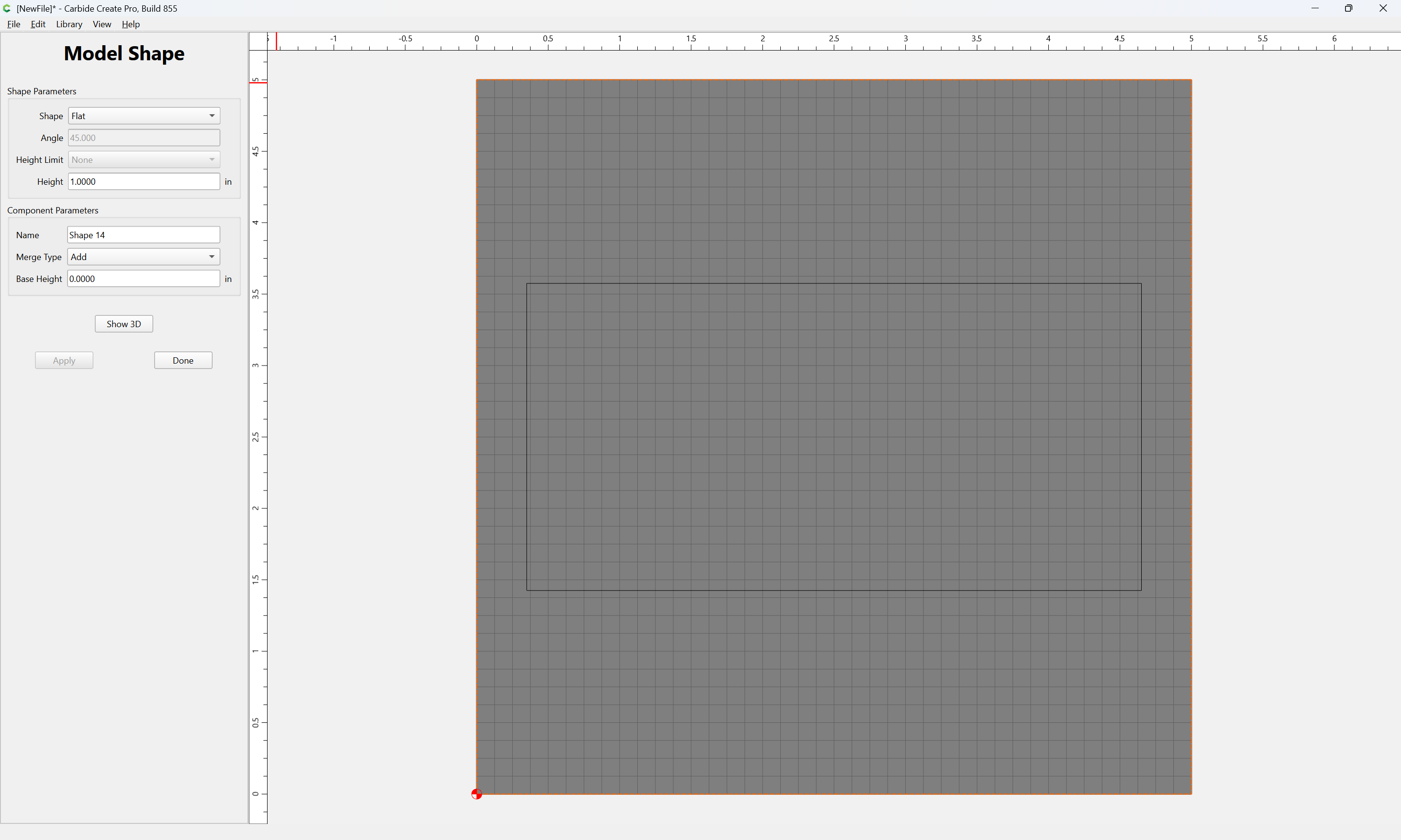

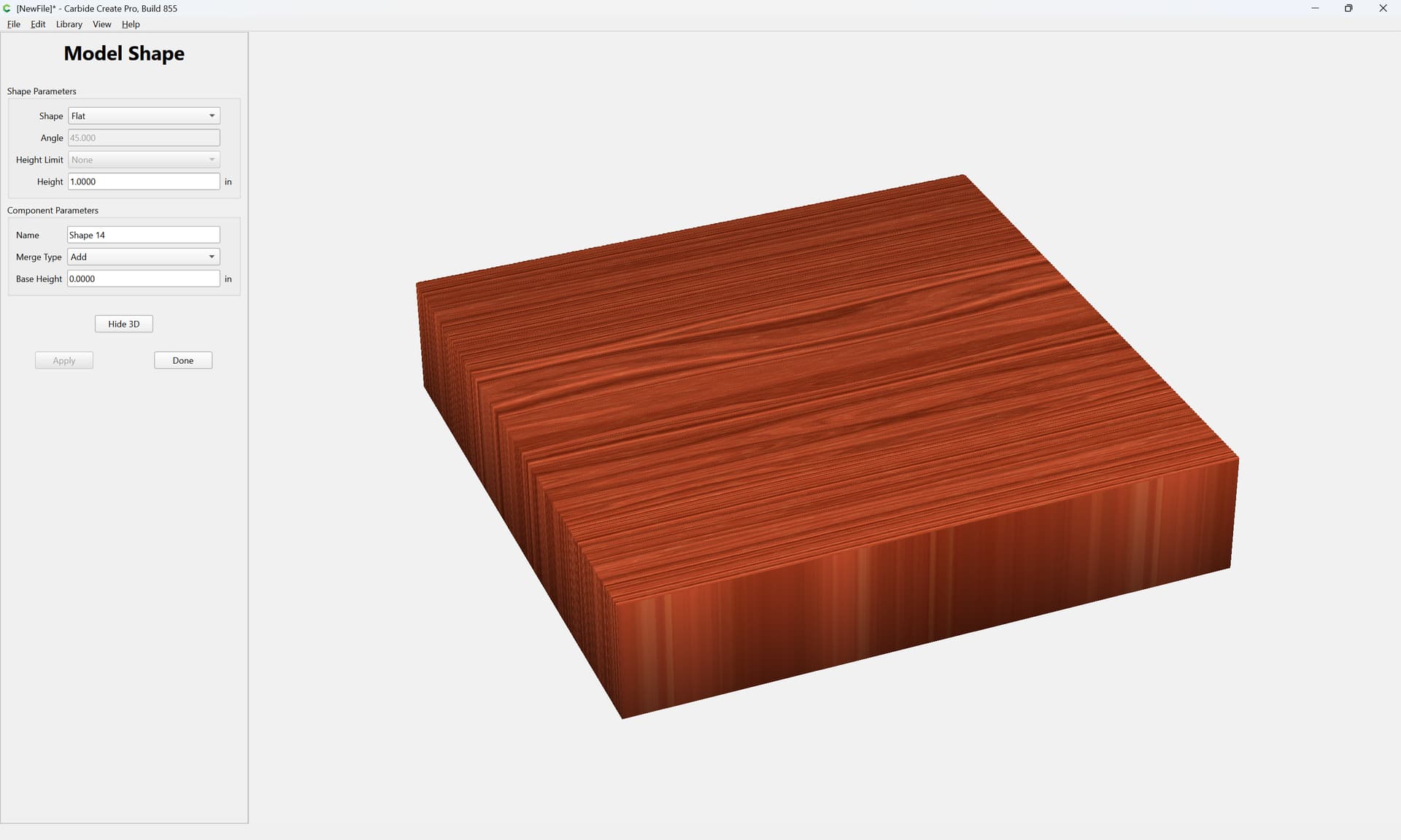

and to model the stock in its full thickness:
Apply

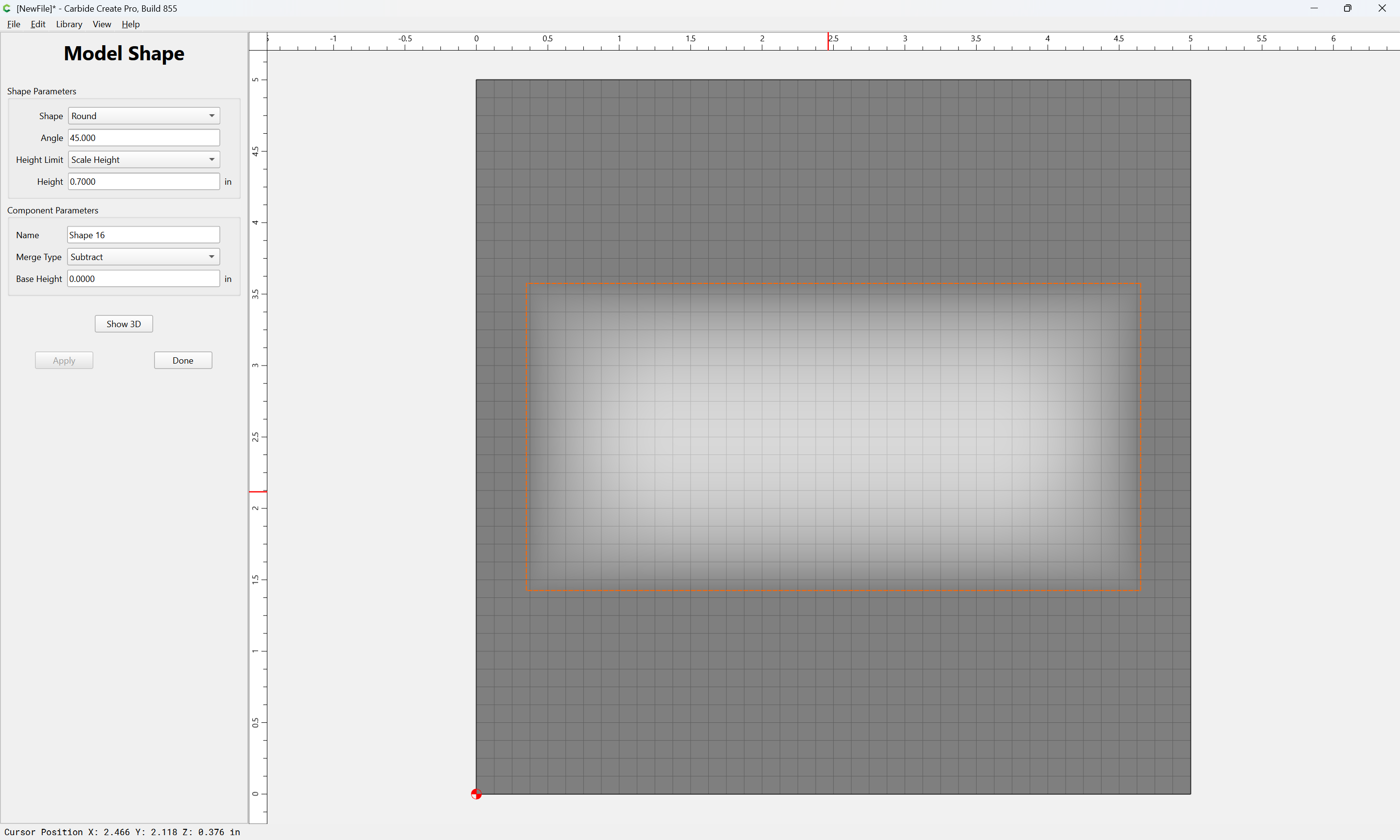

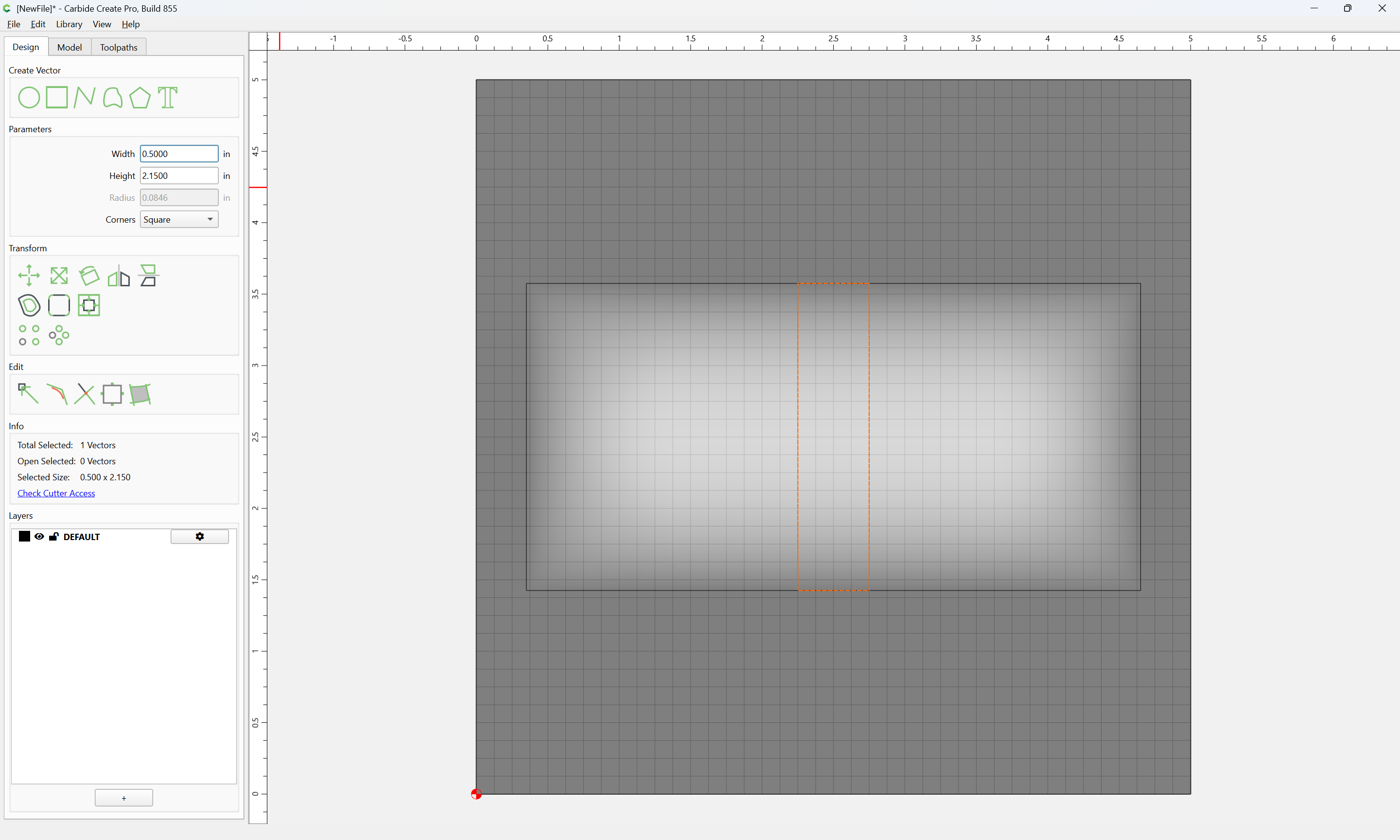

Then, model the rounded removal:

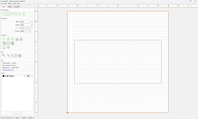

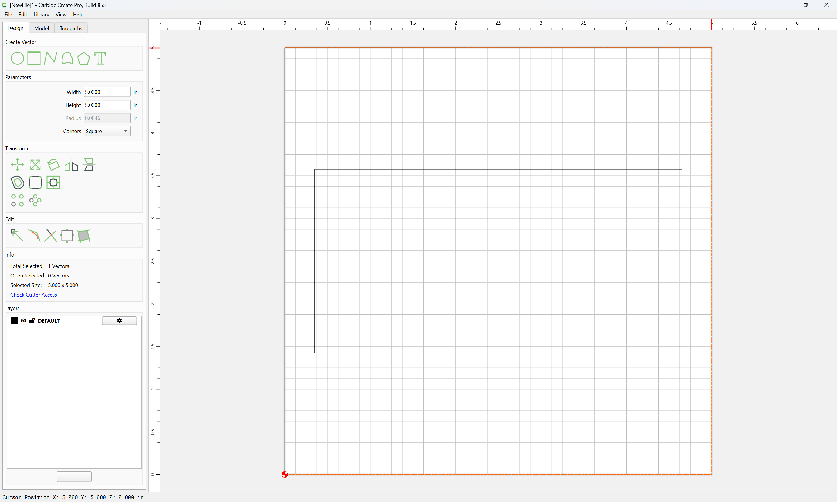

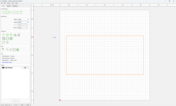

Then draw in the region which one wishes to define the slot:

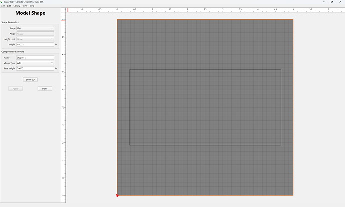

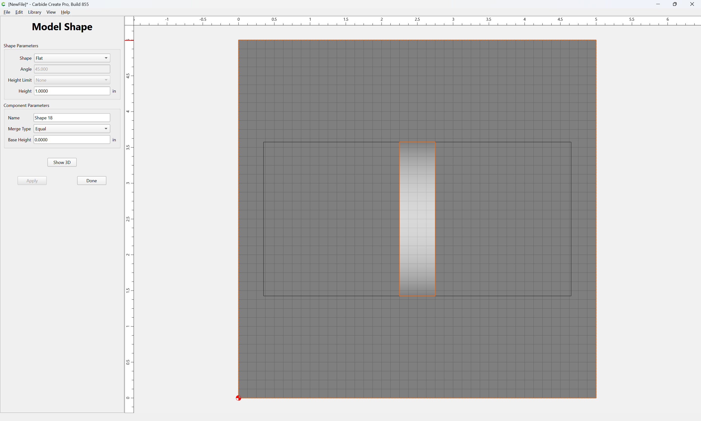

and add the area which defines the Stock to the selection by shift-clicking.

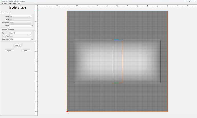

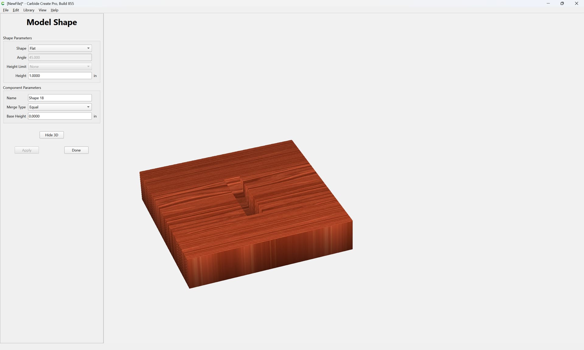

Then model it to thickness equal to the stock:
Apply
Thank you, I was hoping it was simple.
