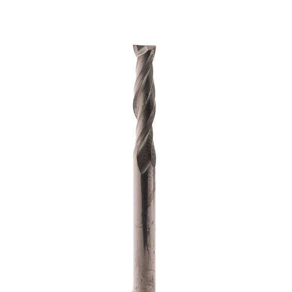

I need to know if a #201 bit is an up cut or down cut
It is an upcut endmill.
@david5 The #251 is a 1/4 Downcut endmill
#205 is 1/4 Downcut Endmill
Since the #205 is described as working well for aluminum, plastic, brass, and copper, it is an upcut endmill:
I’m not aware of any downcut endmill geometries which work well in those materials.
