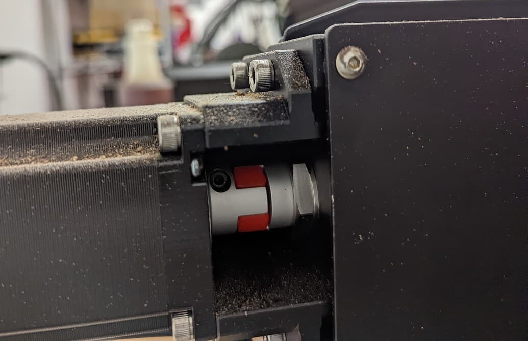

Could your coupler have come loose?
All 4 couplers feel like they’re tight. Just turning them by hand I don’t feel any looseness.
Edit: I was able to tighten one of the set screws on the right y axis several turns. It still feels like it’s stumbling, like something is lose, when I push the gantry quickly. It actually feels like the gantry is going over bumps, but only when pushed quickly. Pushing the gantry slowly feels solid and smooth.
Could that be the slider bearings on the rails doing that?
I think when you are trying to move the gantry around manually, you are introducing back emf into the stepper motors and they will start to give power to the stepper drivers and cause it to almost have a braking effect. I have to move my machine slowly or it will do the same thing.
If you are still hearing/feeling bumps when the machine is on and you’re jogging it around, I would suspect some material might be in the ball screw nuts or bearings.
