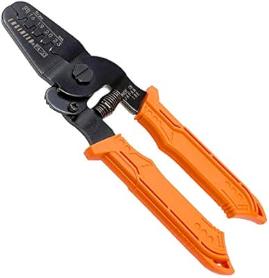

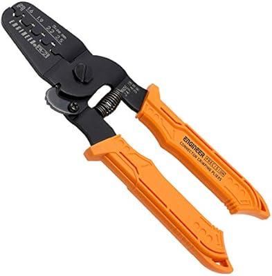

Crimpers. Not as nice as the manufacturer built $400 crimpers, but work well with a little care. Between these three, you can crimp pretty much any small size crimp pin or socket. These used to be about $25 each, but work so well I guess they raised the price ($40-$50 ea). You will regret every penny spent on crappy crimpers, just don’t do it:
