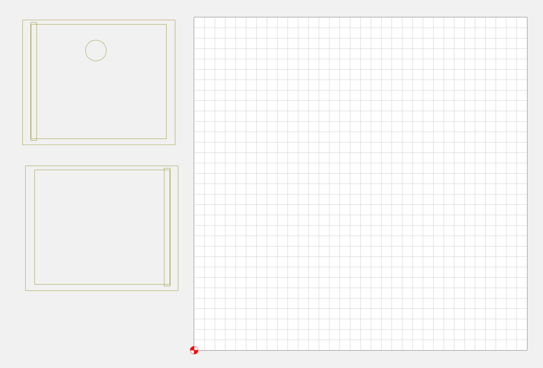

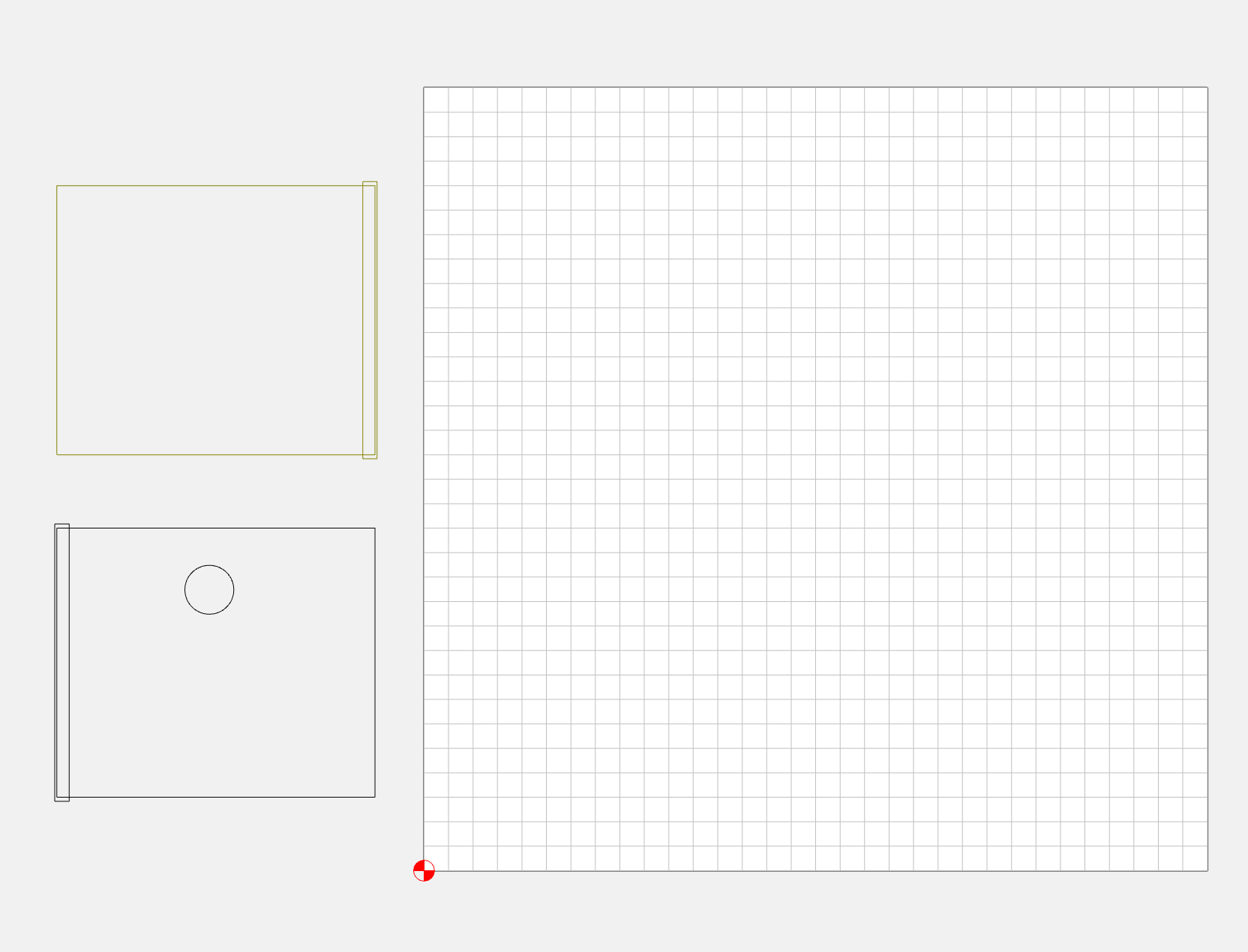

Hi all, hoping I can troubleshoot this one. I do a lot of cabinet parts that require rabbets, dados, etc. I saw the new nesting feature and was excited to try it - but am having an issue with my shapes for the rabbets being moved separate from the part it’s grouped with. I’ll attach photos to better show.

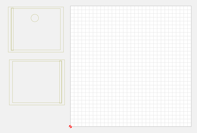

You will need to offset a geometry which fully encompasses all geometric elements of a part in order to have them treated as a single unit.
Ahh, okay, thank you for that. For others this is what worked.

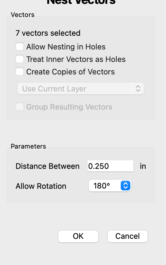

If I kept the selection “treat inner vectors as holes” it kept moving vectors outside of the encompassing vector.
Moving forward I’ll overlay the rabbet geometry after I’ve nested my program.
