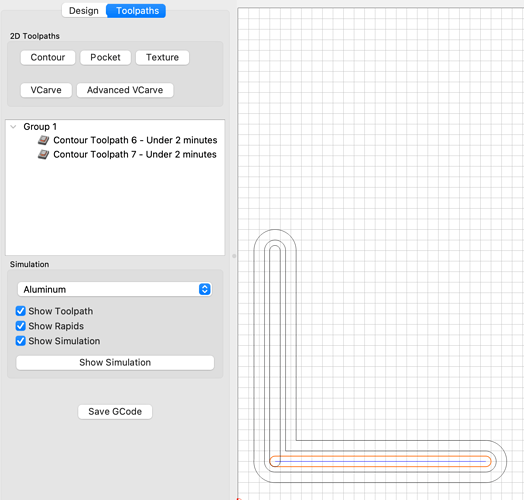

Hi everyone - been lurking for a bit but now I’m a bonafide owner. I received my machine last weekend and got my table built and the machine put together the next day. I’ve done a couple really basic carves, but I’m now running into a problem using Carbide Create.
I’m trying to build some locating jigs to hold my work. The design is pretty simple - an “L” shaped carve out of MDF with a slot down the center to secure it to the t-tracks.
I’m drawing a vertical .25" x 5.5" slot, then copying it, rotating it 90°, and moving it to the bottom of the “L”. For some reason, the toolpath will only generate on the lower (horizontal) slot. What’s throwing me is that the horizontal part is a copy of the vertical slot.
The same shape (oriented horizontally) generates a toolpath using the exact same settings:
Any idea what I may be doing wrong?

Most likely CC is confused by the overlapping — why not Boolean Union the twain?
I tried unioning both at first, but it wasn’t working. I rebuilt the entire design, and even tried toolpathing each individual drawing before moving to the next. The vertical slot still would not show a toolpath. When I copied it and rotated 90°, it worked fine. I even tried copying that horizontal one (with a toolpath) and rotating it 90° - no toolpath.
I hadn’t saved the file because of the problems, but I recreated it this morning. Of course the first one I made worked like it was supposed to, but I’m seeing the same problem after copying it. This file contains 6 of the squares… the fourth from the left only travels halfway down the center pocketing operation then stops.

If the problem is intermittent, then the difficulty is that the dimensions are too close to those of the endmill — increase the width to be endmill diameter + 10%.
That makes sense - is that a general rule you should follow when designing parts? Add maybe a thousandth of an inch to each part so the tool path is generated?
Yes, 10% seems to always work — a smaller value will work as well, but may not in some instances, depends on the rounding is my understanding.
