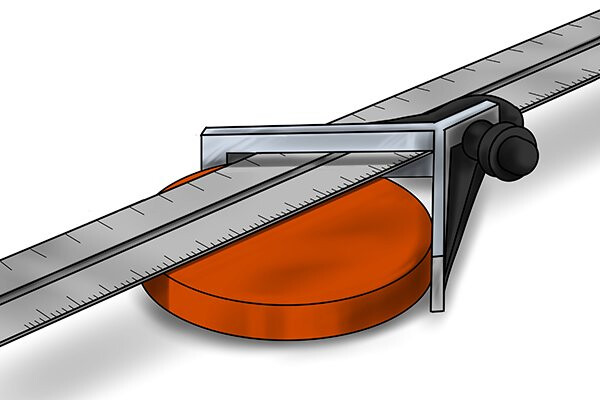

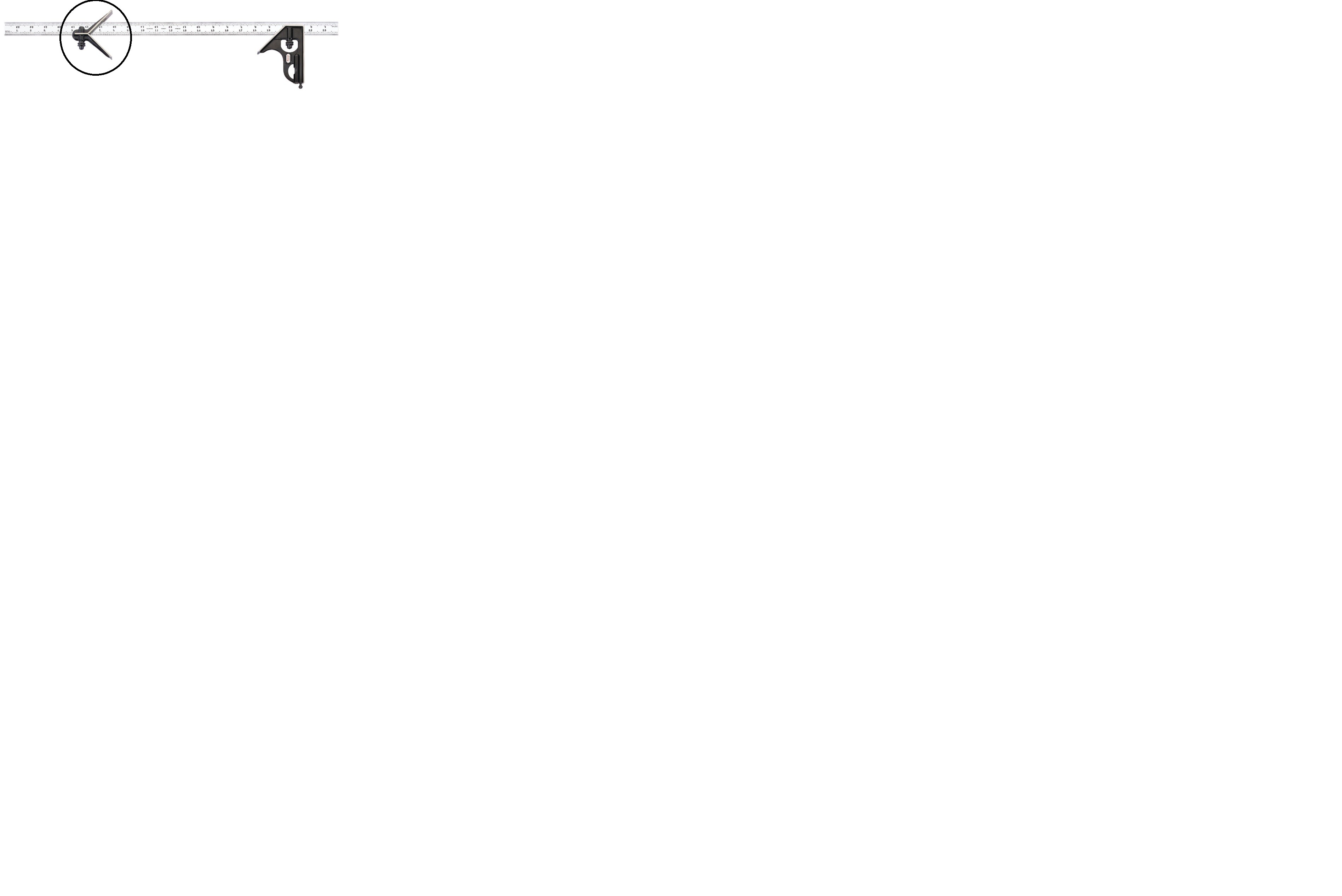

Depending on how big your circle is you can use a long ruler and a 45 degree head to find center. You move the ruler around in quarters and mark at the approximate center. You will develop an X pattern. If there are spaces and not a perfect X in the middle then just approximate the center and mark it. In CC you use center as your origin. You can still use the BitZero to set your Z height on top. For the X and Y just jog to the X mark and lower a v-bit and almost touch the surface and jog until you are right over the center X. Then in Jog menu set zero for X and Y only.

If you dont have the above setup search for how to find center of circle and there are a lot of examples using rulers and/or framing squares to find center.

See:
