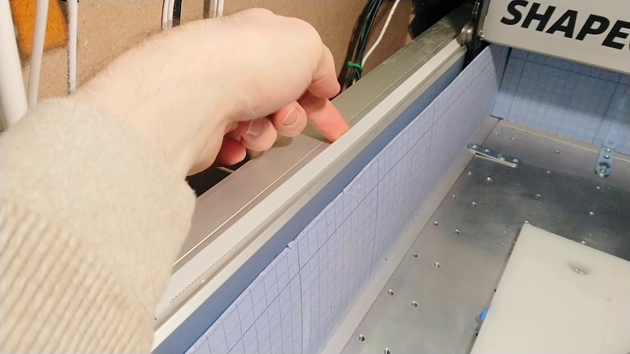

Also, I think @Vince.Fab may have a lead about checking whether both of your Y-belts are tensioned equally ?
I know you said you checked your belts already. FWIW, here’s how tight my Y belts are (this is on my tiny SO3, I cannot slide a finger under it with the gantry pushed all the way back and lifting it in the middle, and it goes twaaang. it won’t be exactly the same on a XXL, due to the longer belt length)
