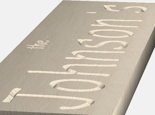

Working with 3/4" pine. Simple name sign. 0 start, .10 depth, #301 V. Toolpath 1, V carve. NO simulation. Done this b4, confused now. Bummer

Edit your toolpath. Sometimes the toolpath is empty.
Pls forgive my density. I updated, re-made file. Like the ruler edge.
Chose v-bit, depth etc. Shows cut lines etc, but still no simulation.

You sent the G-Code file — to get a 3D preview out of that you would need a third-party program — could you send the .c2d file? The one you’d load into Carbide Create?
the Johnson’s-1.c2d (393.5 KB)
First thing, doesn’t look like the update was installed.
I don’t see any toolpaths, but that may be because of the update needed.
I’ve updated CC more than once a day while they’re fixing things.
Your file says, “build_num”: 530
If I add the path you describe, I see this
