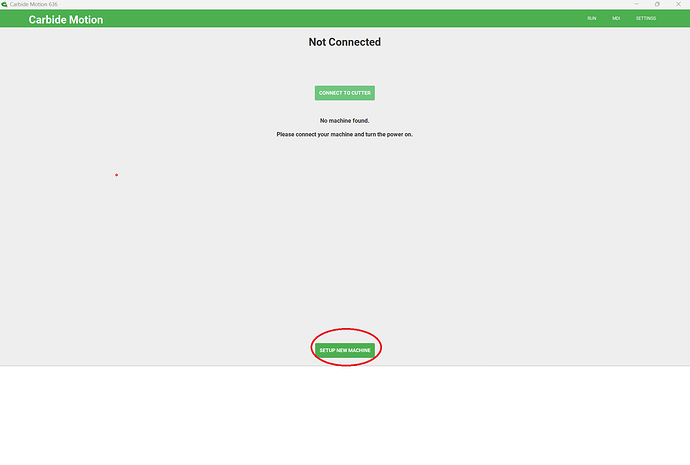

What are the max travel distance for nomad 3 pro of x y z? I might’ve reconfigured my settings so I need to know if i got the right value because im receiving error 1 and 2 during jog mode.
If you start CM and initiate a reconfiguration that would set your travel dimensions to the default ones.
okay thanks for that, Fixed all my solutions. It’s been a couple of days haha
