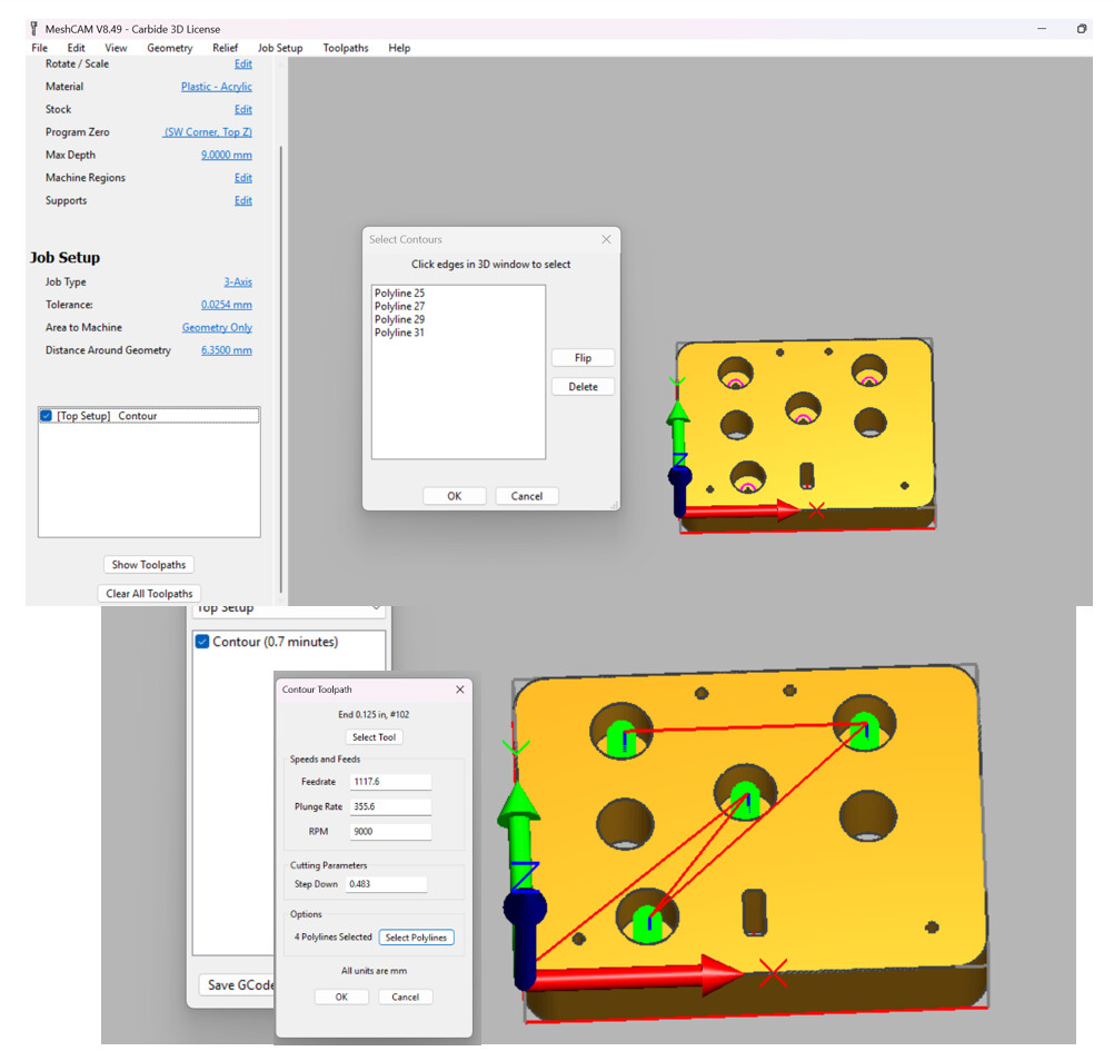

Nomad plunging to full cut depth to start contour
Hi, I just started using the Nomad 883 PRO and I am encountering an issue where the machine is plunging all the way to the bottom of a contour to start instead of cutting from the top and stepping down by the depth of cut. The specific path it is taking is drilling directly into the material to the bottom of the contour then returning to the top where is cuts one pass at the depth of cut then returns to the full depth drilled position then it returns to the top and cuts another pass. This is a problem as I’m sure you know the endmill is not meant drill and is creating enough friction to stall the motor. I am attaching some images of my settings in MeshCAM. I’ve verified that my zero position is correct. Please let me know if anyone sees where I am going wrong.
Thanks,
