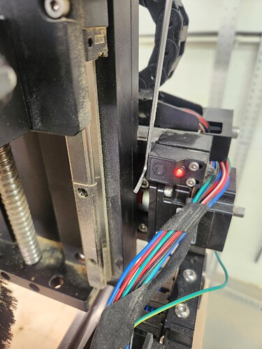

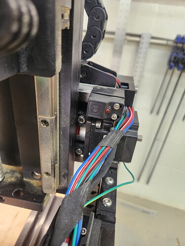

I was running my shapeoko 5 for a few hours making a pocket. It messed up so i stopped and initialize the machine. It makes an odd sound when homing. It never sees the X axis home and fails initialization. I can put a piece of metal next to it and the light turns on.

I can check but it retracted fine. Then y is good. Just cant get far enough right to home the x
Is the leadscrew okay? All the hardware on it in place?
Write in to support@carbide3d.com for a movement guide and troubleshooting instructions.
@overkill
Do you know if you can move the X axis (machine down-powered) any further closer to it associated limit switch? Or is it physically at its stop?
Try down powering the machine, slowly move the X axis to its midpoint then do the same for the Y axis. Power up and reinitialize and see what it goes.
I had those events not just once. The light on the sensor itself reacts, but the according light on the controller board does not, check that out. Sometimes even a light of another sensor on the board reacts: long story short: might be the contoller board. There are just some bad batches out. CC service guys react fast and without further ado.
I was able to move the machine manually into the space so the sensor could read. The last inch did require a lot more force.
I did some maintenance and added lube to the guide rail berings.it seems to be bertter now and i can home the machine. Im going to run another project and see howbit does.
