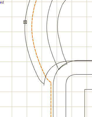

for some reason the sim doesn’t show the tabs.
test bear.c2d (1.7 MB)
You have overlapping vectors, and the tabs are on the ‘other’ vector. I moved a couple of things, the highlighted vector is the one the toolpath is on.
