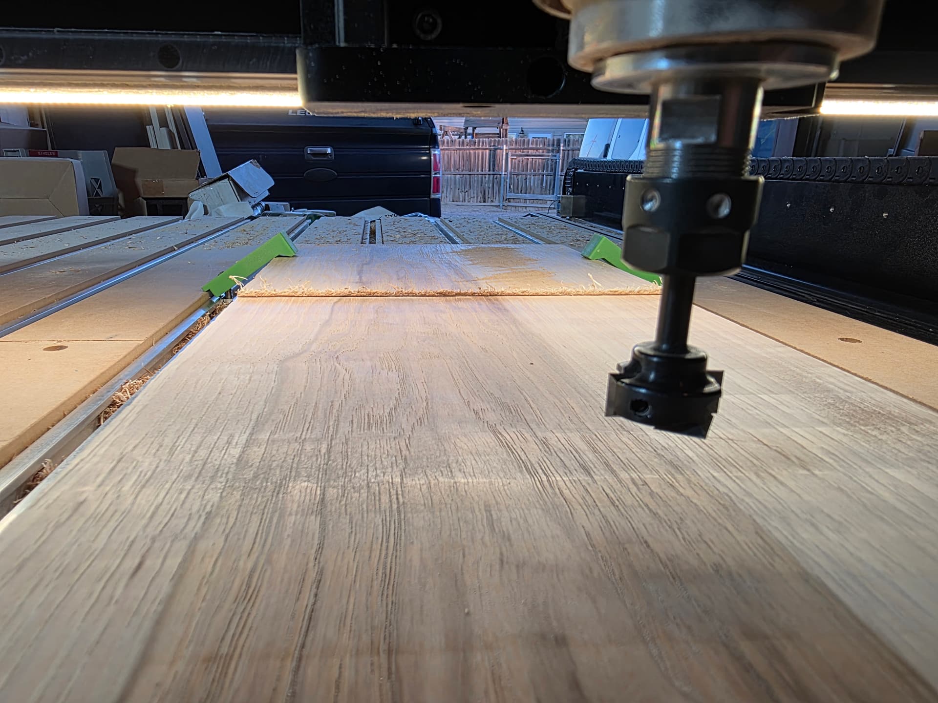

Oh, this cant be good? - gantry wobble
I was getting frustrated with a cut i was coming out inconsistent, then I happened to reach up and it did this, forgive me i’m still pretty new. But i’m pretty sure this isn’t supposed to be this way.
Does anybody had this happen? Potential fixes?
Appreciate yall

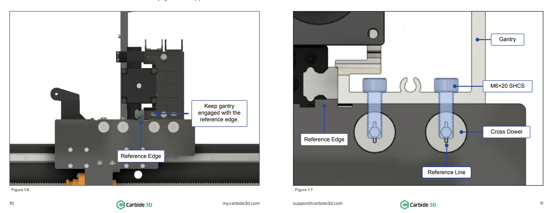

Looks like you gantry is loose so perhaps try tightening the M6x20 bolts on each side (ref. page 11 in the assembly manual)?

You are right however, thats not good. Agree with Sindre.
Yep, that is the problem, fixing it now
But now fixed! Thank you and thank you to mh father in law, for giving my wife a set if low bend alllen wrenches, so all I had to do is pop a the cover move some wires and double check that everything was tight, both sides
Thank you so much for this fix its cutting better than it had before!
