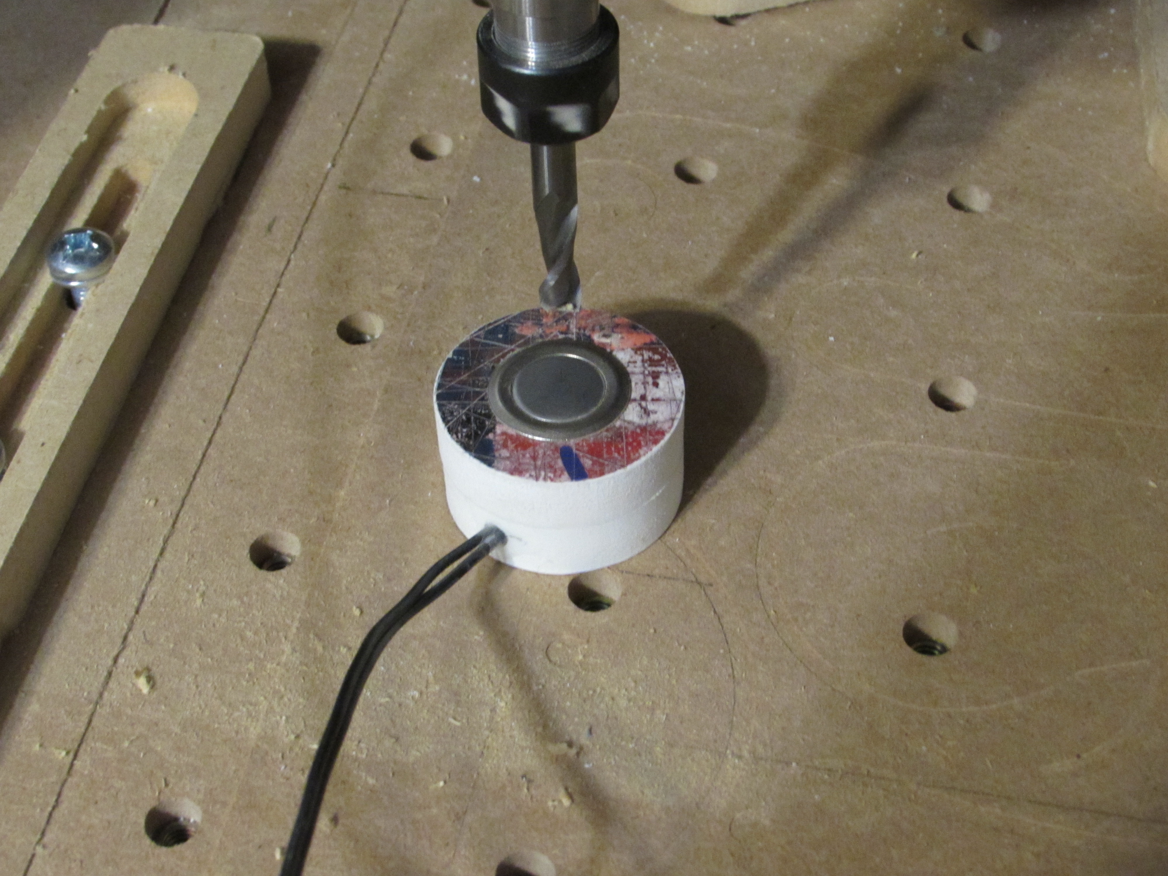

Don’t know if these photos should be here or elsewhere. But It is a simple project I just finished. I switched from carbide controller to a Mach 3 Geko 540 set up because I have over 5 years of files and know Mach 3 very well. NOTHING WRONG with Carbide controller or software I just preferred my old Mach 3 to a new learning curve. The photos are of what I call a one-handed tool probe.
The probe sets in a tool holder above the Z-axis a ready to use and then goes back out of the way. Total cost one used switch salvaged from something I don’t remember what and scrap PVC sheet. It has proven very accurate. ONE LAST thing THERE is NOTHING WRONG with carbide so there is no need for a flame war. This is just a tool that makes my CNC life easier.
