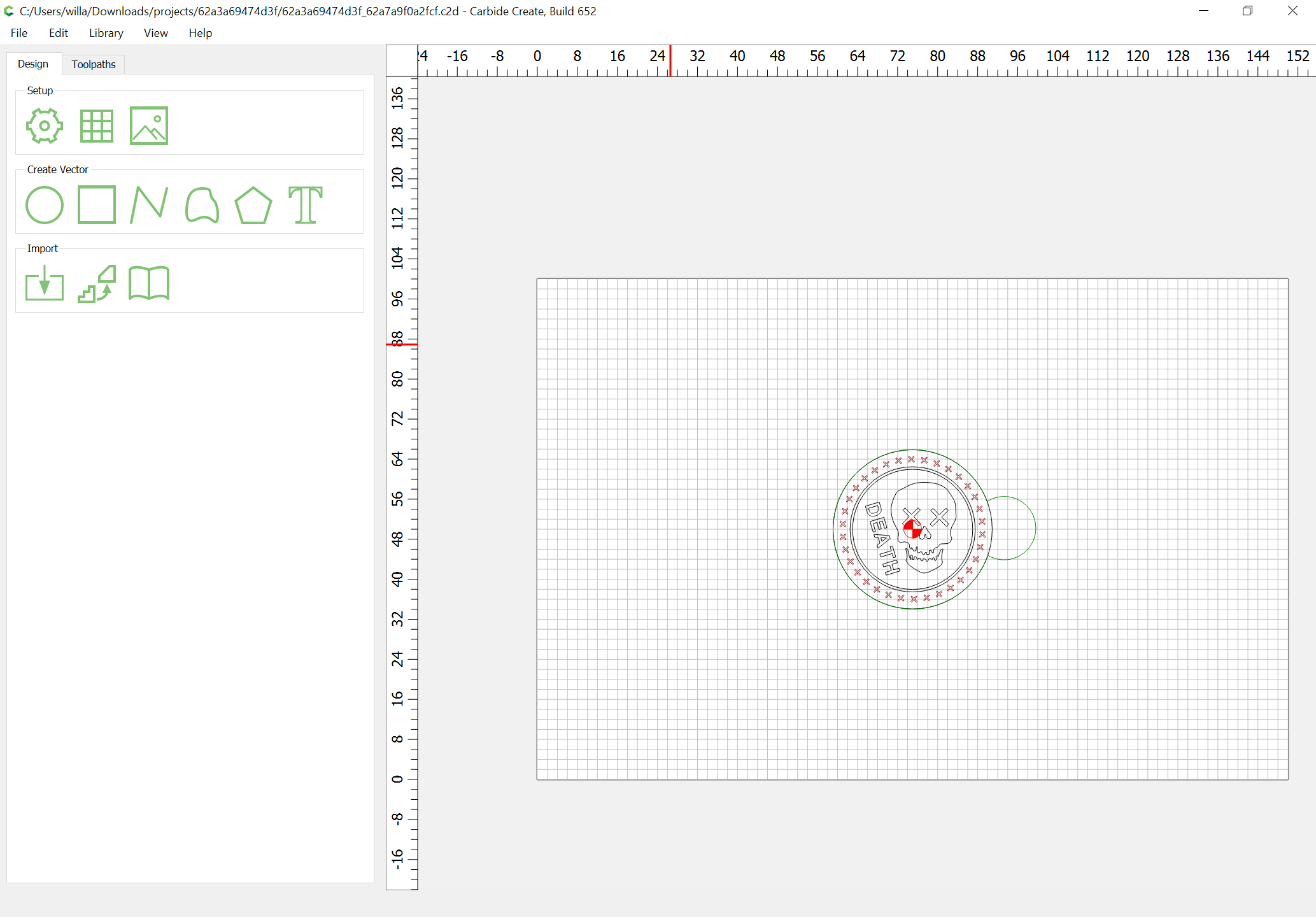

Still learning all I can about Carbide Create first before moving to 3D PRO.
In the above YouTube there are in the description files to make the coins (Creating Coins with Desktop CNC - YouTube). They are just 2D creations but for some reason I get errors saying I need PRO.
Would anyone let me know what I need to do?
Thank You!
Each design should have two different copies, one which requires Pro, another which doesn’t — if you continue to have difficulties opening all of them (note you’ll need at least build 524) let us know at support@carbide3d.com
DUH!!! I just checked first and last ones. The even files are opening! Thank You!
