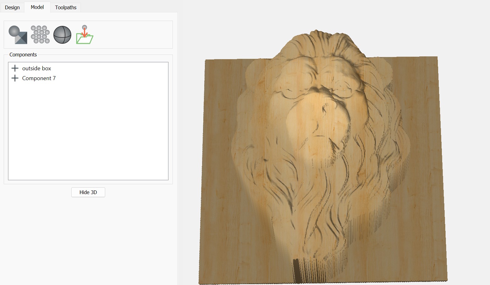

Here my workpiece is 8.6 x 12 x 1". I created a flat component 0.45" thick, then imported the STL at 1" thick and used the Merge Type: Max. So the portion of the STL I don’t care about is buried in the background block.
First off let me say I love it! That is the detail I’m trying to get to and maybe just a little more height/depth to showcase the face from the base.
That said, I have no idea what you are saying as to how you got there. I do know that if I establish the material thickness as 6" and the depth of cut on the STL as 5.5" I get the detail I desire, at least in the model tab, per the attached.
However, when I do a rough and finish cut, even down to a 1/32" ball bit, the detail pic in the simulation does not get the same detail. I’m guessing that is because it is using the 3XXL spec and knows it can’t handle a 6" slab.
Any way you might break you explanation as to how you got to your simulation, in smaller bites that I might be able to follow? Sorry, I’m just trying to learn as fast as I can, and certainly appreciate your help.
I got it. Followed your description one step at a time and looks like I’m getting there.
