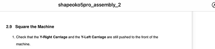

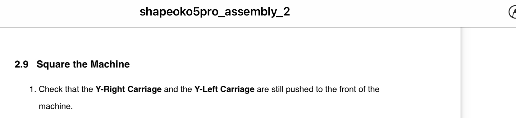

No, because the assembly instructions said (Square the Machine- pg.21) to square it up by starting with the gantry in front and tighten front screws then move to middle and tighten screws then move gantry to rear and tighten rear screws. It said nothing about any measuring needed.

The problem was the stupid manual that said “don’t worry about square yet- we’ll do that in a subsequent step.” One simple sentence would’ve saved me unscrewing 109 screws and then putting them back again.

This step is to ensure the YR and YL rails are even with the gantry located all the way to the front of the YR/YL. At this point the gantry should have touched the front stops on both YR/YL rails. If this was the case you would not have had the 1/2’ delta in the rear as you described, sounds like you didn’t verify the front or back position to be against the stops as you completed your assembly.
