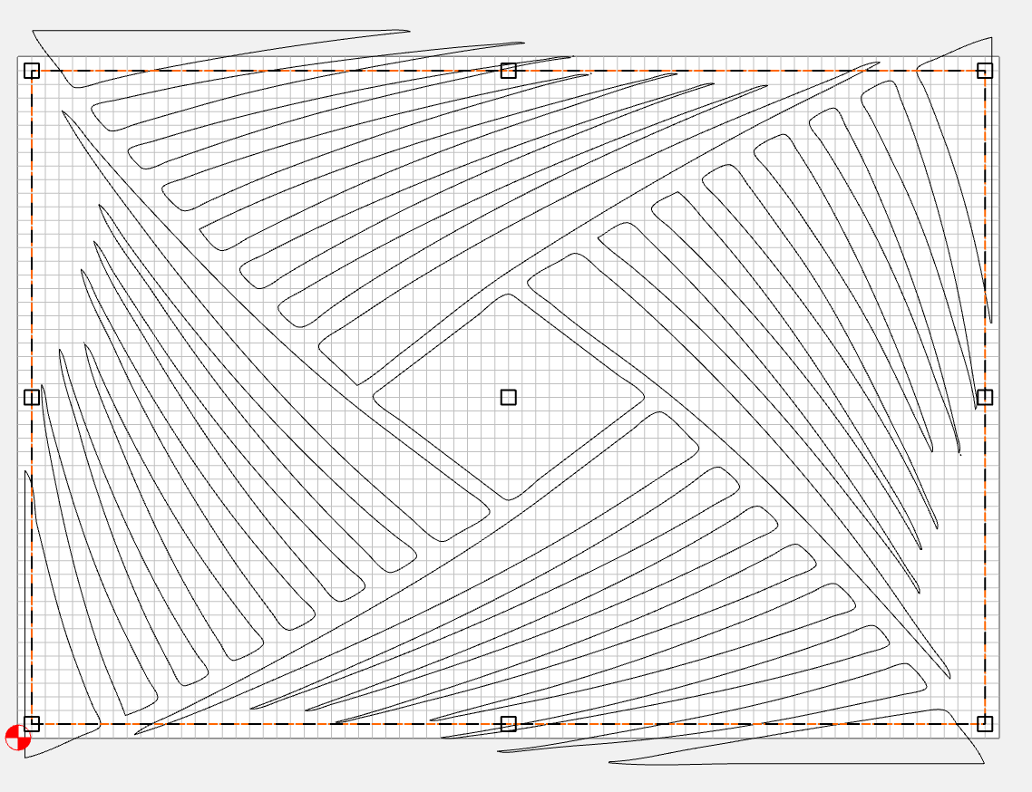

Ok guys I am trying to use an oversize image on a board of a particular shape but I do not want to stretch the design because of distortion. Does anyone know how I can trim the design shown to only select, weld, etc. to the size of the rectangle shape? I have tried the boolean feature but all I have accomplished is cutting out the center when in fact I simply want the opposite to happen. Thanks in advance!
This is exactly what “Trim Vectors” is intended for:
Note that you will then want to follow it up with “Join Vectors”

Thank you that was a huge help. It is much appreciated.

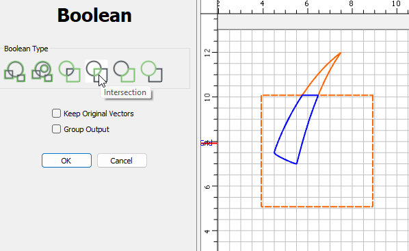

I think the boolean operation you’re looking for is Intersection.
But learning to use Trim Vectors is a good exercise as well, and you can select all of the vectors & do them at once.
