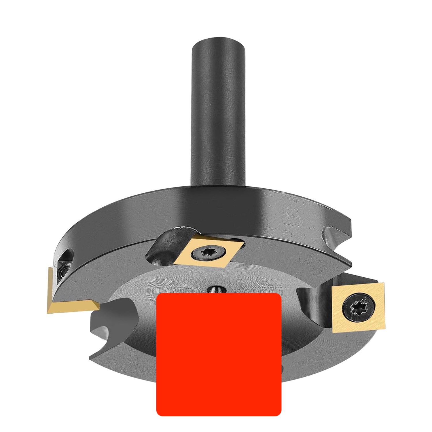

So I’m looking into an oversized surfacing bit for quicker surfacing. I’m talking about 3" / 75mm.
To be precise, this beast: SpeTool 2+2 Flute ATS Coated Insert 3" Dia 1/2" Shank Flattening Bits
Now I realized that the bitsetter diameter is too small and will ‘disappear’ into the indent of the bit. See below:
I saw there’s an option in Carbide Motion to (temporarily) disable the bitsetter for the facing operation.
So is the way forward simply this?

I also read somewhere about putting a larger disk over the bitsetter and subtracting the height of that disk from your Zero, but I don’t see any advantage of the bitsetter for only a surfacing toolpath anyway?
I think the idea of a larger disk is to leave it on for all tools & set your zero normally.
The height is arbitrary, and is only used as a reference to determine the difference in tool lengths.
FWIW, my bitsetter has been in a drawer for a couple years. I just output paths by tool & set my zero manually.

One solution that I have come up with is to do the new machine setup with the bitsetter off center to a ¼ bit. Once this has been done when I zero the surfacing bit it will now touch off on that edge that has the cutters on it.
⅛ and ¼ bits have not had a problem with being off center.
Nice trick indeed. The bit doesn’t have to touch the bitsetter exactly in the middle I suppose, if the knob is not pressed down in an ‘angled’ way. You didn’t had any problems with cutting heights/toolpaths being off?

If you disable BitSetter, you must reset your Z zero every time you change the tool. When you reenable the BitSetter, you must reset the Z zero again.
Just follow that, and you’re good.

It started out as me loosening the bit setter and sliding it over just a bit when I needed the surfacer. Then later I was cutting a large sheet and needed the clearance. So I reset it.
I finally realized that I could simply position the bit to the zero point (or use the probe) and with a thin 1/47" fender washer resting on the Bit Zero button, let it use that. Quick and certainly close enough. When done with the surfacing bit, stow the washer and re-zero as usual for normal bits.

I use the McFly, I leave the bitsetter enabled (SO 5 Pro), run the program, after the tool is measured, I remove the bitsetter from its location while the machine is flattening the wasteboard. Depending on how you set up your toolpath, you should have plenty of time to remove it. You can also remove it after the tool is measured and before you turn on the router and hit enter.
Since the wasteboard surfacing only uses one bit, it’s not a big deal.
After I am done facing the wasteboard, I reinstall it.
