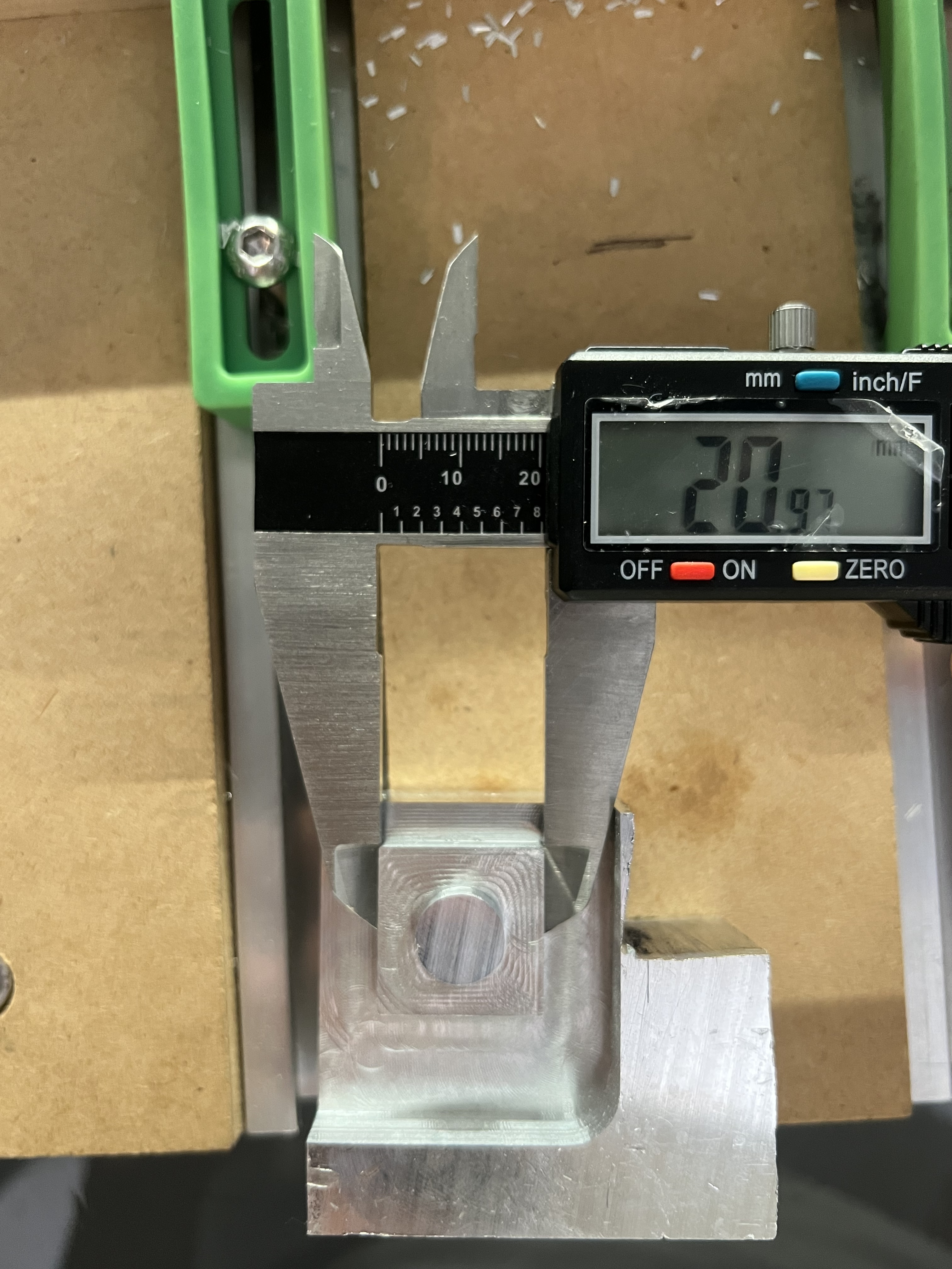

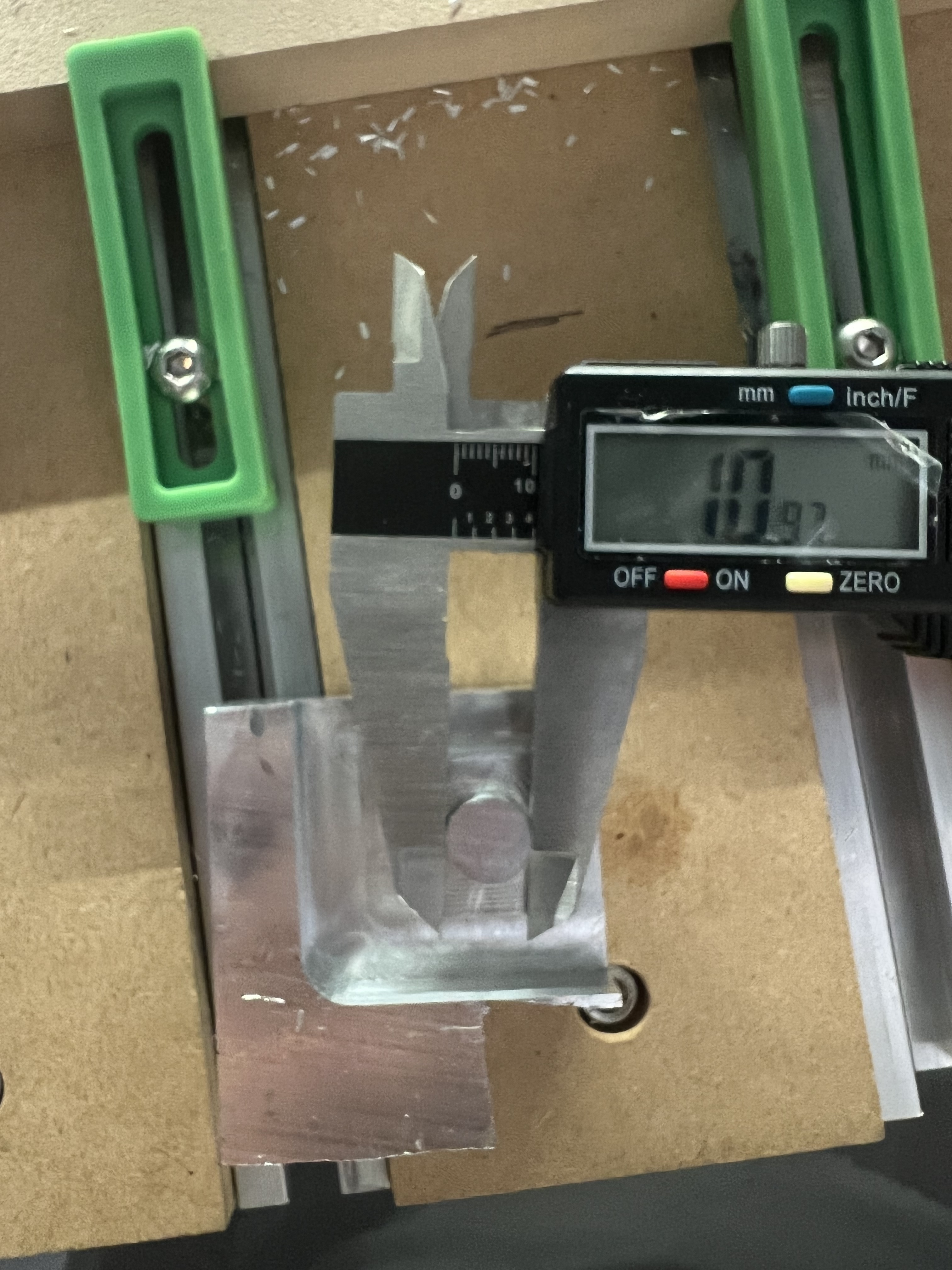

I ran a square and circle test in aluminum on my HDM, the square is 20x20mm and the circle has a diameter of 10mm. The results were pretty much exactly 1mm oversized. I used two 2d adaptive tool paths in fusion 360.
I read a possible factor was tool deflection. My speeds and feeds were:
1/4 Zrn Carbide 3d endmill
22k rpm
2000mm/min
333mm/min ramp/plunge
0.5mm optimal load
2.5mm max step down (high?)
Is it likely tool deflection or a mistake in my CAM? I did a similar test in mdf and had no issues.
Have to ask. Did you have any “stock to leave” set in your settings?
I agree with Neil. this looks like Fusion360 stock to leave… as it’s set to 0.5mm by default and on by default … 0.5mm x2 sides = 1mm oversize (or 1mm undersize if it’s a bore … ask me how I know … )
Yep, that was the issue, 0.5mm stock to leave. I’m pretty new to metal milling in fusion, I probably had this on the entire time cutting wood because I never bothered to measure. Thanks!
