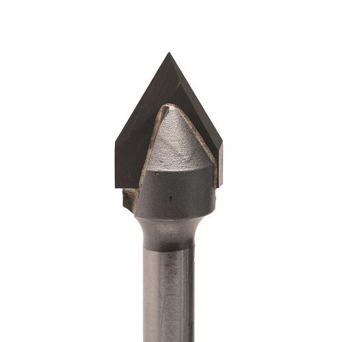

I have a small pcb project i would like to undertake. I have used vinyl mask cut with my silhouette curio and pcb etching fluid but transfering thin lines is such a pain.
Im trying to avoid buying bits specifically for pcb as it is something I rarely do. Is a regular vcarve bit ok to use? What is the difference between an engraving bit versus a vcarve bit?
I guess i could also adhere vinyl directly to the pcb and then cut it on the curio but i would prefer to use my newfangled machine.
The bit i own
https://www.amazon.com/dp/B0C6DZYF4B

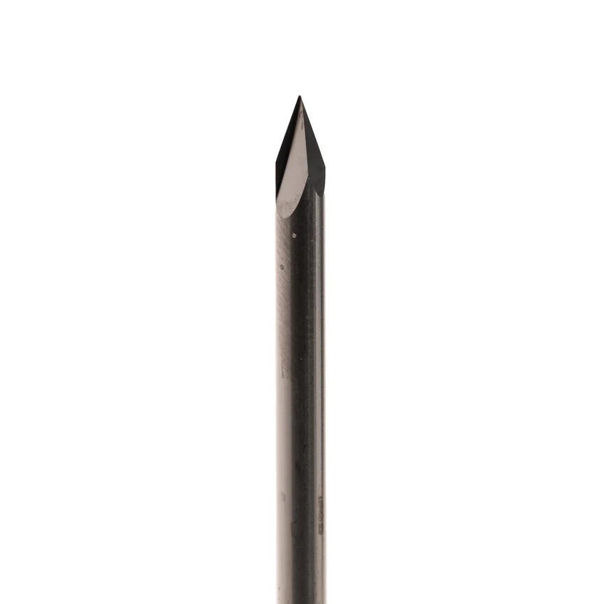

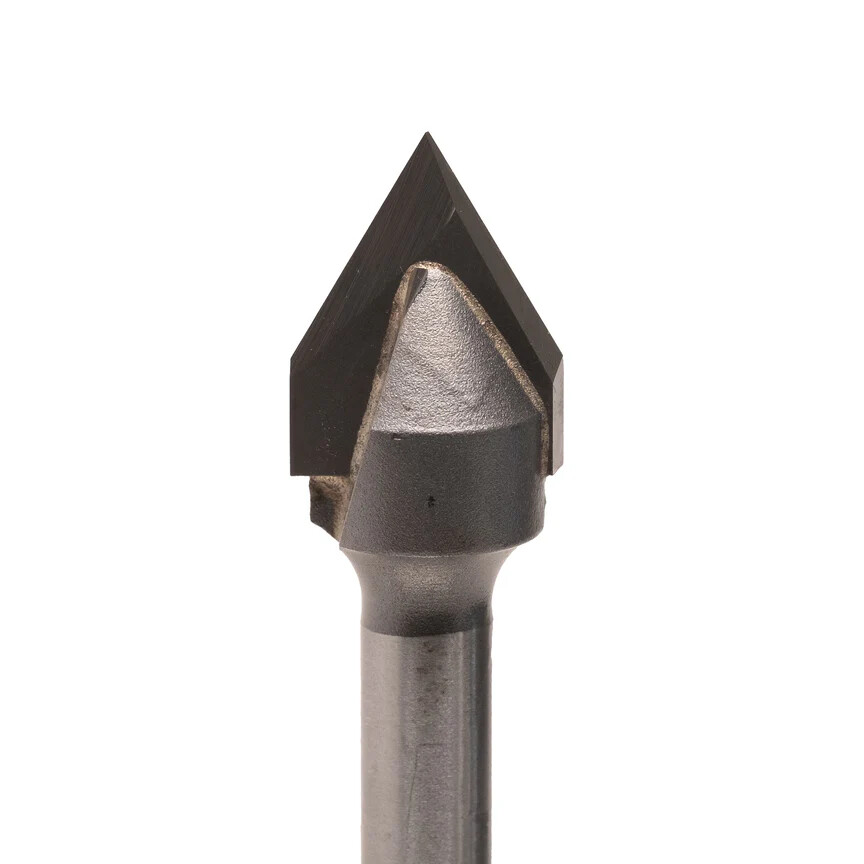

The engraving bits are narrower than the vee bits. As the name implies the engraving bits are good for etching things vs the vee bits which can make a wider path and deeper. As far as operation they work the same.
Here is the profile of the 60 degree C3D bit.
Here is the profile of the engraving bit.
