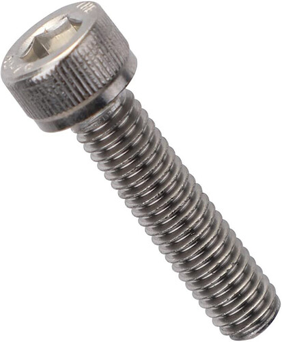

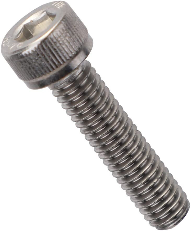

Many people replace the tiny set screws (3MM) with 3MM cap screws that are about 10MM long. The cap screw has a bigger head so is less likely to strip out.
