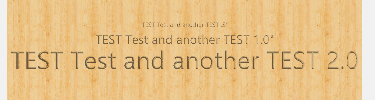

I am using the Zniko font … not quite a single line font, but it should be close enough. I have set up test programs with a variety of bits, different font spacing, different font heights, different depths, different toolpaths, etc. After many runs, I thought I had a handle on how things are working. My last run took that all away.
The Zniko font has been giving me the best results. Font heights I have settled on now range between .25 and .4 inches. Font spacing of 120% looks good. Cutting depths are being tested in the range of .04, .05, .06 and .07 inches.

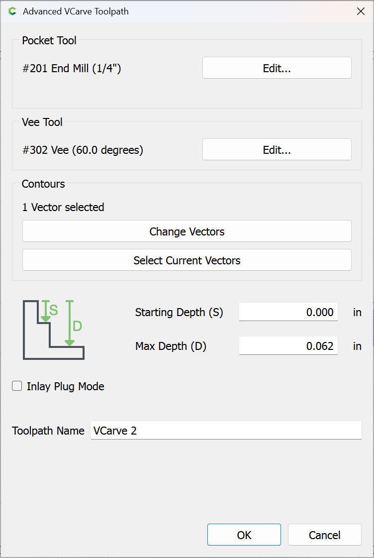

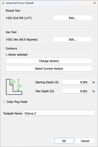

I am aware the VCarve will automatically select the proper depth (based on the letter width and V-bit angle) as long as you specify bottom or near bottom for the stock depth. No problems there. BUT, I was under the assumption (based on research) that if I use an Advanced VCarve by selecting a pocket end mill tool (say 1/4 inch) that is bigger than will fit, that endmill will not be used but the V-bit will carve to the depth specified since the endmill and Vee bit would need to be at the same cutting depth. That did NOT happen. The pocket carve portion came up as EMPTY TOOL (as expected), but the depth of the V-bit did NOT go as deep as expected. In fact, all the depths turned out the same. It seems now that if the pocket cut is NOT valid, that the carve defaults to a regular vcarve. I need the Vee bit to go to my specified depth! How do I do that in an advanced vcarve?
I also tried a contour path (no offset) with 30 degree vbit and while the depths did change, the results were not satisfactory. I have also tried a 1/16 straight bit but that bit was too fat. I am hesitant to go to 1/32 straight bit due to breakage concerns.
In my latest test, I also tried the 60 degree V-bit again with an advanced vcarve, and the depths did slightly change, which is really strange since I would have expected the 60 degree bit to not find a depth deeper than the 30 degree bit.
Can someone please explain to be where my understanding of using an end mill too big in an advanced vcarve will NOT allow me to specify a specific depth of cut. And my understanding of vcarve and advaced vcarve is leading me astray?

If I was using an Advanced Vcarve to carve a pocket in a regular design, my understanding is that I would use both a flat end mill plus a v-bit, and that the depth that I would specify is the depth that would be used for BOTH cutting operations to keep them aligned. To try to force a specific v-bit depth, I used advanced vcarve with both a flat endmill plus the vee bit at a specific depth. But in my case where the flat endmill was too large for the pocket cut, carbide create appears to neglect my specific depth of cut. I have seen other users specify their cuts in this fashion. I will revisit them again.

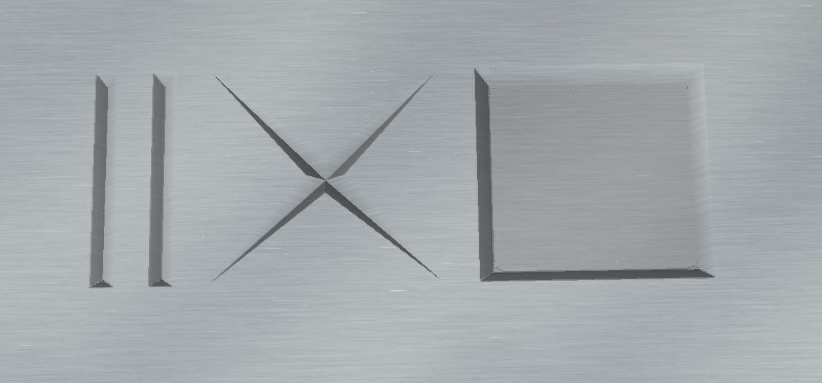

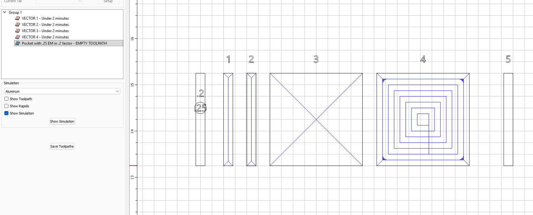

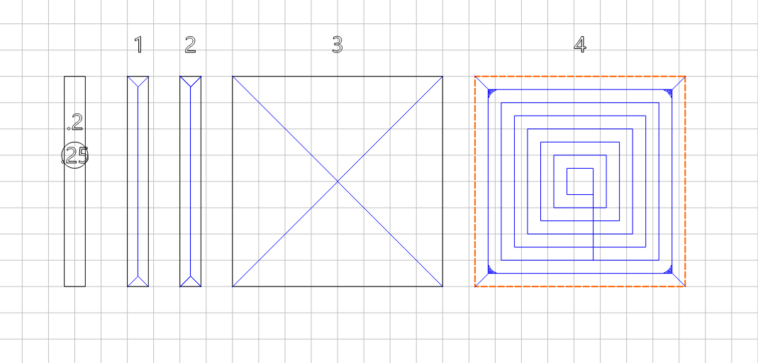

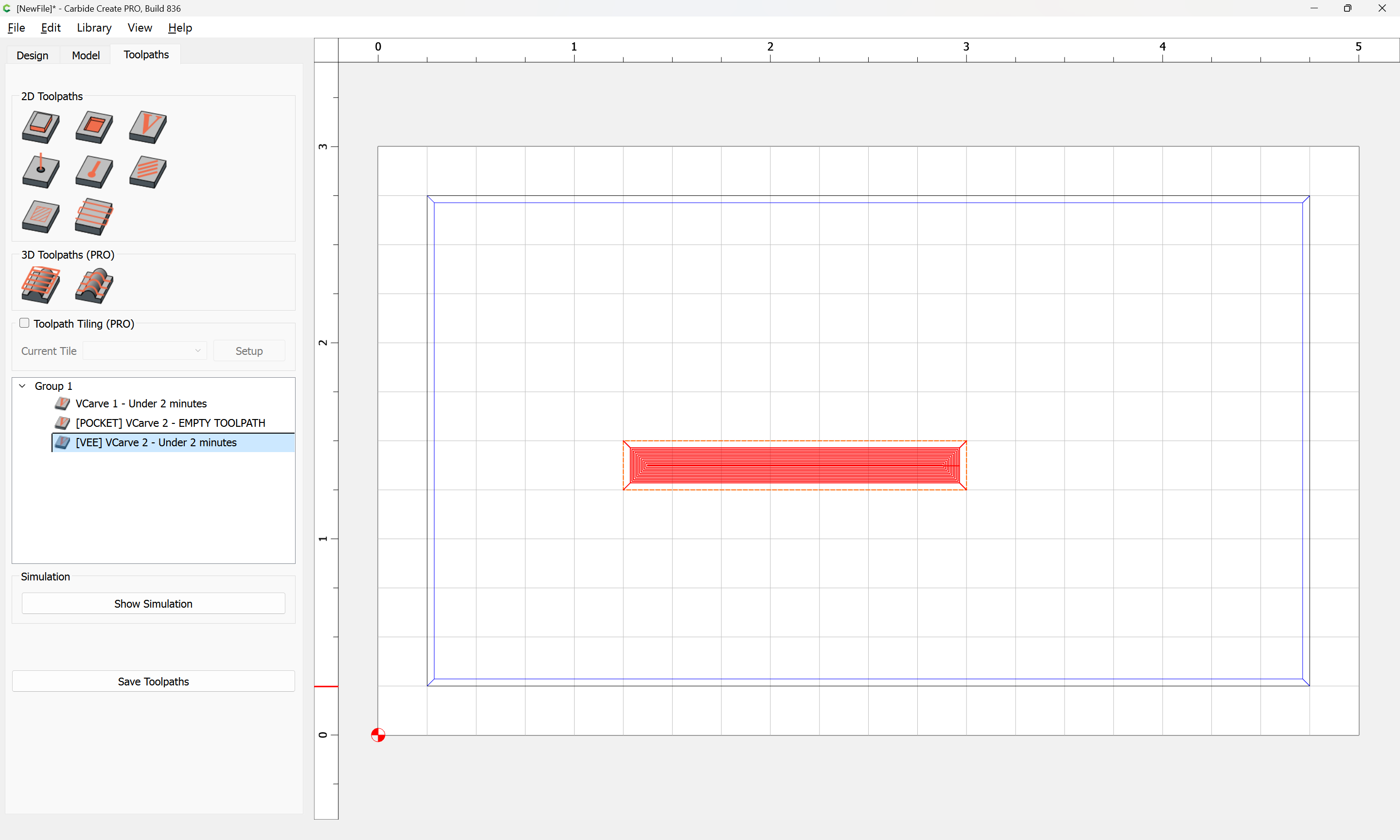

If the Vector width is narrower than the EM width, the program will not cut anything. In this imag,e the Rectangle has a width of .2 and the EM is .25. The end mill will not cut anything because it can’t “fit” within the bounds of the Vector.
A V-Carve only uses a V-bit to carve the pocket. IE, no flat bottom.

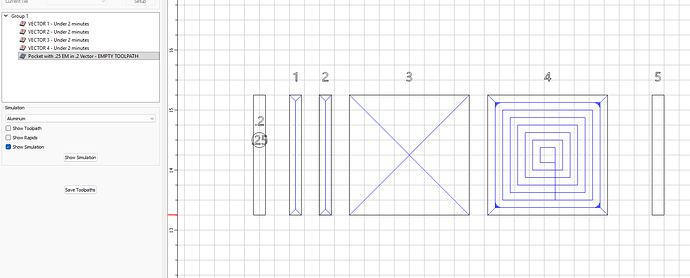

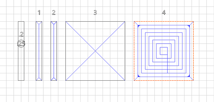

Take a look at the vectors below. The toolpath for 1 is an advanced V-Carve, but since the vector is narrower than the EM, the EM is ignored. Toolpath 2 is a regular V-Carve, with a narrow Vector; everything turns out just fine. Now Vector 3 and 4 are 2" x 2". This is where the V carve vs the Advanced V carve can be seen. #3 is a regular V-Carve. Notice the toolpaths and compare them to #4, which is the Advanced V-Carve.
Simulation:

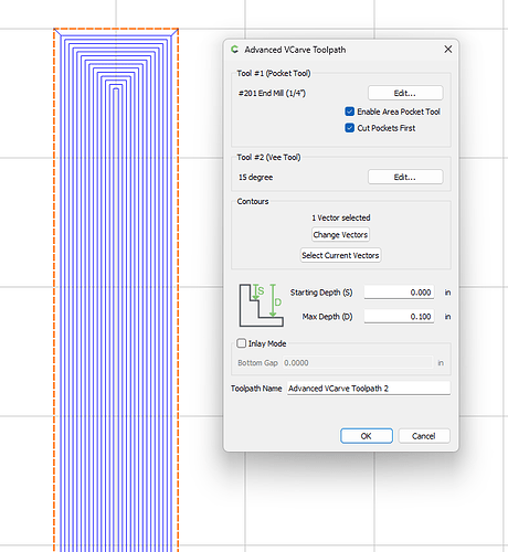

Vector #5 is the .2 x 4" Vector using a Pocket cut and a .25 EM. Notice the toolpath says “Empty”
V carve vs Advanced V Carve.c2d (104 KB)

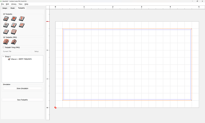

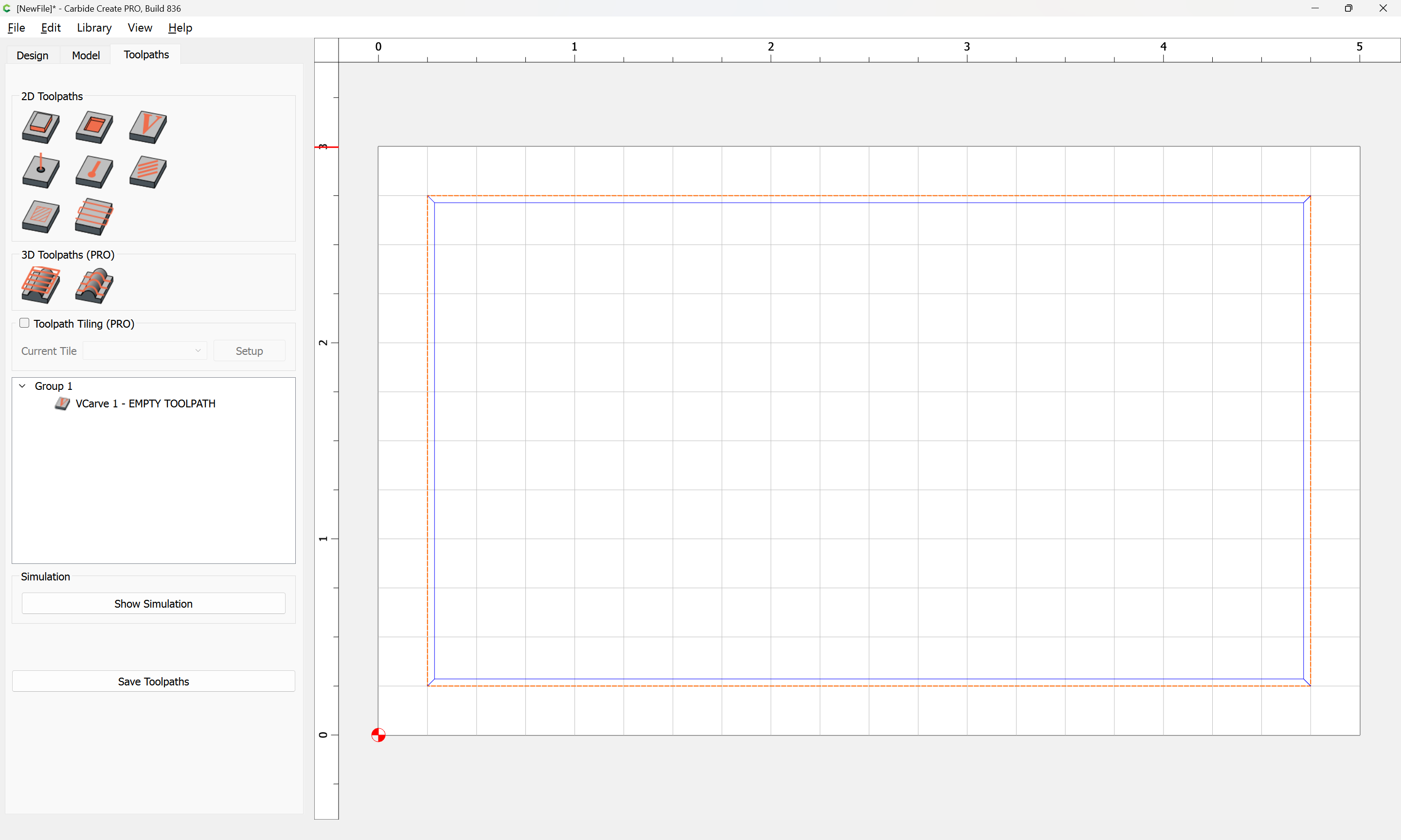

Thanks Anthony … I agree 100% with what you posted … and that much I do understand. I am getting EMPTY TOOLPATHs … I was expecting that.
Let’s look at your #4 above. In that Advanced VCarve, both the flat endmill (for the pocket cut) and the V-bit cut should have the same depth. Correct? Otherwise there will be lines on the bottom. Now assuming that they DO have the same depth that I specifed in the toolpath, then IF I create an Advanced Vcarve with too big a bit (ie, an EMPTY TOOLPATH results), then WHY does the Depth that I specify in the Advanced VCarve gets IGNORED for the V-bit portion! That is where my concern is. The V-bit bottom point and the flat mill should be at the same depth. But if the flat cut gives an EMPTY TOOLPATH then WHY is the VBit cut appear to revert to a simple Vcarve.

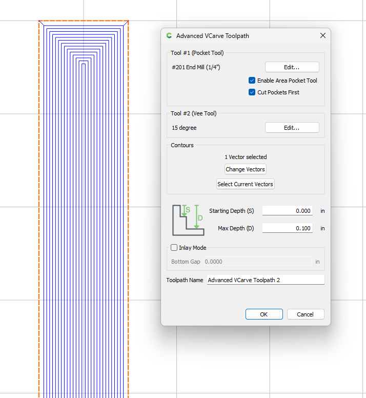

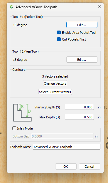

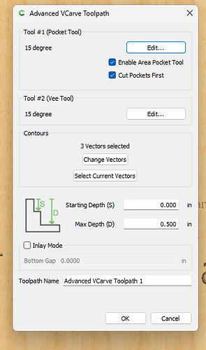

The max depth should be the same regardless of whether the EM is too wide to fit in the vector. To verify this, you can use the same V-bit as your clearance tool. BTW, you will get a little warning that the V-bit produces an inefficient toolpath, just click “ok”.
That should not happen. Here is a screenshot of a .24-wide vector and an advanced V-Carve; the toolpaths are for the 15-degree v-bit.

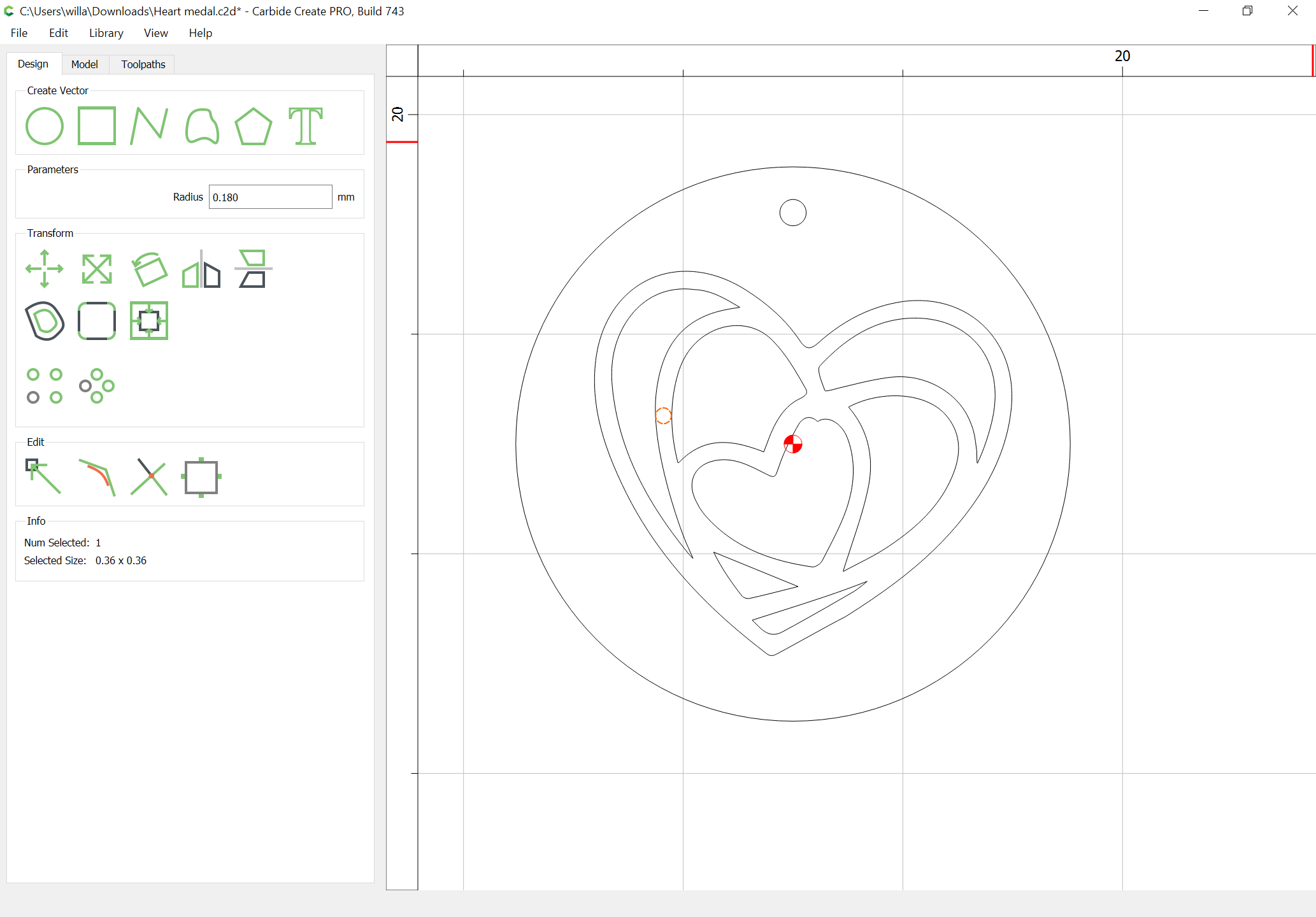

Will … I have seen you post that many, many times … unfortunately some of the steps go beyond my experience with Carbide Create at this time … another way for me to say this is that I’m not smart enough with CC to understand the detailed steps.
I can write the text … I can convert the text to curves (I assume you group the vectors?) … I don’t know what you mean by “Draw in geometry at the narrowest point” … once i understand what that means I can try setting the inset … but right now I am stuck.

Draw in a circle at the narrowest region:
Basically, keep increasing the inset until things break up — when that happens, back off.
Or, start with a too large inset, and reduce until it results in a solid/continuous interior line.
