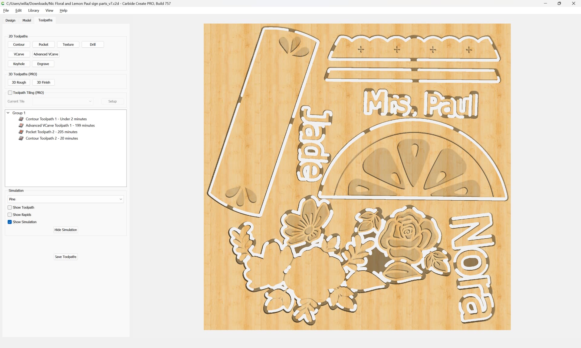

I have attached my file for pieces that I need to cut out to put on wooden circular signs. First off, If I put too much on one piece, I can take some off. Just trying get the most out of space. I know I will probably need different toolpaths but I am still so new and reading so much but I kinda need my hand held in the beginning.
1-A CNC friend told me he cuts names and shapes out with 3/4" MDF stock. So that is what the stock is here. Do yall agree with this or have another stock suggestion after I use this MDF?
2-I need help knowing what toolpaths to use as well as the feeds and speeds. As all, I want to use whatever creates the best product in the shortest amount of time.
I really want to learn but am appreciating your expertise more than you know! Lots to learn here!
  1. If you’re painting the MDF and it won’t be in the elements then I think it’s perfectly fine for signs.
  2. Have you tried cutting anything yet? If not, you might want to start with just one thing. Keep it as simple as possible. What software are you using? I ask because most software will have basic videos to learn about toolpaths. They’re really helpful! Information about your bits feeds and speeds can usually be found from the company you bought them from.
    I’m brand new too. Just started under two weeks ago. I researched as much as I could then found help here on the forum. Good luck to you! The CNC world is very frustrating and exciting IMO! Lol!
I put some toolpaths on this project. I do not know what look you are going for so I took a few guesses.
With Tool Paths.c2d (808 KB)

I added Tabs to this one
With Tool Paths.c2d (816 KB)
