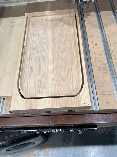

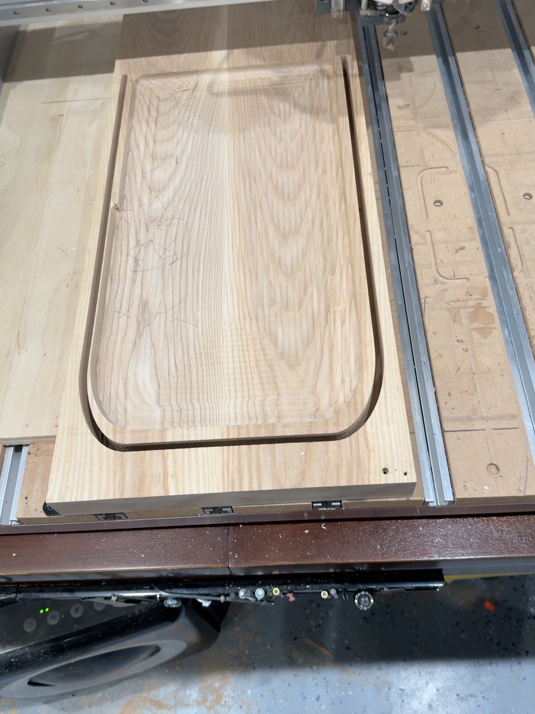

I tried the cut and unfortunately had two problems bad enough that I had to rebuild the piece. I’m attaching the actual .c2d file I ran and a few pictures. If anyone is willing to open the file, make the changes you would recommend, and upload the revised file back, that would be extremely helpful.
@Ed.E, thank you again too. You modified my file on my first tiling project and being able to compare your version to mine helped me understand it much better.

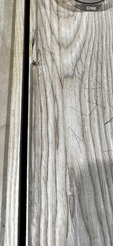

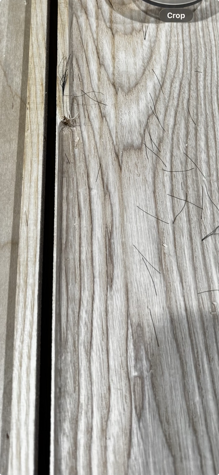

The first problem was the Perimeter Channel Lower – SHARPRO toolpath. I used a #201 upcut for the upper section and a 1/4" SHARPRO downcut with a 2" cutting length / 4" OAL for the deeper section. Because the bit was so long, my Sweepy 2.0 was nowhere near the cutting area. Chips packed into the channel and the cutter struggled/wandered.
I also noticed that the SHARPRO would make one loud pass that clearly removed a lot of material, followed by a very similar-looking pass that was almost silent. The channel was about .275" wide with a .250" cutter. Was the first pass basically slotting and the second only shaving a small amount off the side? Is there a better way to build that toolpath?

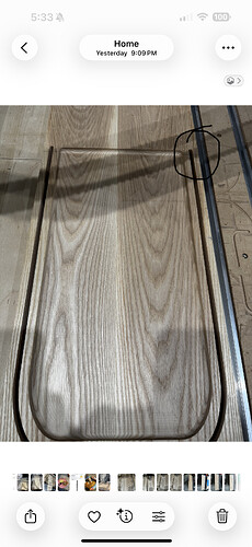

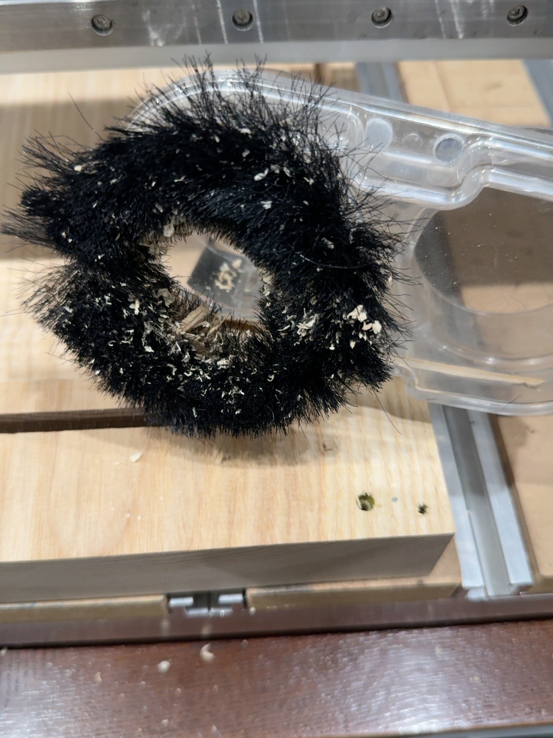

The bigger failure happened while deepening the recess with the Whiteside 1372. I heard a bad sound only when it traveled along the left wall. When it came around to that side again, I realized it was cutting the rim much too thin. I stopped the machine, but the rim was already badly damaged. Afterward I found the Sweepy 2.0 brush skirt had been chewed up.
I resawed the damaged top away, preserved the engraved underside, and glued on fresh ash. Attempt #2 will be shorter and narrower, about 1.5" thick overall, and I now want the recess approximately .800" deep.

The only real advantage of a downcut bit is it sheers the top edge of a pocket/slot downward, preventing chipout & rough edges. Otherwise, the downcut pushes the chips downward into the slot. I would recommend an upcut or even a straight flute router bit.
Try making the slot a bit wider if the chips are getting bunched up in there.
Yes, the cutout path the first pass is a full slotting cut. But if the previous level has been widened, the full cut is only ‘Depth of Cut’ deep, rather than the full depth of the tool.
I always use Climb cut on slots. The tool tends to push the chips behind the tool and not pack them up. This allows the sweepy a better chance at getting them out.
Sweepy is tough when cutting deeper features. I try to set the height of the sweepy so at the final pass the brushes are just touching the surface, or only bending a little bit. Or, set the sweepy even with the end of the tool, let it cut a couple passes, pause & move the sweepy up a bit…
It sounds like the sweepy bristles bot caught in the grain & ripped some bristles out. At which point you likely lost some steps, or the head/spindle/tool pulled toward the wall.
