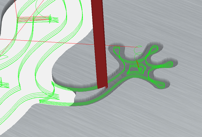

I’m cutting a shape out of sheet metal so the intention is to cut all the way through and I didn’t want to use tabs on this internal shape so I made it a pocket operation. However, in the simulation (and in practice), the REST operation cuts the outline, then moves to the inner “island” to remove that last which of course risks hitting the endmill when it comes free.
Fortunately, I was able to vacuum it clear without any damage, but is there a way to force Carbide to cut the whole area rather than splitting it up into two passes? Or at least do the inside first and then do the outside? Thanks!
I’ve noticed this too. Sadly, at the time no. The internal algorithm chooses the order.
Since pocket has no “Stock to Leave” option, what if you programmed a pocket rest mill with a slightly larger tool, then come back & profile (contour) the edge with a finish cut?
i.e. You pocketed the larger area with a 1/4" tool. Then create a 3/16" tool to program the rest mill with a 1/16" stepover, but use a 1/8" tool in the machine. Then use the 1/8" to do a contour cut in the area the 1/4" couldn’t reach. ???

While I can think of a few work arounds, part of the reason I purchased Carbide Create Pro was that it is generally faster for 2D workflows. I’ve been able to do this in Fusion 360, but the setup time is higher. If I have to do additional tool changes, then I might as well just spend more time in the setup.
To clarify, I wasn’t suggesting an additional tool change. Just programming the path with a slightly larger tool in CC to keep the actual 1/8" tool away from the edge. Still using the 1/8" tool on the machine for the Rest (rough) & Contour (finish) operations.
Ah… gotcha. Thank you, I’ll give that a try next time.
