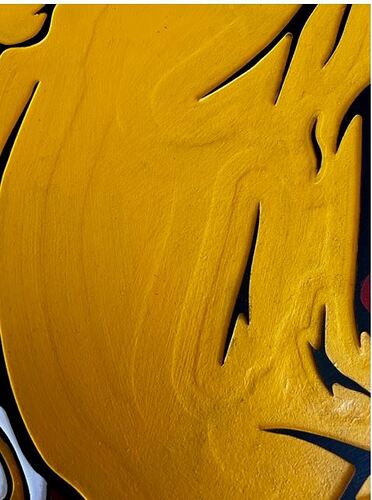

I’ve been running my machine for over a year now and have never had this issue. I’m cutting some pocket tool paths on an image and it’s cutting at different depths throughout the path…I notice when I highlight my toolpath it indicates the depth is not consistent throughout the image. Is this a corruption in the image? Is there a way to edit these inconsistencies out?
Post the file and a photo of an attempt at cutting?
Ferris Bulldog cut 2(2).c2d (1.2 MB)
This is a very large part — how are you securing it?
Were you using upcut or downcut tooling?
Which Z-axis does your machine have?
secured with carbide’s clamps…downcut 1/8" endmill and I’m running the pro.
I’m using 1/2" mdf material

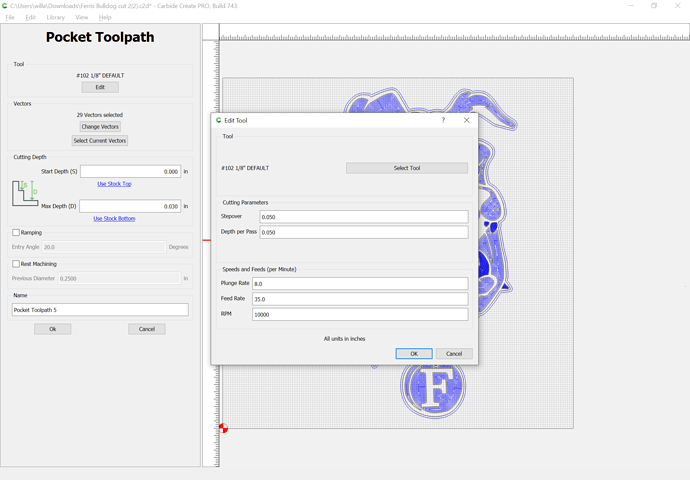

I would suggest using feeds and speeds optimized for your tool (you are using 1/8" DEFAULT) and you have your depth per pass set to take a single pass:
Reducing that to less than the depth of cut will allow a second pass, and if you set the depth appropriately, you can set the second pass to be a finishing pass.
