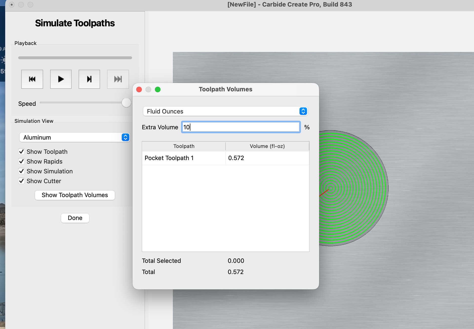

Random thought this morning as I nearly missed on my expoy estimation: could Carbide Create measure the fluid ounces of a pocket toolpath?
It does in CC Pro when you select the Show Volumes button on the Simulation screen.
Thanks for this question and answer. I never figured out what was the meaning of this
Thanks Ed!
Just got pro and I’m still learning.
I didn’t know what the show toolpath volumes was for but now that you pointed it out it makes perfect sense. Could be an epoxy saver :laughing:
