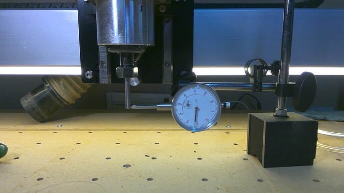

Do you have a dial indicator, and a solid (dowel) bit? You could check for runout at the tip, that could produce oversize holes.

I have a dial indicator but not familiar with the rest of your suggestion

When I rotate by hand, I get about 0.008 difference all the way around. That with using the precision collets. The dowel is the one that came with the bitsetter BitZero.
If you don’t have a dowel, you could measure a bit just above the flutes. That won’t tell you how much the tip is moving, bit it will give you an idea of how much movement there is. On my machine I get about 0.003 just below the collet, so that measurement would not be affected much by any deficiencies in the dowel.
