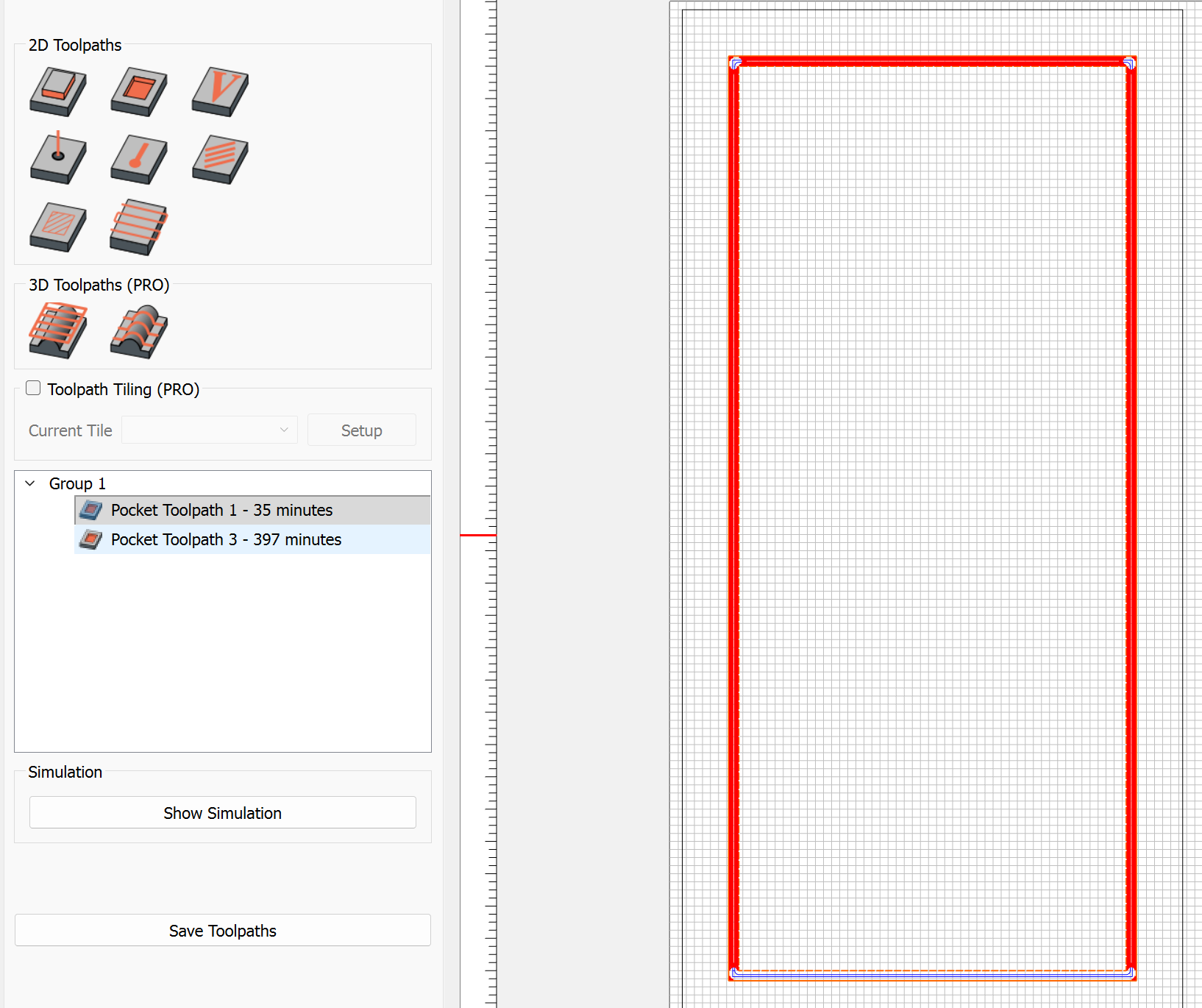

I’m a little confused…I thought I’ve done this before, but for some reason, it’s not doing what I expect.

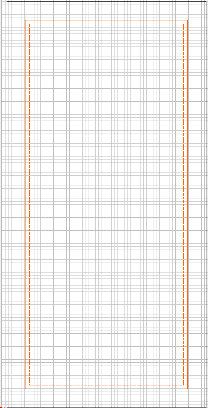

The setup couldn’t be simpler…I want to route a rectangular 1/2" deep groove in a board between the two rectangular lines:
The gap between the lines is 5/16"

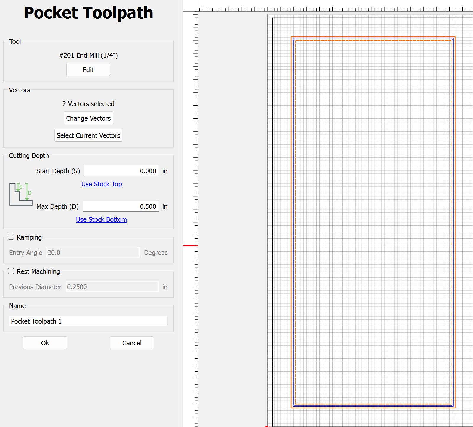

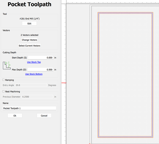

I cut the initial pass with a 1/4" 201…

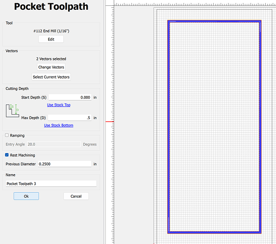

Now I’d like to clean up the corners with a 1/16" bit to get them a bit more square…

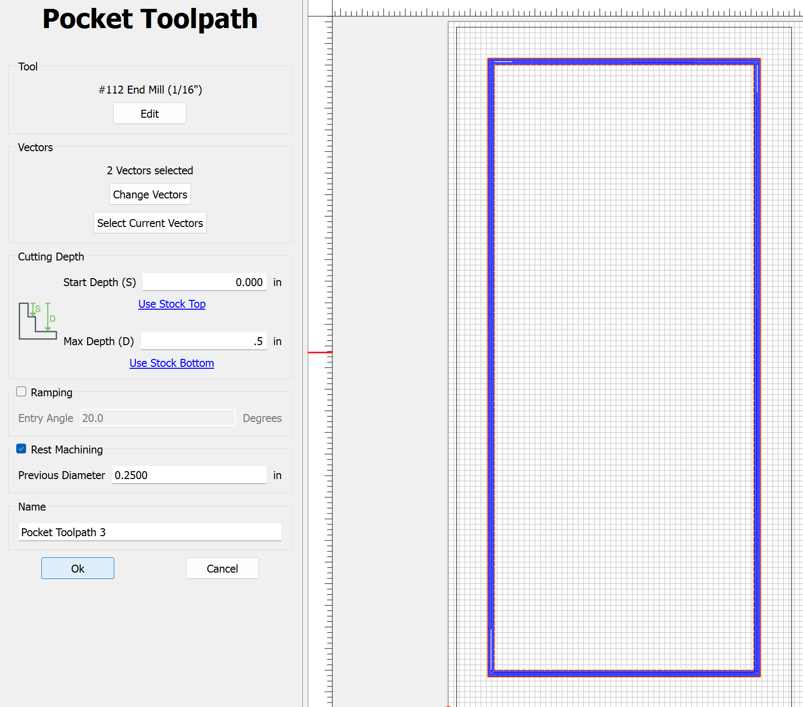

SO I put down another pocket path and choose Rest machining, and put in .25 diameter as my previous bit:
As you can see, it’s running the 1/16 bit through the entire pocket…paying no attention to what was cleaned out by the 1/4 bit. The resulting toolpath is showing up to take 397 minutes!
Something is not right, right? Shouldn’t I just get the little corner cuts to remove the parts of the groove the 1/4 can’t reach on its two passes??? What am I missing?
Bug or am I a dope?

[EDIT] I know how to fix the problem…I just have to exclude the inner rectangle on the second toolpath … then it does exactly what I would expect it to do…but that leans me towards bug…because it really shouldn’t be any different.

I put in two toolpaths…one selecting the inner and outer, one selecting only the outer.

I tried your file, and it looks like we broke it, if I’m looking at it correctly. We’ll get it fixed.
We went through your files and found (it seems) a mistake in our code that caused the rest calculation to fail when the pocket areas were barely larger than the first cutter.
It seems to work for both of your files now, so that will be available in the next release.
