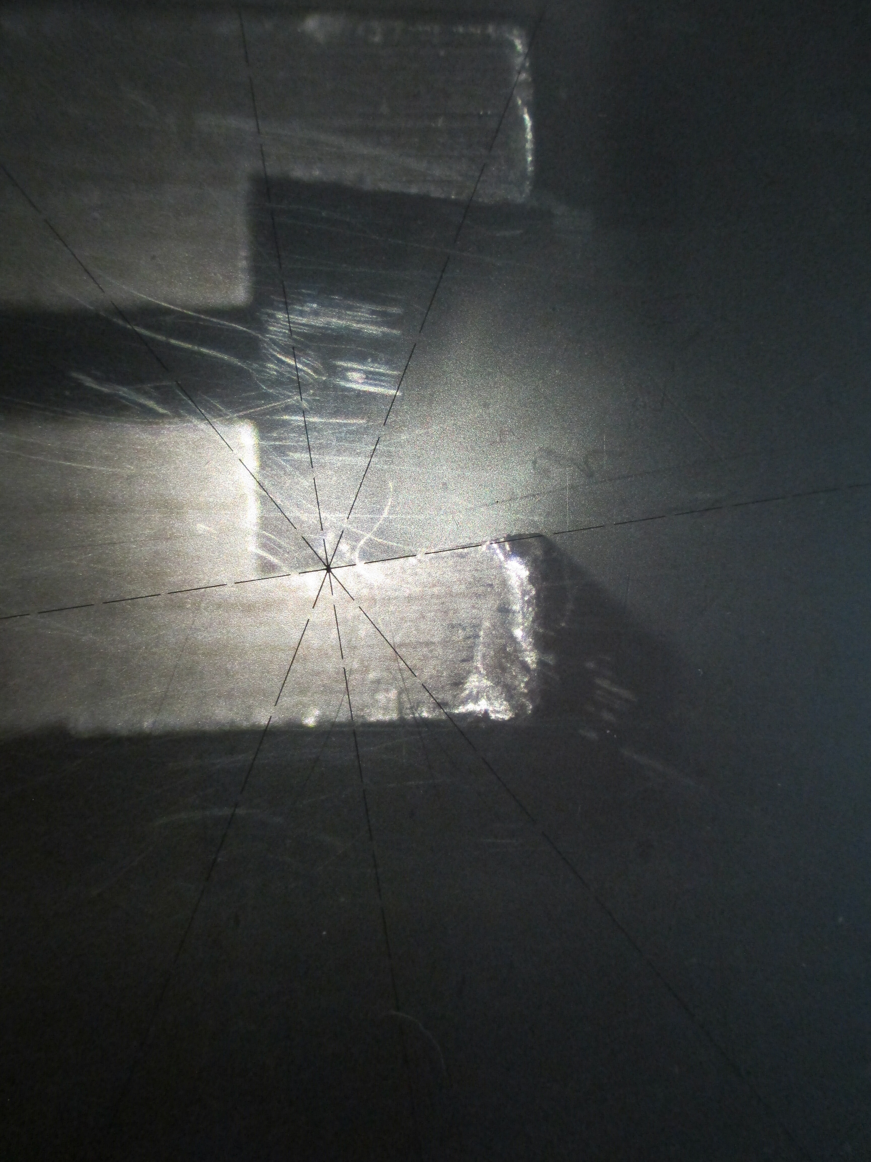

Where the comparator shines (pun intended) is profile projection (shadow-graph is another term). The illumination is axial, telecentric, and directly toward the objective lens. The head at the top here provides illumination and the profile of the part is very clear. Telecentric illumination means that the principal rays are all parallel. For illumination purposes, this gives clean edges with (little) glare from light reflected from surfaces making it to the objective. It also requires a lot less power, since the light is direct, not reflected:
This dovetail is near impossible to measure any other way. Telecentric lenses are also used for imaging, as the field distance doesn’t affect the size of the image. Transits and surveying levels use telecentric optics, generally. Compare that (again, pun intended) to the same part using surface illumination:
In this case, it is tough to locate the plane of the dovetail exactly, due to the imperfect edges. The other end was worse.

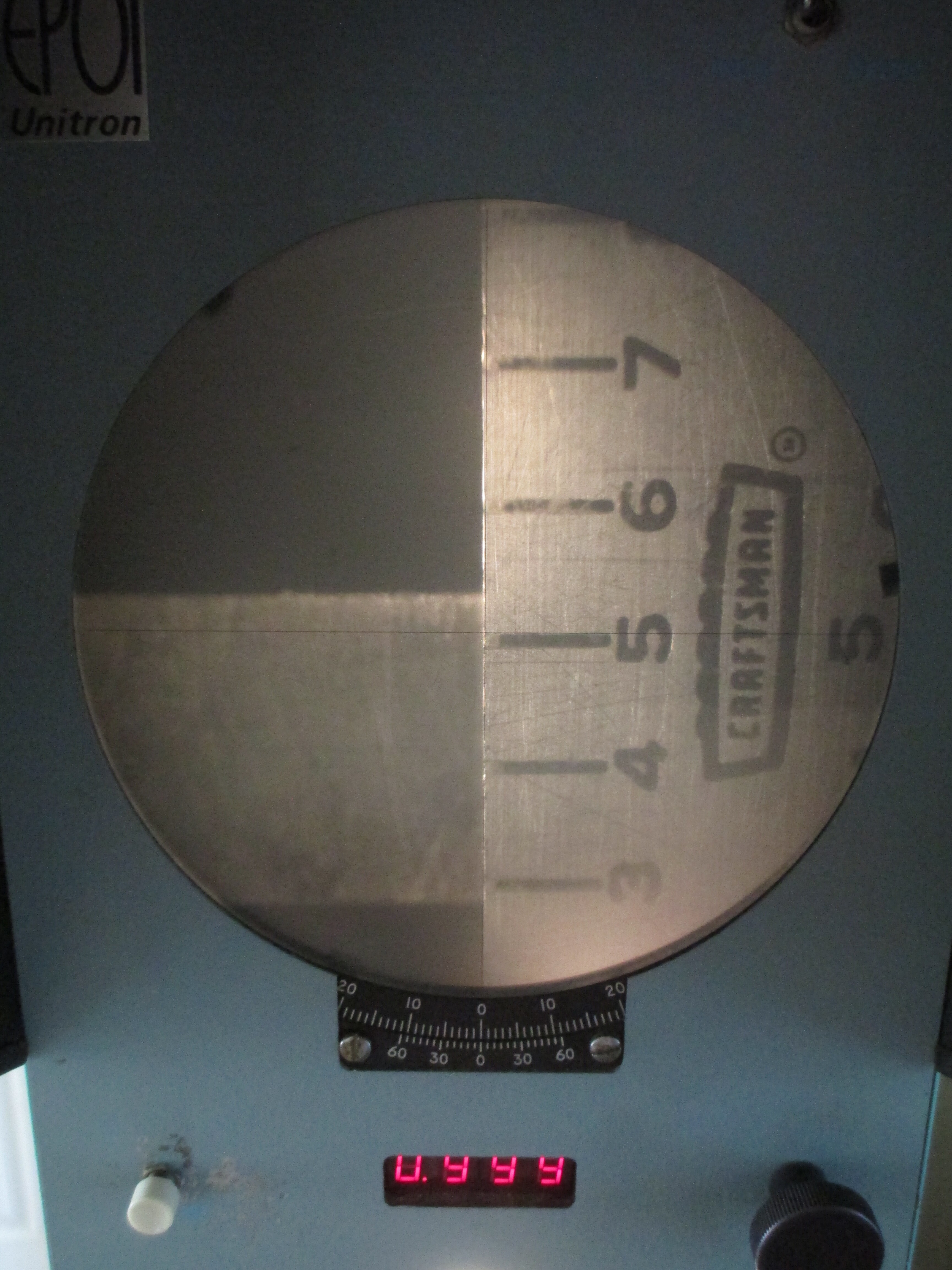

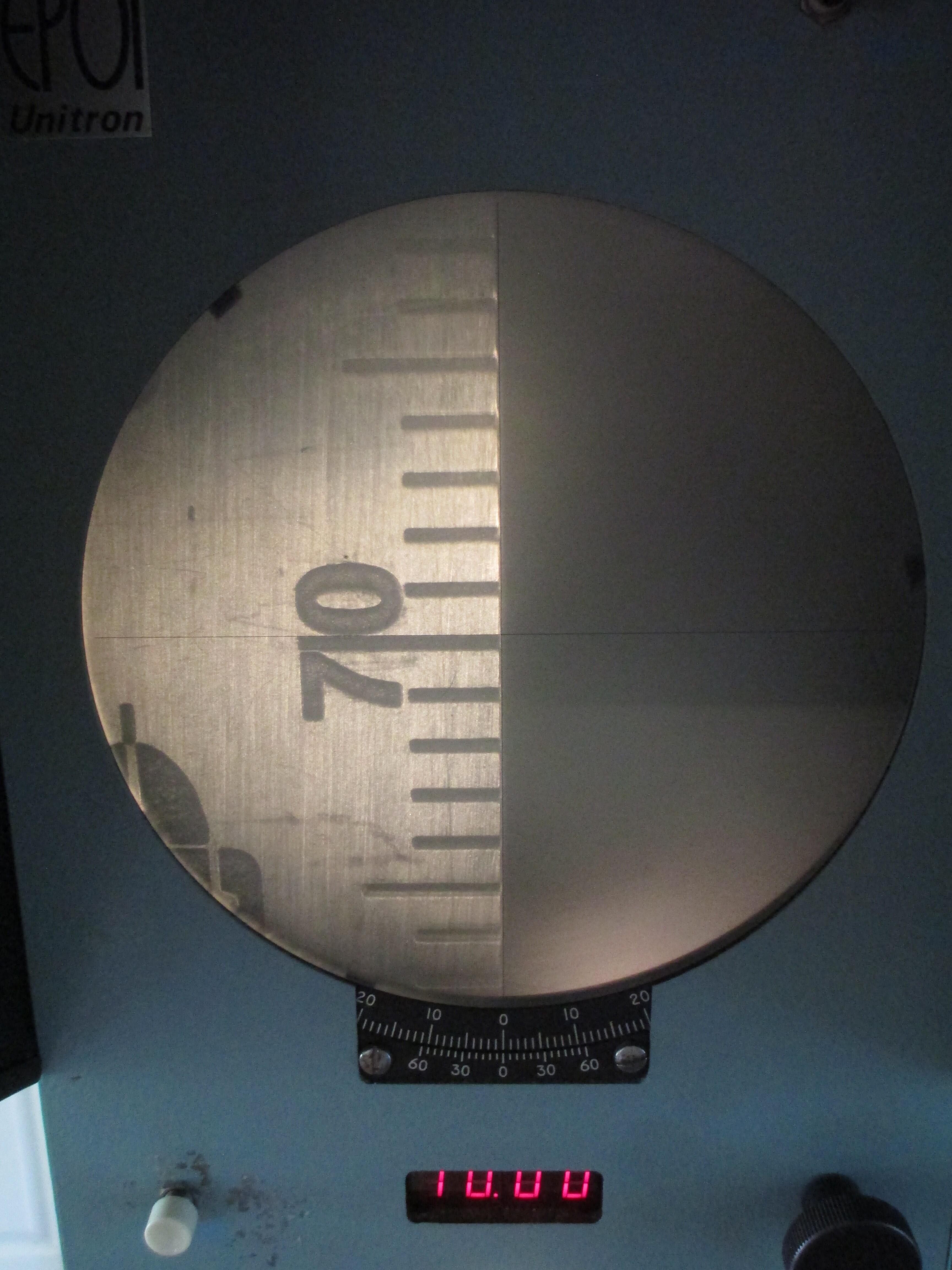

Here is the funny thing. The shots below make it look like the digital unit is off a little. It isn’t.
Metric:
To measure, line the crosshair with the feature of interest, set zero, move to the next feature, and read the display (or the micrometer head). The edges, location, and width of the marks on the scales have more variation than the resolution of the reader. This also illustrates why the part I put in the contest was needed. Gotta be able to a) get the part in focus, so I made a variety of risers, and b) gotta be able to adjust the angle of the part to line up with the axis travel (I aligned the screen during reassembly so the angle vernier is a match) This is pretty much the case for any comparator, including modern digital imaging units. Horizontal types are easier for many things, since the table and fixturing give you one or both axes once the machine is aligned.
The little white button next to the display sets zero, like on a digital caliper.
Color of the lettering is so close to the color of the paint as to be unreadable in practice. MUCH more contrast here since the camera did contract and color balance. For the unit select switch (top right) you kind of just need to know.
