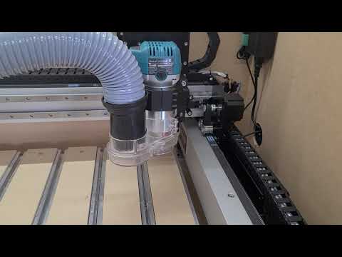

Hi folks,
I would like you to view a short 15 second video on my Youtube of the homing procedure and tell me if it’s normal. When it goes into the back right corner it runs into it a bit hard and I’m wondering if everyones does this? Everything works fine on the machine, so not sure if this is a problem.
Thanks
Jeff

Hi @MakerJeff,
This is the normal sound, it’s not straining the steppers it’s just part of the homing sequence: first the gantry moves “fast” to the right/back until the switches trigger a first time, they it quickly pulls off the switches by a small distance, then goes towards the switches again but at a very slow pace this time (hence the different sound), and finally it pulls off the switches

Just watch it closely as you don’t want it to contact those stops even a bit. If there’s a gap, you’re good. If not, I think you can adjust the proximity switch a small amount to the left.
