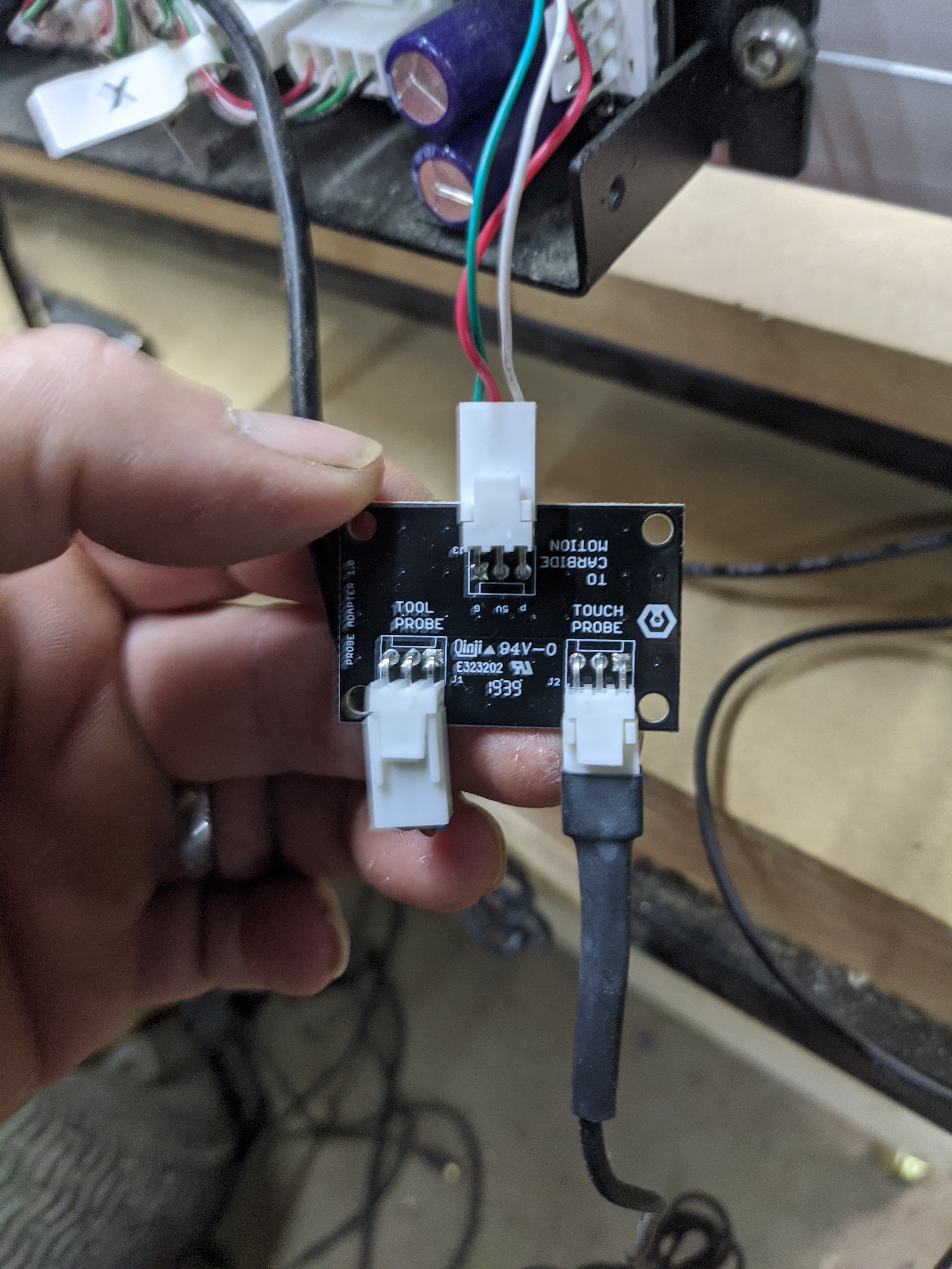

I’ve run both on two separate machines without issues. One thing to think about is that they both run on the same circuit and a probe connection will trigger the bitsetter as well.

Left-field issue to at least keep an eye out; I’ve had issues when the aligator clip for the BitZero got stored with the BitZero while touching the BitZero (woops)… the BitZero and BitSetter share a port and this short caused the BitSetter to not operate well

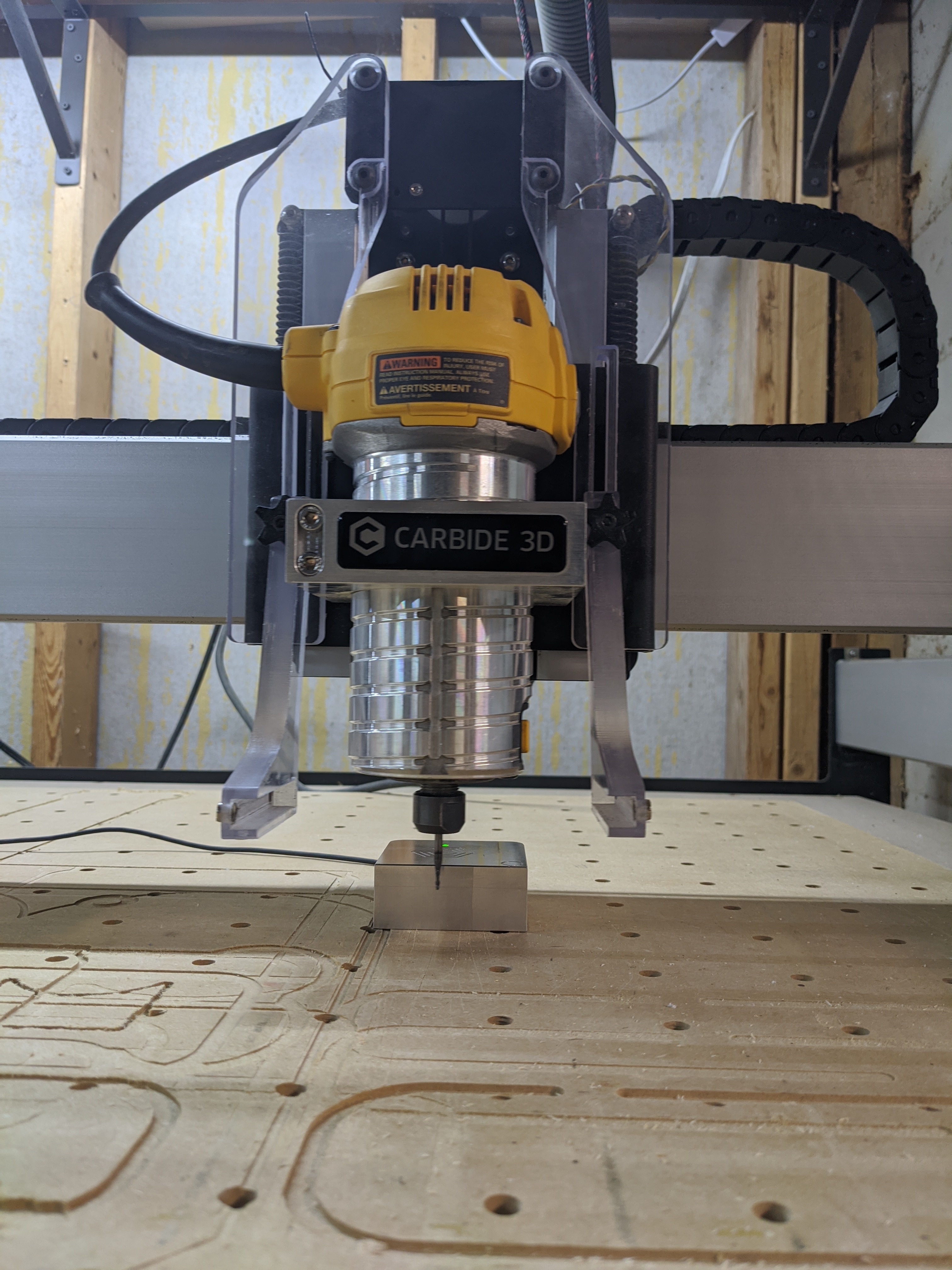

Turn on computer, startup carbide motion, connect to cutter, initialize machine, tool change required prompt, click resume, move carriage to desired position, use probe to set zeros all three, open carbide create, open project, click send to carbide motion button, click start job, click start, tool change required prompt, insert tool click resume, click resume after tool goes to bitsetter. at that point it begins to start the cut but as in picture the zero is off that far to high. EVERY TIME I use both tools to setup.

Your photo doesn’t actually show a part to be cut. Is this just mocked up as an example?
correct crooked the machine was zero’d to the top of the spoil board

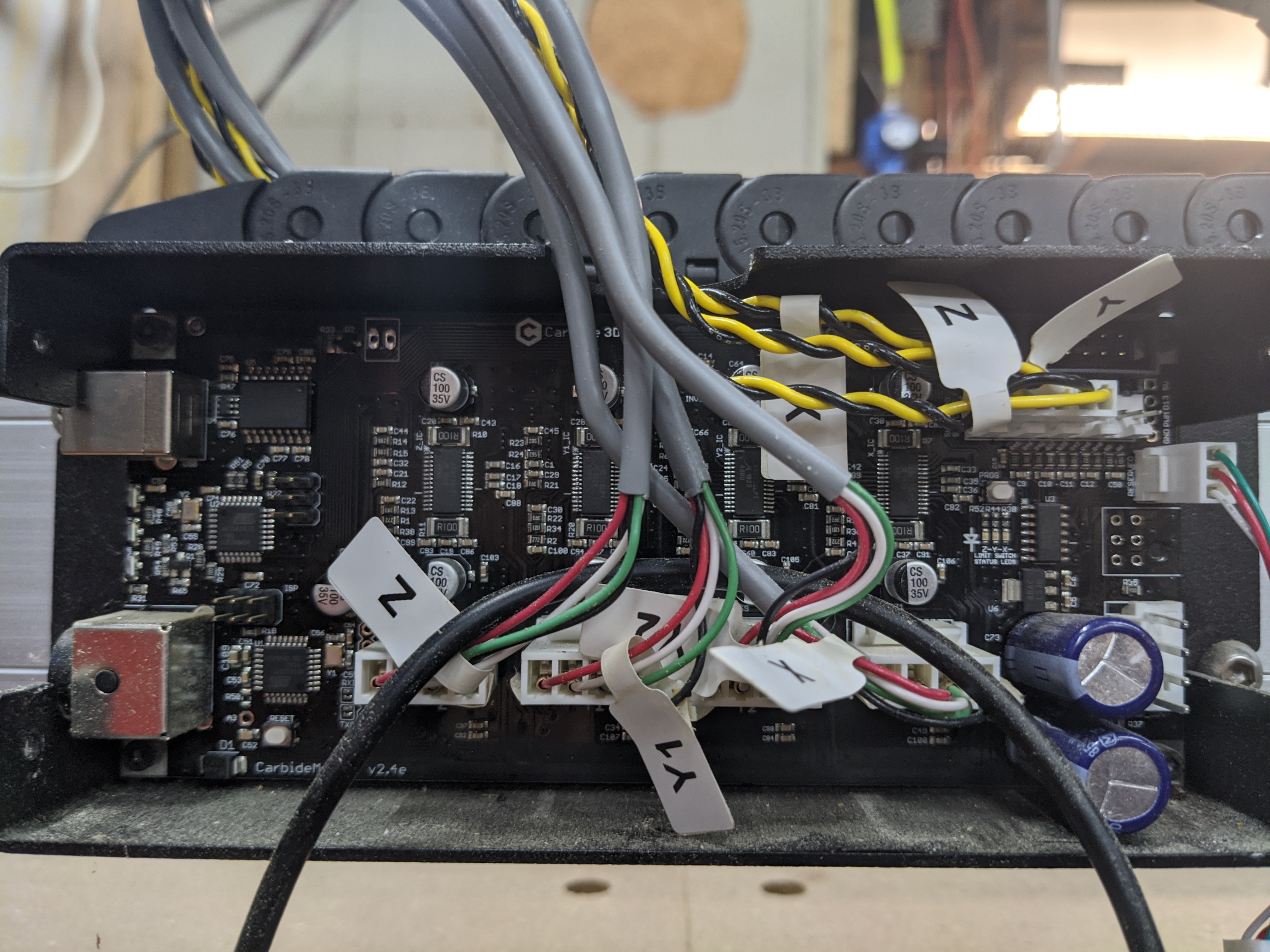

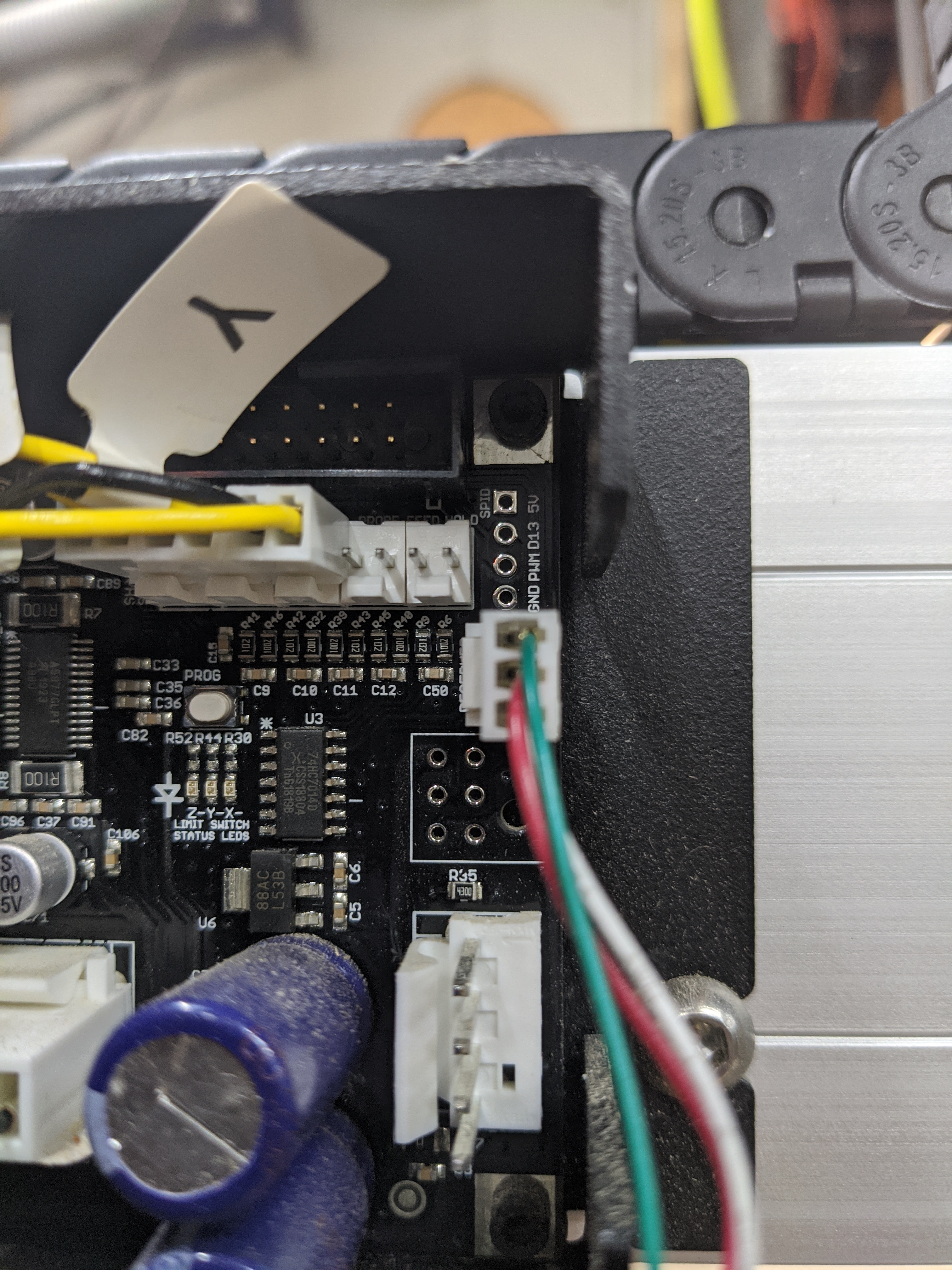

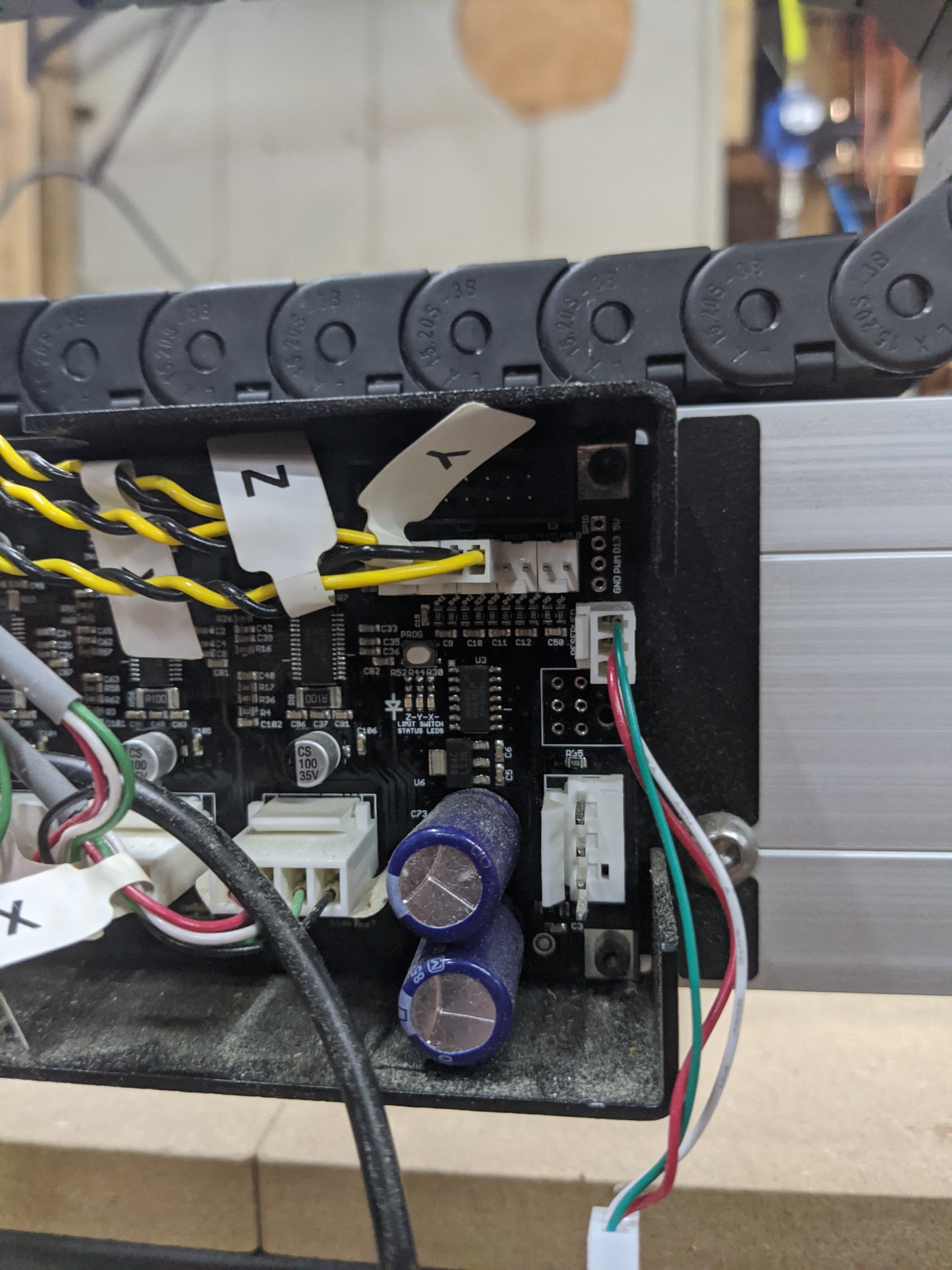

these are pictures of how its connected, the left (tool probe) is bitsetter and the right (touch probe) is touch probe
