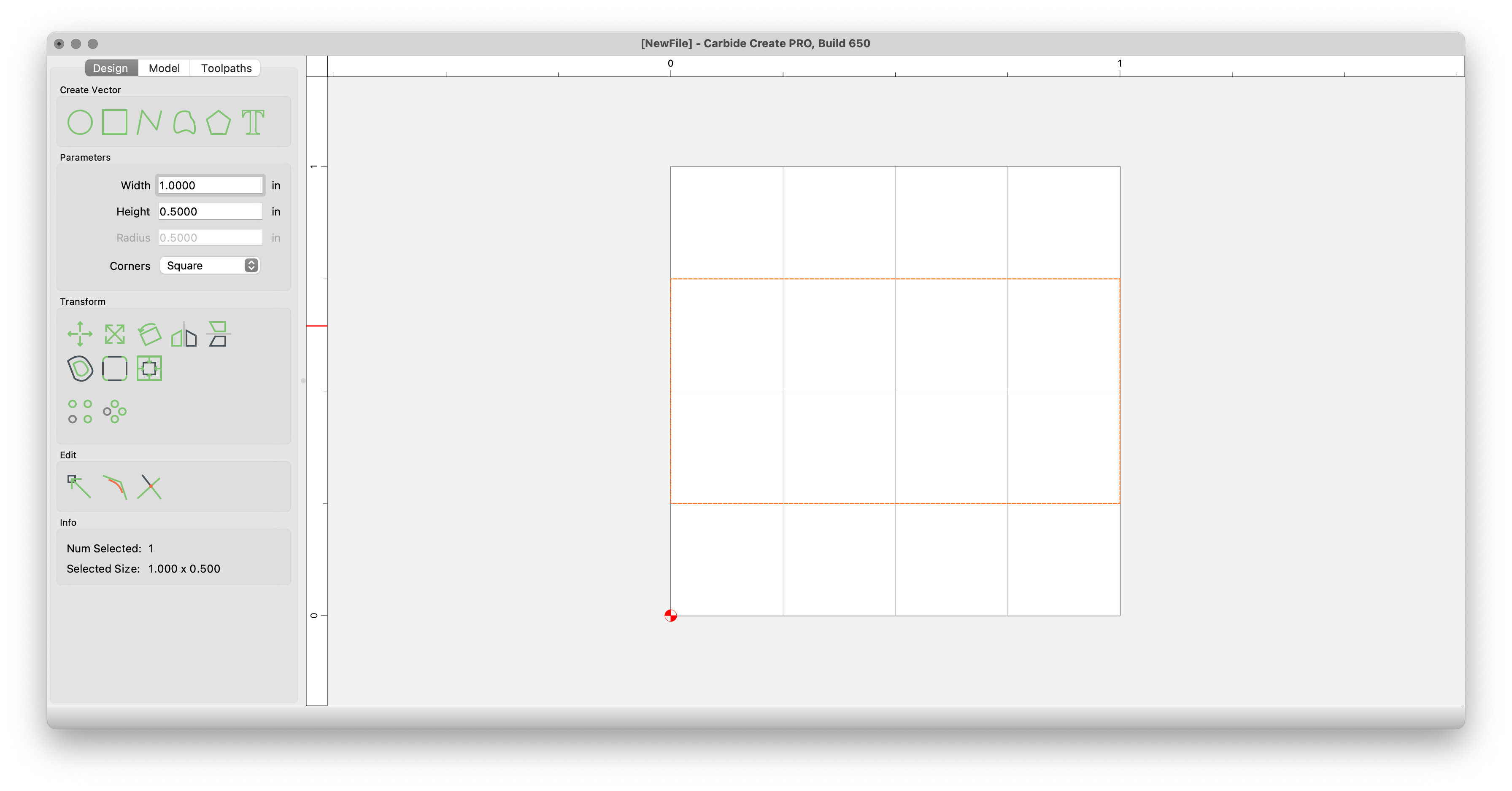

This depends on whether the object in question is a rectangle or a polyline.
If it is a native rectangle, yes:
If it is a poly line, asymmetric scaling can only be done by dragging the drag handles.
Just select the rectangle, and edit the parameters
I think I somehow selected a square, or some object other than a rectangle. But doing as you instructed, if I begin with a rectangle, I can then size exactly as I choose. Thank you.
