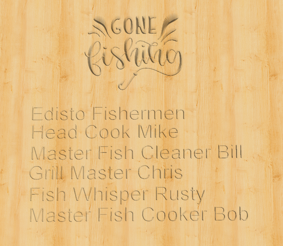

making this sign problem is designed in CC design looks good, tool path for top part using cutter 302 all is good. problem is the bottom part with names I pick cutter 201. when I do a review of it don’t see the letters. what is going on?edisto sign 10x12.c2d (1.2 MB)
You have a #201 .25" endmill selected with an inside left toolpath. The bit is too large to fit into your lettering. Thus why the tool path is empty. I don’t know your desired end result. But I would try a smaller bit. or rather just use the v bit for everything

Just added all your text to the V bit tool path and this is the result

you would have to go down to a .031" endmill for the Text and the inside left tool path you selected to get clean lines in text. .063" left alot uncut still
other option is using a V-bit
