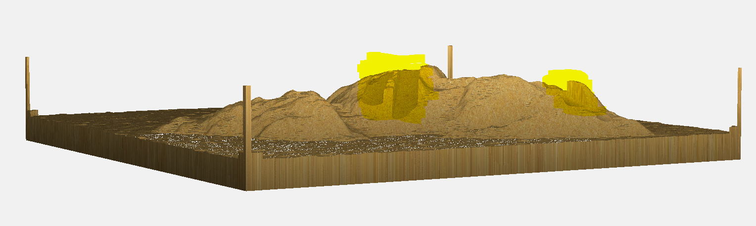

Hello,

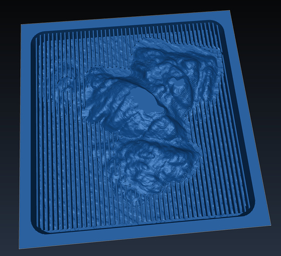

I´m having some troubles when trying to make a topological map of a island.
Can someone take a look at my file and explain why im getting these “marks” in the simulation.
I think its happening in the 3D roughing pass but i dont know why.
File: Test 2.c2d (3.5 MB)
Regards.

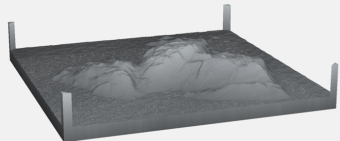

Interesting bug. Not sure what’s going on, you may want to send the file to support@carbide3d.com for investigation ?

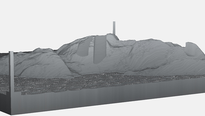

Interestingly, if you deselect “Stock” and “Bolger” components, there is still an unexpected trench (the one on the right), but the other two are not there anymore:
Not seeing those artifacts on my end, it looks good. If you’re not already on build 464, give that a try and also re-doing the roughing pass.
out of curiosity I updated to 464 (Windows) and still have it…

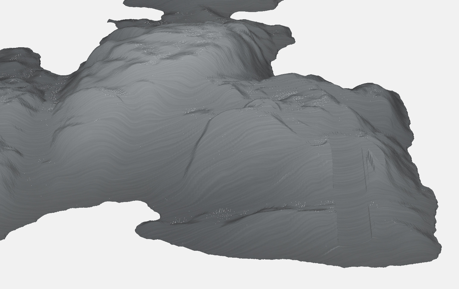

Well, the error dissapeared for me when i closed and reopened CC to post the file to the forum.
It seems that it´s a simulation error and hopefully not a actual cutting error in the G-code.
Was using 464 when creating the design.

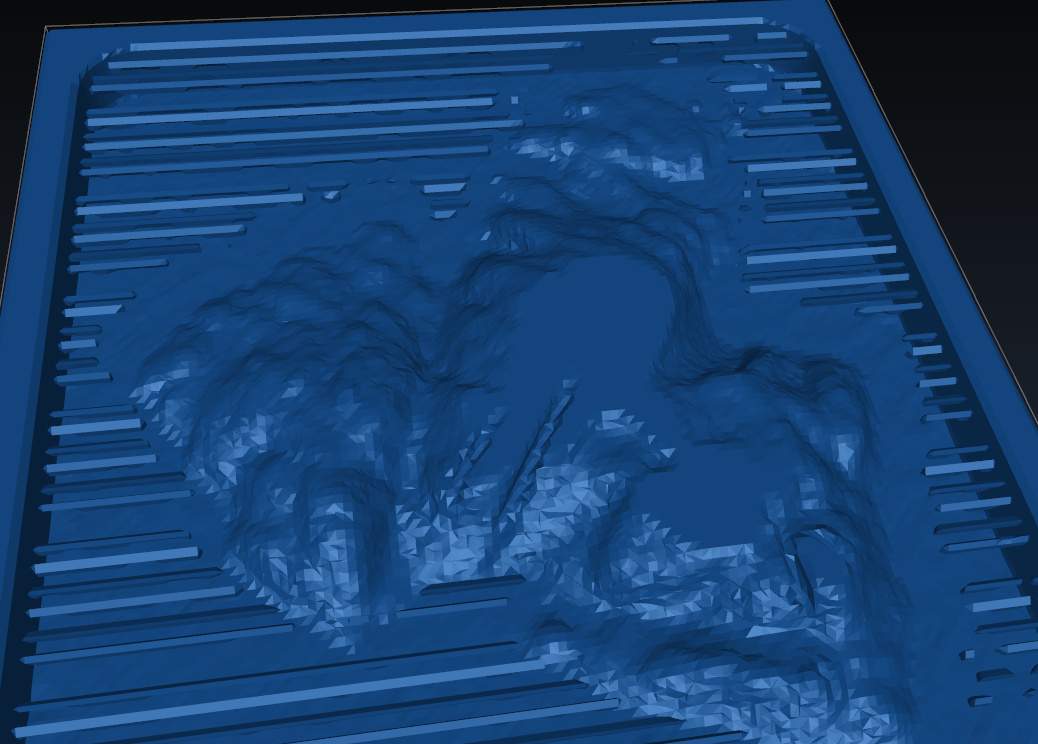

I am having the same issue. I updated to 464 yet still have the issue. I ran the tool path and the results matched the simulation.
Uluru 210x210x31.6.c2d (179.8 KB)

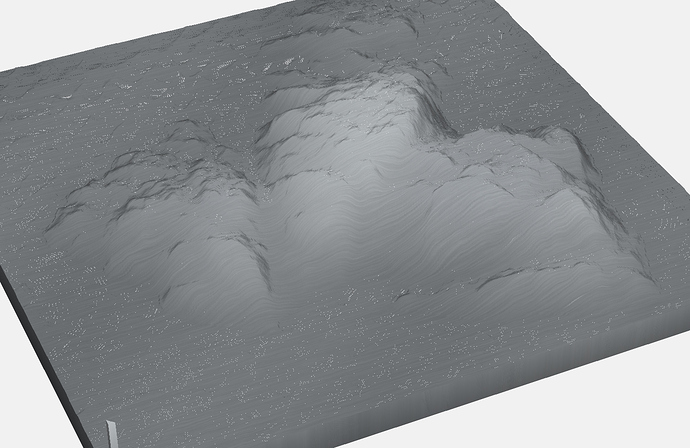

Yep, I was checking in CAMotics and confirm the G-code is bad:
Can you test this file also?
Test_G-code 2.nc (2.2 MB)
It´s the exact same file but it simulates correctly.

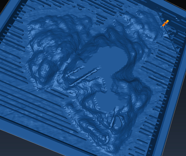

CAMotics tells me that Test_G-code 2.nc still has the issue:
I think this might be related to all of the changes we made for the new post processor. I can duplicate the problem so we’ll see what we can figure out.
Give build 466 a try at: https://carbide3d.com/carbidecreate/beta/
Will test later this evening😊
Allgood with 466 here:
Have tested it in Camotics now and it seems to be okay.
Will take make a test cut after easter, but we call it solved for now :smile:
